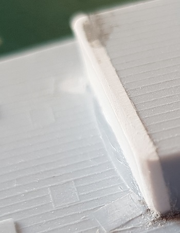

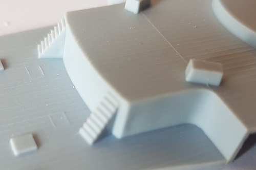

loyal to myself....I suddely saw that the rear deck structure ....lets say isn't quite right...
where the deck drop is...heller made it say rounded...in reality...it was strait.....the heller stairs are not realy what I prefer

so...lets cut and re-do

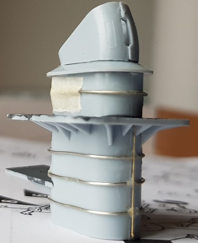

As I bought the kit ...used...they had already build the funel and all search lights, guns and mast.....and fully unpainted...so
I cut off all ...and starting to do some modifications on it
seeing the pictures....I'm even thinking of cutting off the top and re-build that part....

totally_random_man
Posts: 71
Joined: Tue Mar 05, 2013 2:31 am
Re: 1/400 Admiral Scheer Heller
Post by totally_random_man »

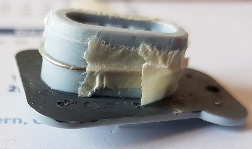

I hope I'm not too late:
For some unkown reason Heller gives that rim below the funnel cap and makes the cap in a smaller size than the rest of funnel. The real one didn't have the rim after 1941 refit and the cap was all around flush with the funnel sides:
Triumph68
Posts: 1125
Post by Triumph68 »
totally_random_man wrote:I hope I'm not too late:
No...not too late...and its a fact I hadn't payed attention to.... :thanks: , I know now what my next job is ...remove top...and re-do it
donno yet how I'm gonna make a new funnelcap though :huh:
Triumph68
Posts: 1125
Post by Triumph68 »
DavidP wrote:modify the existing funnel to get the correct shape
to big..can reduce...to small...thats something different....
thinking of cutting it on the side (where its flat) and ad a strip in between
another thing that seems to be is the front rounding of the cap...I have the impression that the original cap doesn't curve from bottom to top.
on top of all....it seems that my predessor owner of the kit...put the cap upside down....good thing he didn't do much more....amateur :Mad_6:

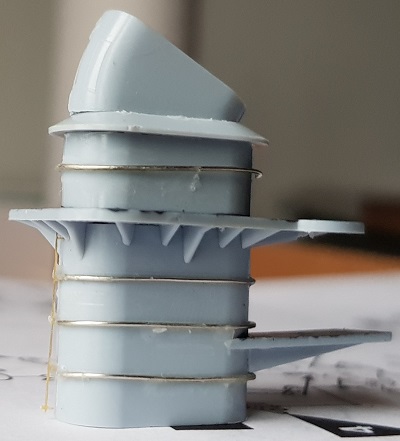

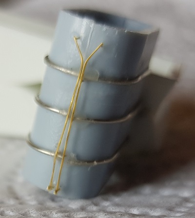

Triumph68
Posts: 1125
Post by Triumph68 »
as some parts where poorly glued...it came pretty nicely apart...giving the advantage of being able to ad some details more easely
the brass lines are actualy 1 bar of a railing I cut off from a 3 bar railing and needing only a 2 bar railing for a German sub
my advice...what ever you cut or have left over.....can always be used some where else
gonna ad also the doors on it to get to the upper level...missing in the kit

the rime is limed off....and top cut and added pieces
Triumph68
Posts: 1125
Post by Triumph68 »
all back put together....looking better...still needs filler and finishing but it gives the overall idea

Triumph68
Posts: 1125
Post by Triumph68 »
DavidP wrote:redo the cap as the backside is straight vertical & the front is not slightly curved but a straight angle from bottom front to top front of cap. open that gap at the front of cap so that the gap is same width from bottom to top & fill with a strip of plastic. what drawing(s) are you using as I have a 1944 drawing of the Scheer?
as usual...using pictures found on web and the drawing I showed on start(second post on this topic) from nov 1944
