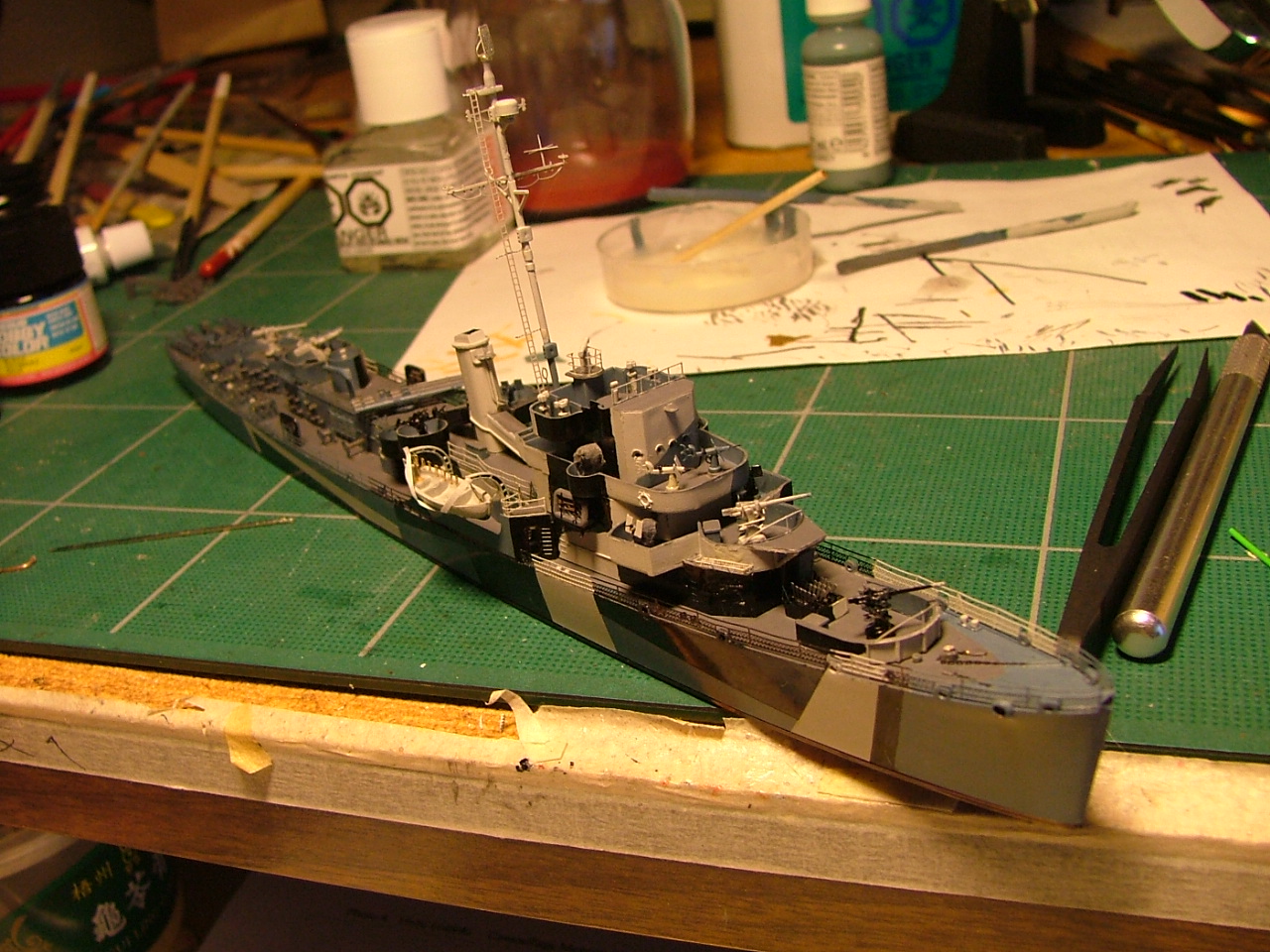

- Posts: 12444
Re: USS England DE-635 *updated June 28th*
Thanks Gordon =)
Here's a pic on the workbench as of an hour ago:
