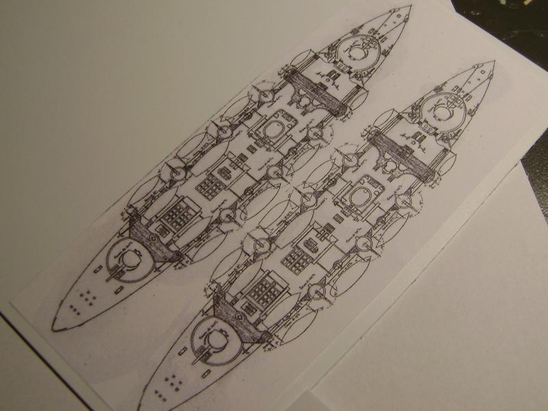

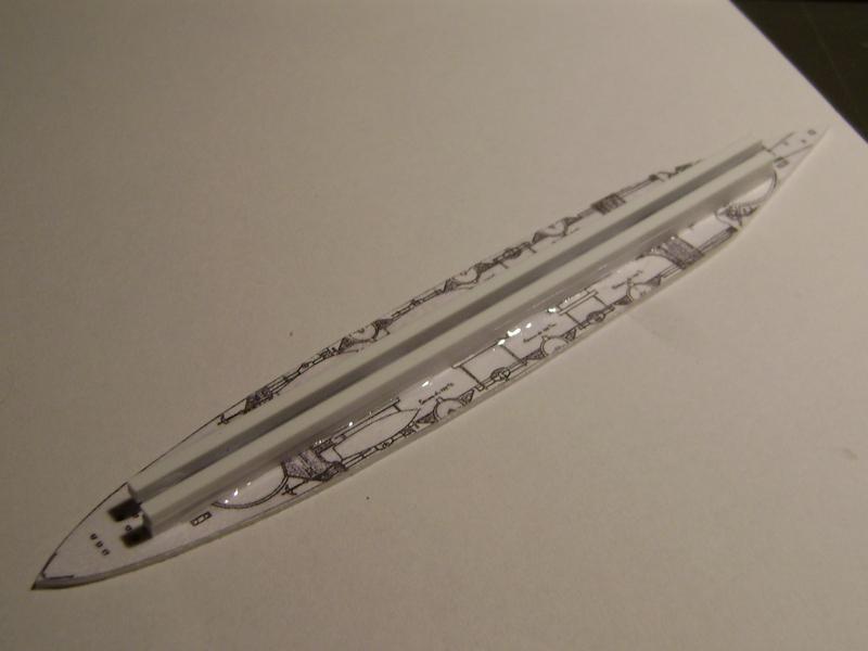

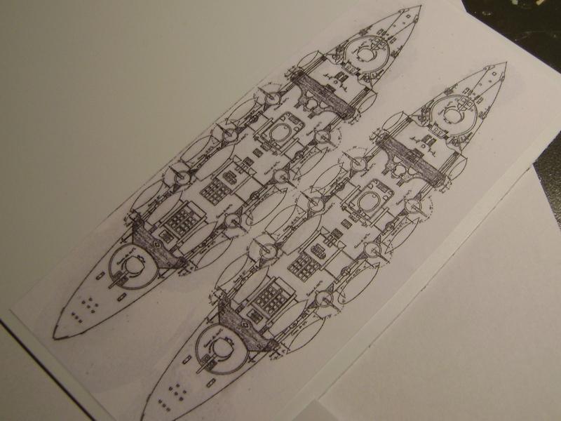

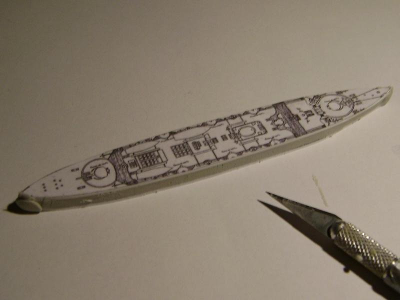

Ah, well, the Atlanta is already somewhat coming along and I don't want to cheat. Therefore I will scratchbuild the USS Charleston C-2, gun cruiser of 1887.
Let's see: get plans from the French Archives: 2 minutes
Figure out the sandwich construction, this being ridicilously easy, since there are no hull lines to speak of. Figure out correct scale, punch in printing dimensions: 2 minutes
Print out drawings, glue to 1mm evergreen: 4 minutes.
Check facebook status, mail: 2 minutes.
Cut out waterline plate, main deck: 2 minutes.
Place four strips of 2x2mm evergreen on the bottom half. Glue on top half (main deck). 2.5 minutes.
Knead the Magic Sculp: 4 minutes. Misjudge the quantity: check.
Fill the hull sandwich with magic sculp: 4 minutes.
Let it harden: one night.
Pour a glass of scotch: timeless.
