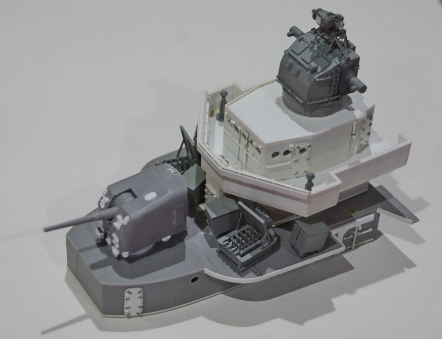

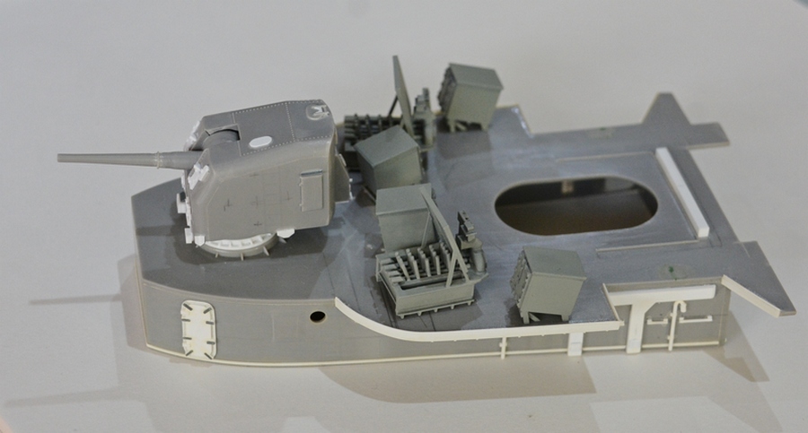

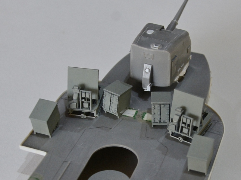

I have already completely finished the hedgehog set, with the usual three coats, a wash and a dry brush. Once set in place it fills the gap, I presume.
Along with mount nr.2 and the bridge structure, the whole lot looks cramped and cluttered, which is my distinct memory of the same place on board USS The Sullivans.
Nice going and very best regards from this side,
Willie.

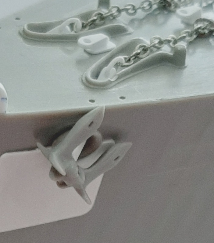

After this, I could see that the ones in the kit are good but can be improved. The flukes are OK after they have been reshaped, but the shank comes with a molded crown shackle attached to an awful looking plastic chain, so it has to be completely replaced.
The only interesting step in this first stage was to open the channel all along the shoulders, but little else. Thew shanks were carefully glued in position, so that they fit perfectly when into hawseholes. I added a crown shackle and a 10 cm. section of chain.

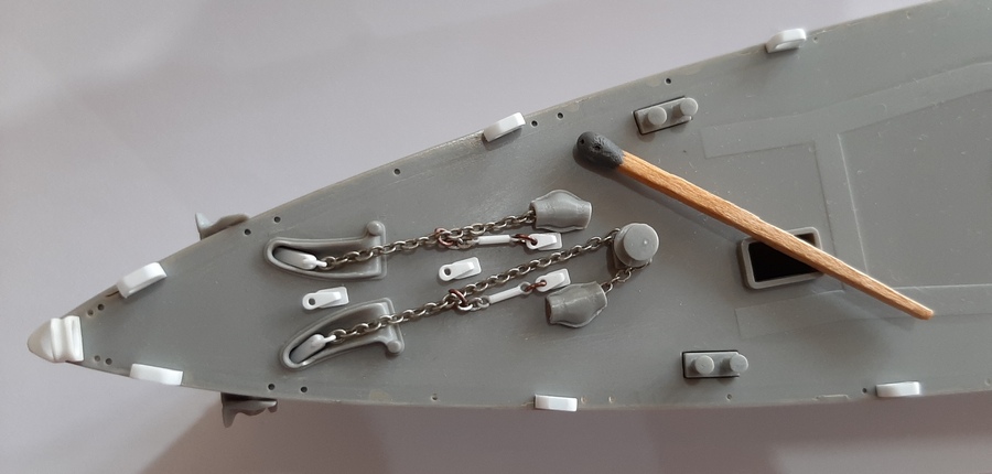

The anchors are set in place loosely, but they keep their position by sheer weight of the chain. The effect is good enough for me.
After this, the deck elements. I have no picture at all of how it was on board Jorge Juan, but I have some of other Fletchers, and all of them follow the same pattern:
The first elements were easy to build. The turnbuckles are out of scale, but I am not able to handle smaller diameter rings. I would have liked to see again the tutorial by EJFoeth in his HMS Hood thread to see how he did these elements, but the pics seem to have vanished in the air.
I completed the set with some other chain links in two diameters, and used the kit hawse covers and the winch. It is now like this:
I hope you like it, and very best regards from the North Atlantic,
Willie.

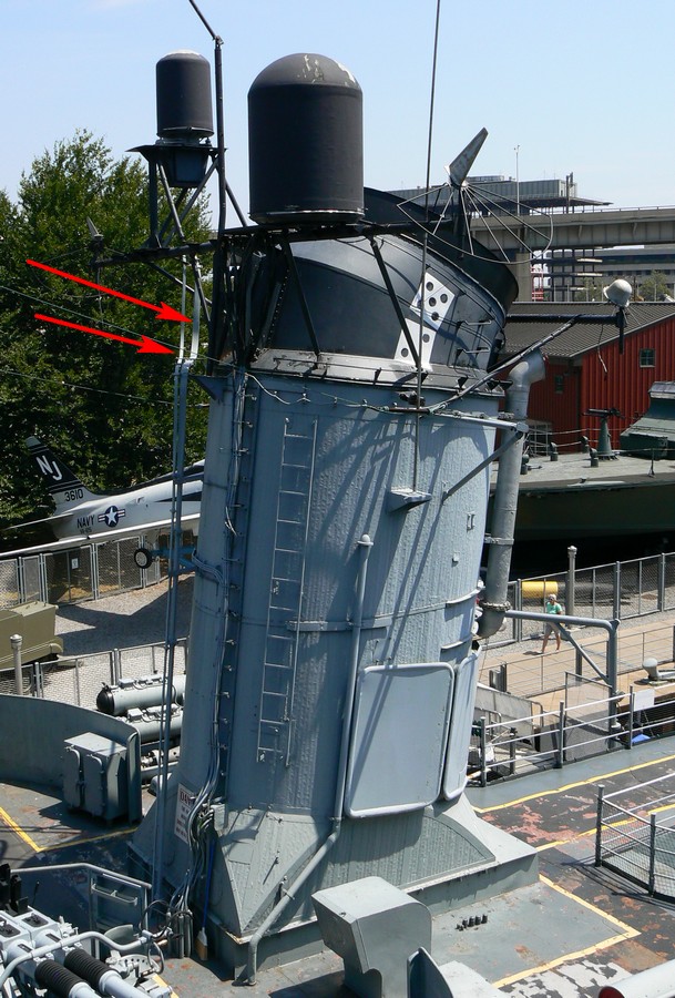

I have given another push to the rear stack, adding some more details. Firstable, the thick double wiring with two sharp curves on the left, going up from deck to the ECM domes. Apparently, as with many other elements common to all the class, there are no two ships having identical arrangements, and I have seen no clear picture of how it was on board Jorge Juan, other than it is there too. I have followed the model of USS The Sullivans, because it is common to many other units and is slightly off-side, in an ideal position to have room later to add the supports for the upper platform:
After this I tried the scale. I have one single good (but blurr) picture of how this scale was attached to the stack on Jorge Juan:
This system seems to be the common one to all Fletchers, so this solves the problem:

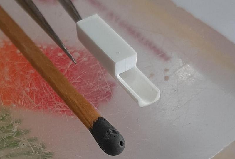

I cut the first elements from a 2.5 mm. Evergreen canal, which is exactly the width of the scale that I have.
When they are set in place with the "sides", the kind of step that follows is ideal to place the scale with absolute precision and no effort at all:
It was afterwards completed with scraps of stretched sprue.

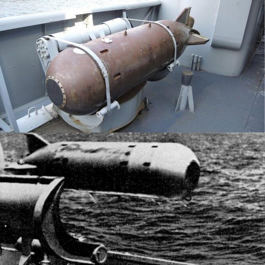

Rick E Davis wrote:
(...) The introduction of the Mk 2 ASW Torpedo launching system (TLS) (using the Mk 4 launcher as seen on USS CASSIN YOUNG) for launching "over the side" the Mk 32 torpedoes (more like a self-propelled depth charge) were installed on many destroyers. Also, there were the PMGL system installed on PacFlt FLETCHER's. The PMGL (Poor Man's Gravity Launcher :big_grin: ) was a fantail drop rail device designed by a yard crew in Japan when the PacFlt was frustrated that they had Mk 32 torpedoes, but that it would take like two years to get the Mk 2 TLS installed on all their destroyers. The Mk 4 launchers were installed in multiple locations on destroyers. The PMGL system was installed mostly parallel to the starboard side 600-lb depth charge drop track and the reload rack was moved forward of the drop track. However, a few destroyers had the PMGL installed on the portside!!
Mr. Davis, I presume you are talking of this, the Mk.32 ASW TLS on board USS Cassin Young:
I had no idea what it was, but now the thing is clear, so thanks a lot for the precious information. I will have to see if my ship had this thing on board or not in the mid. 1960´s. What I have not been able to trace is the PMGL. Have you got any picture showing this ???

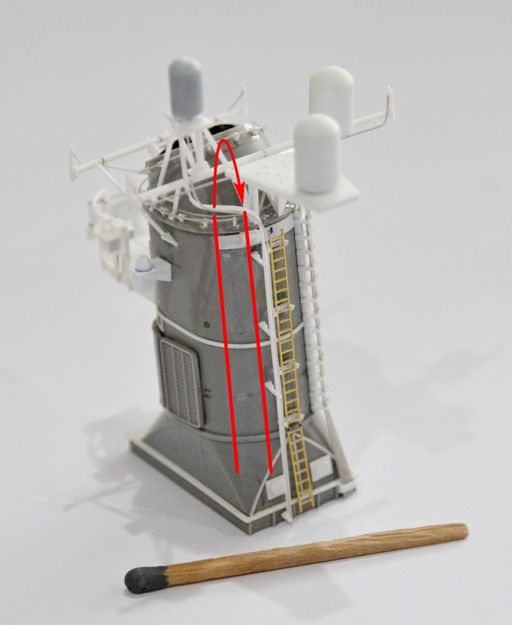

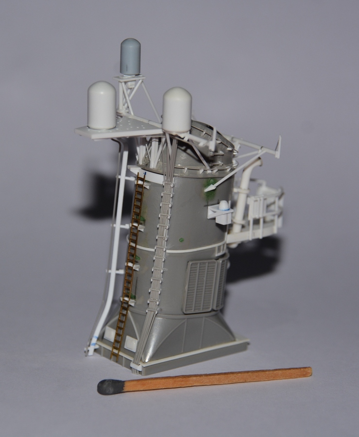

Other than this, I realized some days ago that the vertical wiring trunk on the rear stack is off-side on board USS The Sullivans, but virtually centerline on Jorge Juan. This picture shows in a somehow blurr way where it actually was, but shows clearly where it was not.
Obviously I had to delete all the previous work, and re-do the bloody thing. This has happened to me so many times with this ship that I have the impression that I have virtually built two ships instead of one. At the same time, I have almost made a master at coarse language and rough words in four different languages --no mean feat.
The good thing is that --as it is now ca. 4.0 mm closer to the center-- the wiring can be taken straight to the deck, the way it actually was on board USS The Sullivans, and the most logical one, I presume.
When compared with the older way, it looks now much better as well, I would say.

And a new question for all of you guys. What are the holes on the anchor flukes for ? I have been researching the subject in the internet, but I have found nothing reg. this subject.
As far as I can remember I have seen them only in US Navy anchors, but I could be wrong.
TIA for your time and help, and very best regards from this side,
Willie.
