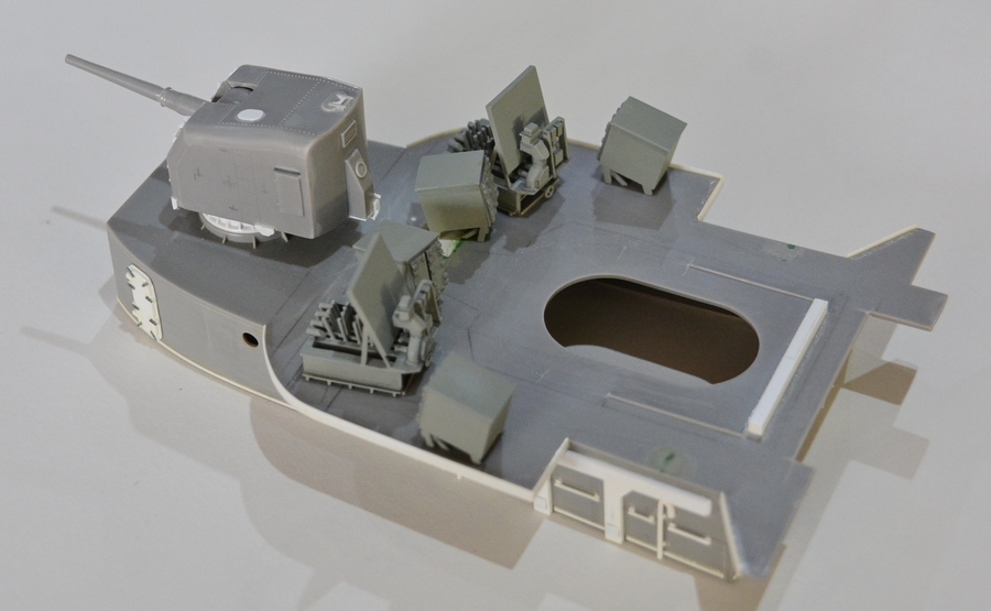

I have already completely finished the hedgehog set, with the usual three coats, a wash and a dry brush. Once set in place it fills the gap, I presume.
Along with mount nr.2 and the bridge structure, the whole lot looks cramped and cluttered, which is my distinct memory of the same place on board USS The Sullivans.
Nice going and very best regards from this side,
