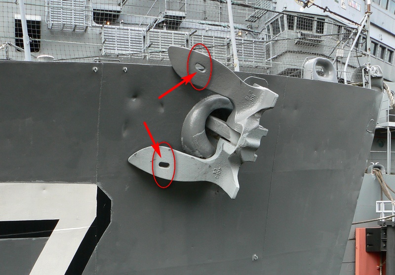

And a new question for all of you guys. What are the holes on the anchor flukes for ? I have been researching the subject in the internet, but I have found nothing reg. this subject.
As far as I can remember I have seen them only in US Navy anchors, but I could be wrong.
TIA for your time and help, and very best regards from this side,
