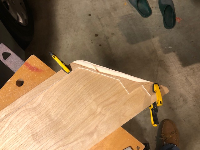

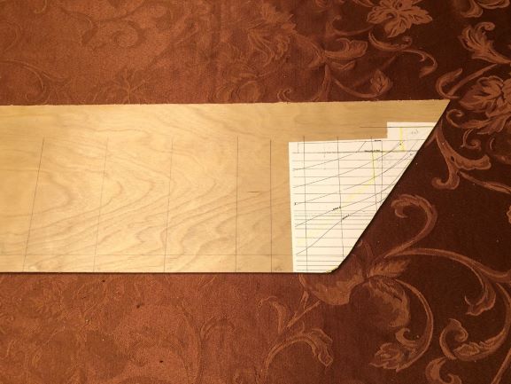

For the keel I used the profile on the Sheer Plan portion of the Lines Plan (after first comparing it with my GA plan to make sure that both absolutely agree.) I also reduced the dimensions of the keel shape to account for the thickness of planking and coating. The keel will be � inch deep, except for an aft portion which is slightly smaller to provide clearance for the stuffing tube.
The majority of the keel is a straight run and could be drawn directly onto the � inch plywood. I also marked the frame stations on the plywood before cutting. The bow and stern portions of the modified keel plan were copied onto heavy paper and glued at the proper place on the plywood, resulting in a single-piece keel.
Plywood marked for keel and initial cuts made
The bow and stern parts were cut to shape by hand with a coping saw, as I was afraid that I would have difficulty maintaining fine control over the whole piece (six feet long) while trying to cut the curves with the scroll saw. I later sanded it to final shape.
Bow portion of rough-cut keel
Stern portion-rough cut keel.
After cutting the �shaped� parts (bow and stern), I then cut the long, straight run of the remainder of the keel�this part with a band saw. I also left tabs on the bow and stern section for the hull to rest on when flipped for planking.
The stern is somewhat different from a �normal� ship in that there will be a large opening (the stern ramp) where a centerline stern post/keel would normally be. I left a temporary piece here that will hold the after-most (transom) frame at the proper angle while it is being glued. This piece will be cut off once the hull is fully framed. As with the frames, the after part of the keel was cut down a bit to provide clear room for the main deck cargo space aft.

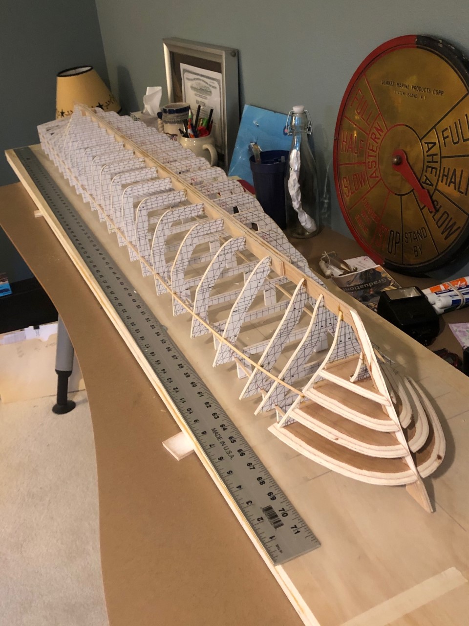

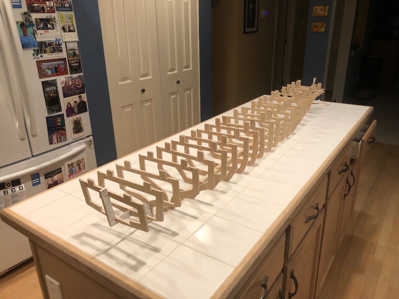

Notches were marked and cut at the appropriate places on the keel for the frames-most of them with a band saw, a few with a scroll saw. It may not be apparent, but the notches are placed slightly differently forward and aft. The intention was to have the relevant hull line shape exactly at the frame station location on the keel, with the � inch thickness of the frame on the side of the frame station where the next frame is a larger shape. So the notches towards the bow are cut aft of the frame station, and notches towards the stern are cut forward of the frame station. I hope that explanation is understandable-the idea is to make the shape as true as I can.
Once I was happy with the keel and frame shapes, and all notches were cut and sanded, I decided to test-fit all of the frames onto the keel. What a great feeling! I have had this hull shape generally in my mind for some time, based on the hull lines first, then the frame shapes and the keel shape. But actually seeing the hull shape in full for the first time, even if only roughly placed, was a thrill.
Rough hull--stern view
Rough hull-bow view
Rough hull-bow view

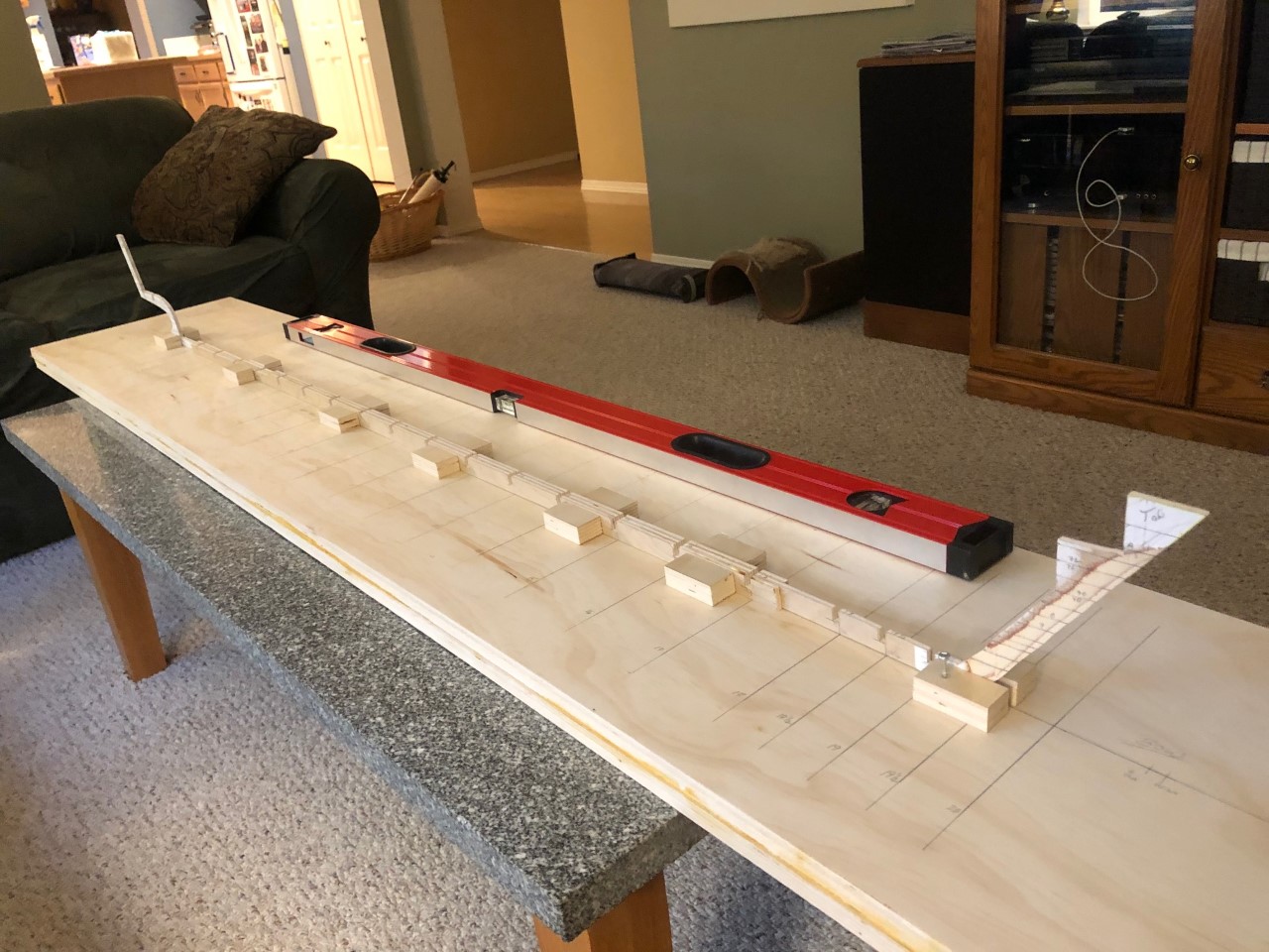

I then mounted the keel to the building board. As described earlier, the board had been marked with a keel line and the frame stations. As hoped, this turned out to be very helpful in keeping everything straight and true. First I put down wax paper so I would not accidently glue the whole ship to the building board. I cut scrap plywood "keel blocks" and test fit them and the keel on the building board.
Keel block test
Keel block test
I then clamped the wide part of the keel to a long level to ensure straightness and then used 1-2-3 blocks lined up on the centerline to keep the narrow parts of the keel (extreme bow and stern) as straight as I could make them. I then screwed the keel blocks along the keel to hold it in place, removed the level, and then screwed another set on the side where the level had been. Everything seems straight and held securely.
I test fit all the frames with the keel attached to the building board and just like that, it was time to start gluing frames on to the keel. I started with the mid-body as those frames are the simplest shapes, and the broad, flat bottom of the frames will help keep everything level relative to the building board. I will work my way to the bow and stern, gluing the flat-bottomed frames first before getting to the finer shapes. I had thought of and test-tried various methods to hold the frames square to the keel and securely in place as the glue dried and settled on using four 1-2-3 blocks. It was the simplest method I tried and by far the best-and wood glue does not adhere to the blocks, either.
Here�s the first one-Frame 12.
First Frame glued to the keel.

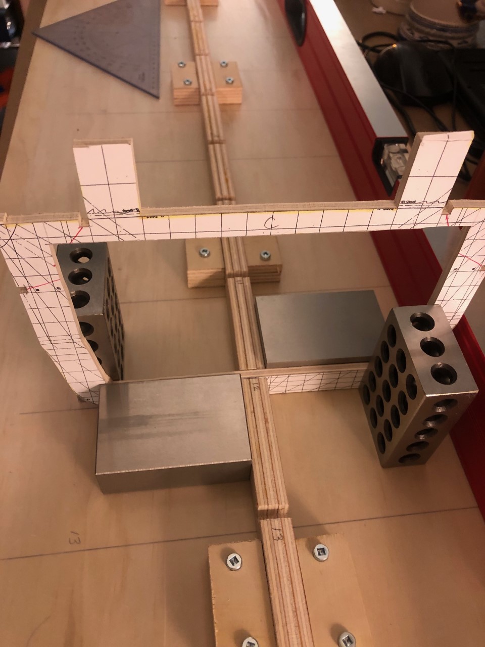

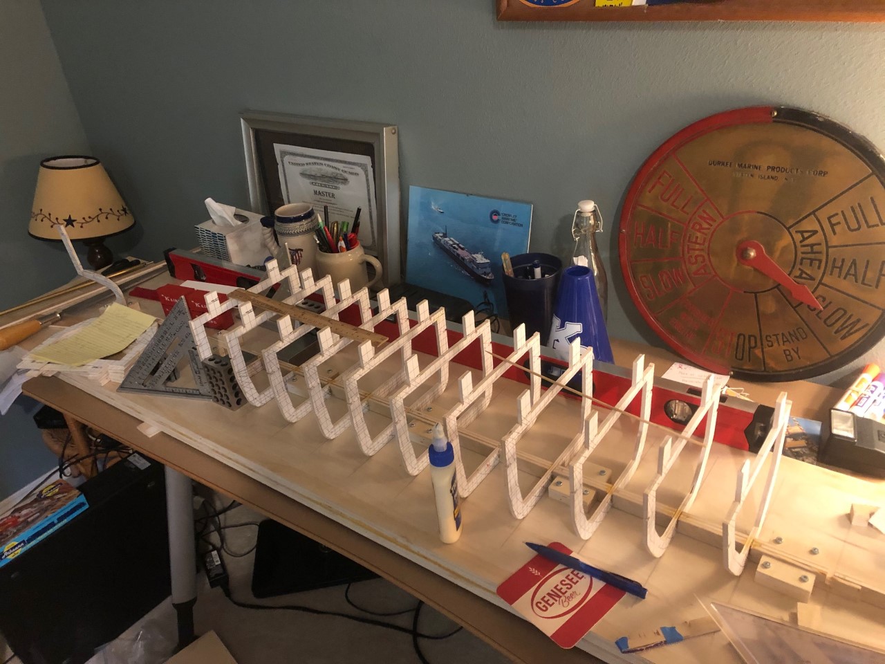

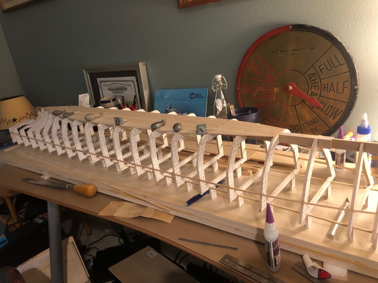

I added 2-3 frames per day, allowing plenty of time for the wood glue to set, starting forward from frame 12 and then working aft, leaving the trickier frames at the extreme bow and stern for later.
I used a quick square (or two) in addition to the 1-2-3 blocks on occasion to make sure that the frames were perpendicular to the board. This became more important as the bottom of the frames got skinnier/rounder towards the bow and stern and I could not rely on the flat bottom shape to keep those frames lined up properly. I also used a plumb bob while setting the first few frames to ensure that the centerline of the top of the frames matched the centerline of the keel. After a few frames were glued I could check this more quickly by laying a straightedge along the upper centerline marks on the frames.
Mid-body frames in progress
After fifteen frames I had run through the �easy� ones, with only one that dried mis-aligned and had to be cut out and glued again.

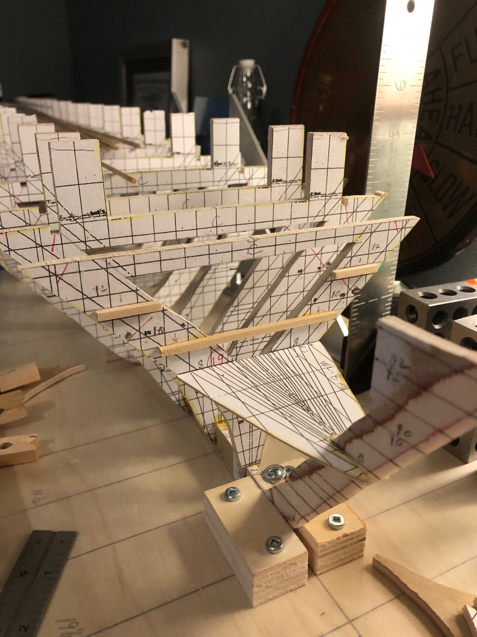

The frames near the bow posed similar challenges, as they got more and more narrow and they were more difficult to keep aligned. Once more, I took my time and used a combination of blocks, squares, and other tools to keep everything lined up and square.
Frame 19
Frame 19
As I test-fit the forward frames it became more and more apparent that getting the right shape at the bow with just the keel and frames alone would be difficult, because the shape is rather complex as the bow transitions from a fairly fine entry at the load waterline to a broad and rounded shape at the A-Deck (fo�c�sle) level. (If you look at the very first photo I posted in this topic you can see what I mean.) I decided to add some horizontal (waterline) pieces to help get a true shape. To get the needed shapes I copied the extreme bow portion the waterline section of the hull lines. As with the frames, I mirrored this and combined the two images to get a full-width shape. These were then glued onto 1/4 inch plywood.
Breasthooks
Breasthooks
I marked and cut these pieces as I had done with the frames. Once happy with the shape I marked and cut a notch on the forward end of each of the waterline shapes (technically more or less a breast hook) so that they fit onto the keel piece. Because these pieces will be fairly closely spaced, I needed to fair the edges so that the planking runs more smoothly. I marked the bottom of these pieces with the shape of the next one below, and used this line as guidance when sanding them fair.
I cut most of these breasthooks so that they extend aft to frame 19 and I can glue the after end to that frame. To do this easily I glued brackets at the appropriate places on the forward side of frame 19 before installing it. While test-fitting these pieces I truly appreciated having the various body plan lines on the paper glued to the frame as well as the breasthooks. Besides allowing me to cut the correct shapes in the first place, the various lines now provide multiple reference points that will make accurately fitting the pieces together much easier. The photo showing the installation of the first breasthook shows really well how the various body plan lines come together.
Waterline 8 breasthook
I also added a waterline piece at the A-deck level, which is where the fo�c�sle will be. I carried this a bit aft of frame 19 because the fo�c�sle deck extends aft of frame 19.

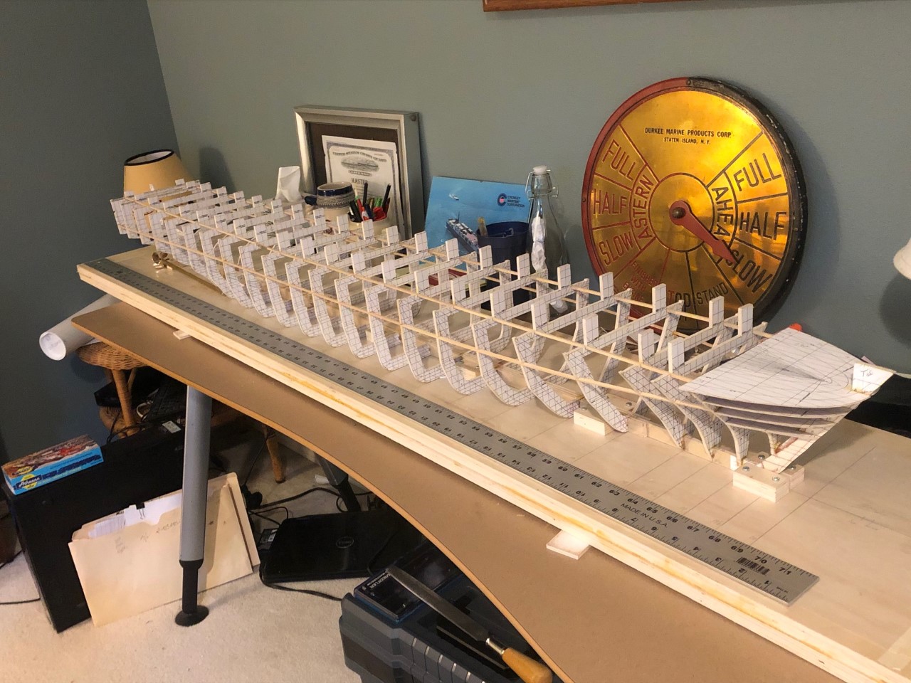

After the breasthooks and fo�c�sle deck were installed I glued the remaining stringers. Looking at the almost-complete keel/frame structure I decided that I needed one extra piece at the extreme bow, in the gap between the keel, frame 19 and the lowest (waterline-8) breasthook. I had frame 19 � as well as a breasthook for waterline #7 already marked and shaped, and after test-fitting each decided that using the lower part of frame 19 � would work best.
Bow framing with partial frame 19 1/2 installed.
After this partial frame was installed the keel/frame structure was complete. Planking the hull will be next, but I expect some further prep work before I start with that step.
Keel-frame structure complete.
Keel-frame structure flipped.

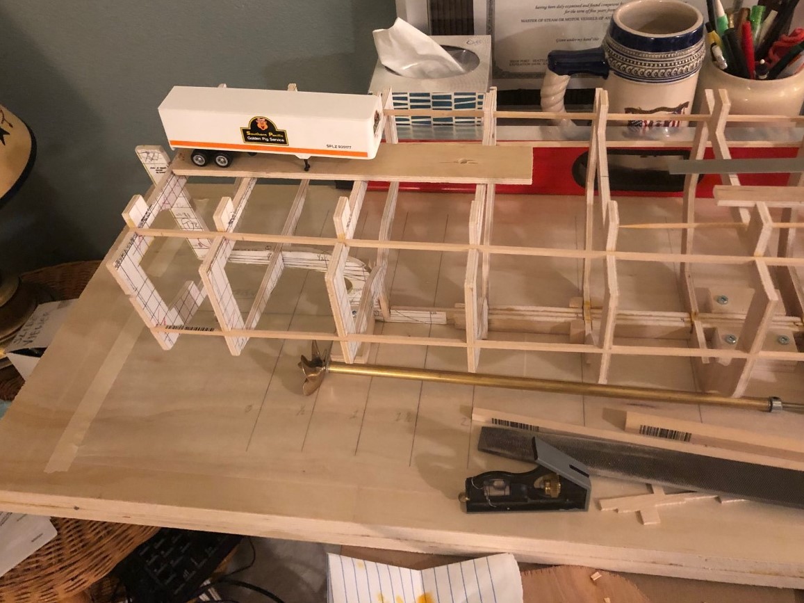

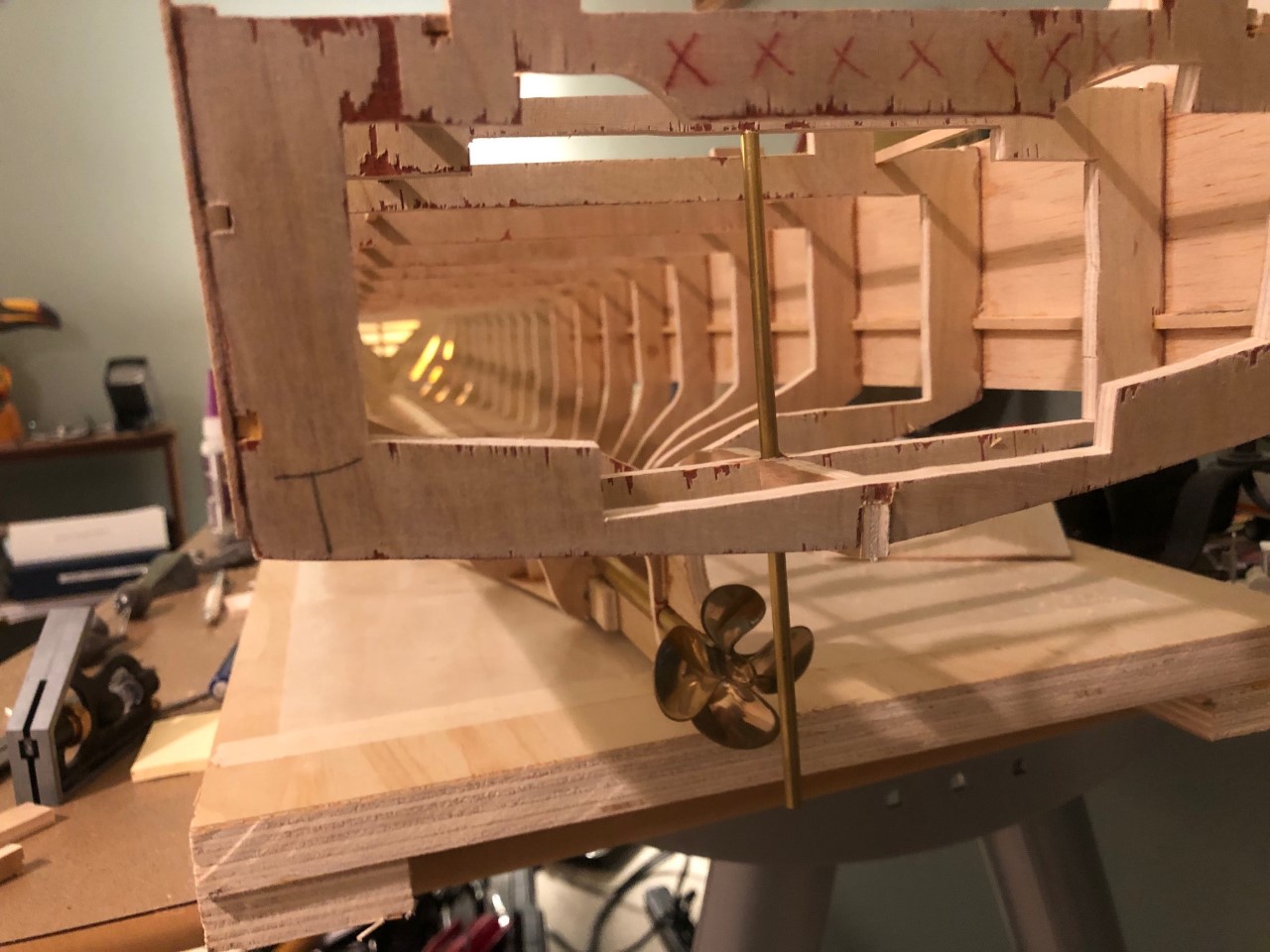

While I still have good access I decided to drill the keel/frame structure for the rudder shaft tube. I will wait until the hull is fully planked before I epoxy it in place, but figured now was a good time to get the hole drilled. The tube I am using now is over-length and will be cut to length when it is time to install it permanently.
Rudder shaft tube drilled.
I also cut the keel to take the stuffing tube for the propeller shaft. Before gluing the first frame on to the keel I marked where the stuffing tube would be and made shallow cuts on both sides of the keel piece where the stuffing tube would pass through.
Keel-stuffing tube pre-cut
I also drilled the relevant frame to take the stuffing tube long before I began assembling the frames to the keel. Now that the keel/frame structure is quite rigid I felt that I could complete the cuts without things moving out of place. It was really pretty easy to cut with a fine hand saw, using the pre-cuts as a guide.
Test fitting both gives a good idea of how it will come together. I intend to have the stuffing tube installed before planking that portion of the hull, but have a few more things to do before I am ready for that.
Prop shaft-rudder shaft tube test fit

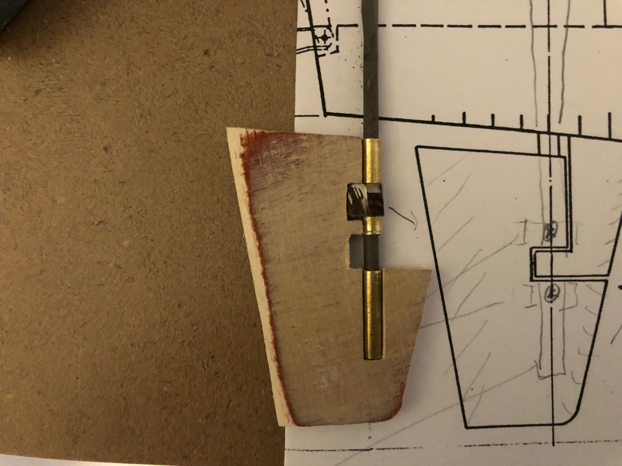

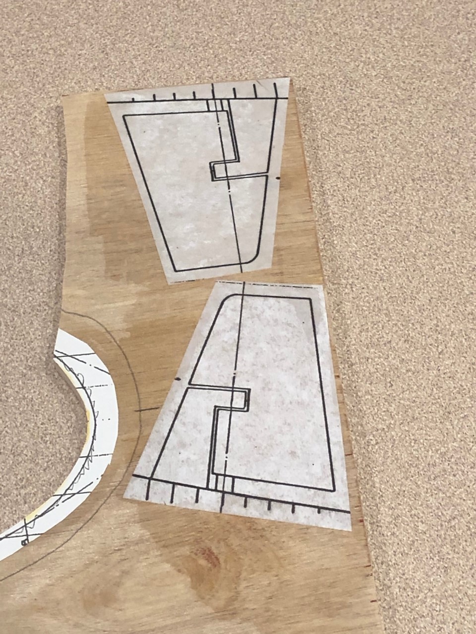

I am continuing with planking, but also working on some other pieces that need to be done eventually, such as the rudder and rudder skeg. I have been thinking of how to make the rudder/skeg operate and also wanted to make it so that the rudder could be removed for repairs if necessary without problems. I sketched out various possibilities as I planned this build and recently built the rudder/skeg combination and they appear to work well.
Like so many things so far, I started with gluing the relevant part of the prints to some scrap wood and cutting out the shapes.
Rudder and skeg glued to scrap wood.

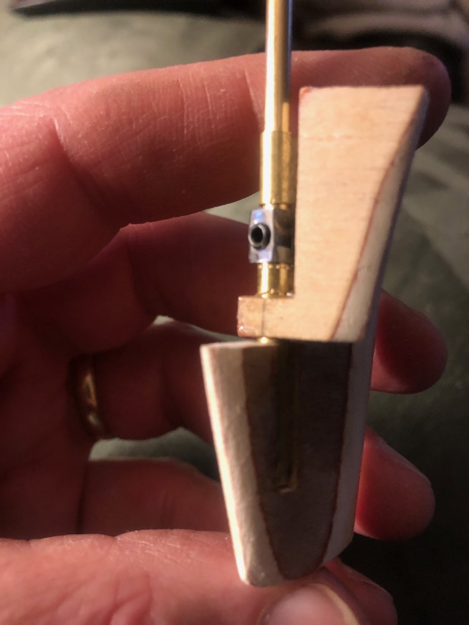

For the rudder I then made a number of different cut-outs where sections of brass tube to hold the rudder shaft would go, as well as another for a cut-down wheel collar. I had decided that using a wheel collar epoxied into the rudder would be a good way to attach the rudder to the shaft in a way that the rudder was still removable. I used a Dremel tool to cut down the wheel collar and then glued the various pieces of tube and the wheel collar to the rudder with medium CA glue, followed by quick epoxy, using a piece of rudder shaft to make sure that everything was in line.
Rudder with tubes and wheel collar glued in place.
The skeg was much easier, although for strength and alignment purposes I wanted to retain the wood structure as much as possible. To do this I drilled a small pilot hole, and then used a mini rat tail file to slowly make the hole big enough to take the shaft tube. It took a while (and some serious patience) but worked in the end.
Skeg with tube in place.
As you can see from the photos, the rudder and skeg fit together well, and also seem to operate well.
Rudder and skeg.
Rudder and skeg.
The set screw holding the rudder to the shaft is not really visible unless the rudder is turned fairly far to the side.
Rudder-set screw.
Rudder-set screw.
My next step is to coat each piece with thinner epoxy, and fill the gaps around the tubes and wheel collar with fairing epoxy. If I do it right (and after some sanding) I will have rudder and skeg that are smooth, work well and can also take the water, and all of the bits and pieces that went into building them will not be visible.
