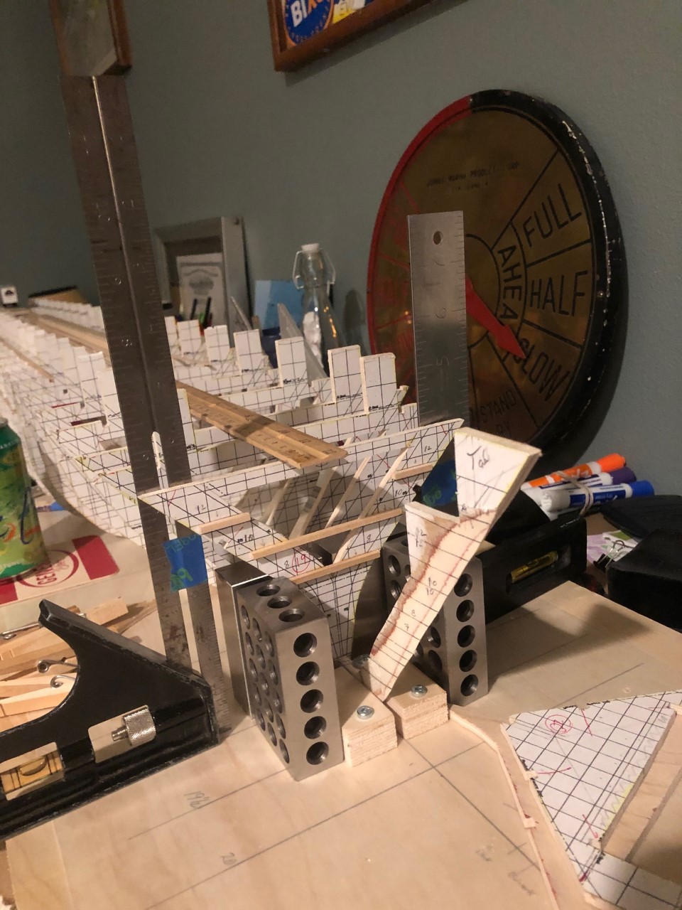

I added 2-3 frames per day, allowing plenty of time for the wood glue to set, starting forward from frame 12 and then working aft, leaving the trickier frames at the extreme bow and stern for later.
I used a quick square (or two) in addition to the 1-2-3 blocks on occasion to make sure that the frames were perpendicular to the board. This became more important as the bottom of the frames got skinnier/rounder towards the bow and stern and I could not rely on the flat bottom shape to keep those frames lined up properly. I also used a plumb bob while setting the first few frames to ensure that the centerline of the top of the frames matched the centerline of the keel. After a few frames were glued I could check this more quickly by laying a straightedge along the upper centerline marks on the frames.
File comment: Mid-body frames in progress
After fifteen frames I had run through the “easy” ones, with only one that dried mis-aligned and had to be cut out and glued again.

I definitely took my time with the after-most frames. Since I could no longer rely on the flat bottom of the frames, I had to be more careful to make sure that the frames were aligned. Besides using the 1-2-3 blocks, quick squares and straight edge on the centerline to keep everything true, I also used another pair of squares, each with masking tape at the exact same height. I lined these marks up on each side with the waterlines already on the frames to give me a fairly quick way to ensure that the frame was true to the building board (and keel).
During these steps I also noticed that the after-most part of the keel was slightly misaligned and determined that the stern-most keel blocks had to be taken up and adjusted.
The transom frame posed its own unique challenges, as the keel there is somewhat free-floating and the transom is angled 13 degrees from perpendicular, towards the stern. First I needed to hold the keel perfectly inline and at the same time hold the frame in place and at the correct angle. I ultimately settled on temporary stringers, in addition to the various squares (mentioned above) to hold it in place. The temporary piece rising from the keel (described earlier in my keel entry) worked very well in holding the transom at the proper angle.
File comment: Gluing the transom frame

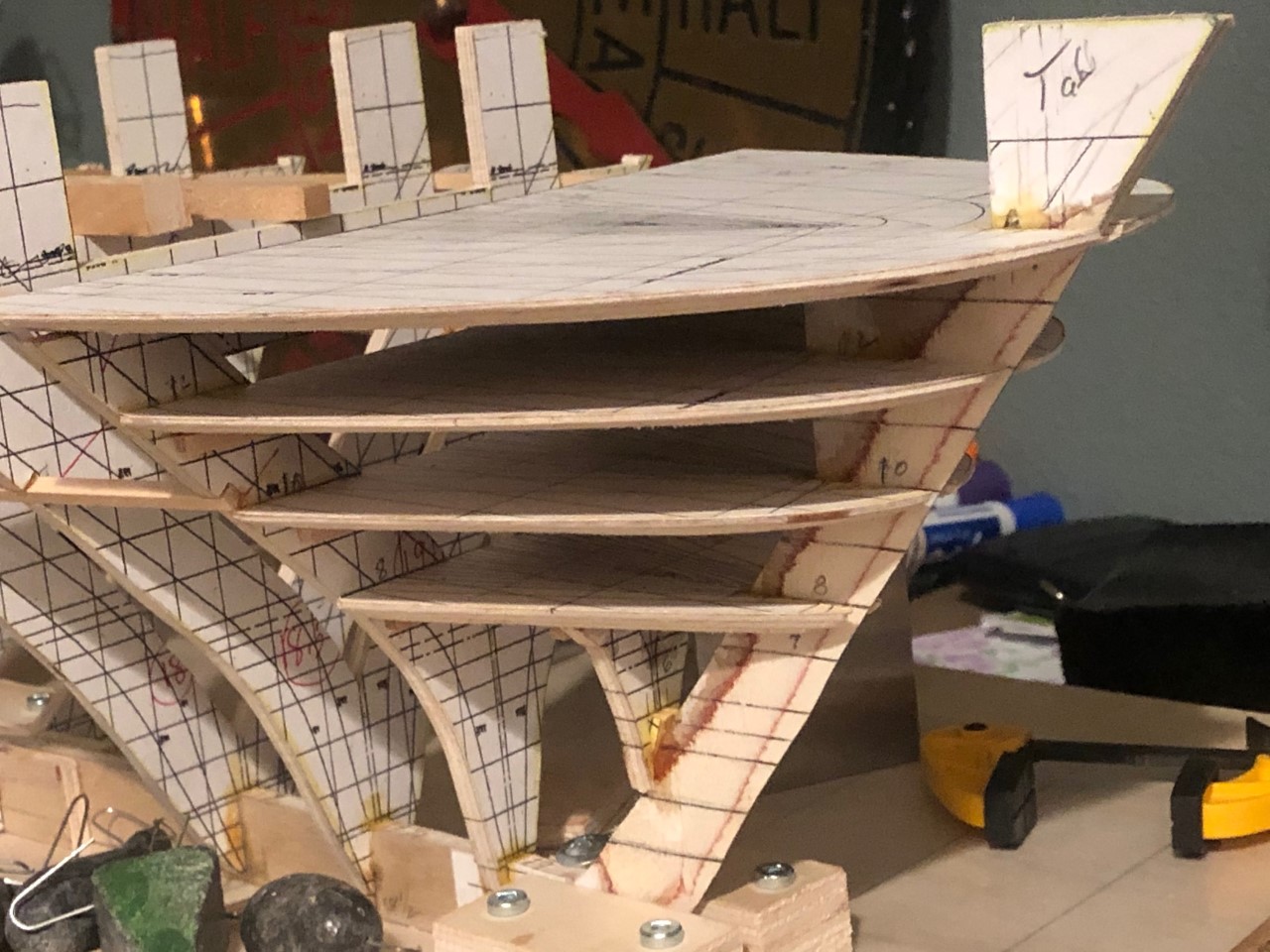

As I test-fit the forward frames it became more and more apparent that getting the right shape at the bow with just the keel and frames alone would be difficult, because the shape is rather complex as the bow transitions from a fairly fine entry at the load waterline to a broad and rounded shape at the A-Deck (fo’c’sle) level. (If you look at the very first photo I posted in this topic you can see what I mean.) I decided to add some horizontal (waterline) pieces to help get a true shape. To get the needed shapes I copied the extreme bow portion the waterline section of the hull lines. As with the frames, I mirrored this and combined the two images to get a full-width shape. These were then glued onto 1/4 inch plywood.
File comment: Breasthooks
I marked and cut these pieces as I had done with the frames. Once happy with the shape I marked and cut a notch on the forward end of each of the waterline shapes (technically more or less a breast hook) so that they fit onto the keel piece. Because these pieces will be fairly closely spaced, I needed to fair the edges so that the planking runs more smoothly. I marked the bottom of these pieces with the shape of the next one below, and used this line as guidance when sanding them fair.
I cut most of these breasthooks so that they extend aft to frame 19 and I can glue the after end to that frame. To do this easily I glued brackets at the appropriate places on the forward side of frame 19 before installing it. While test-fitting these pieces I truly appreciated having the various body plan lines on the paper glued to the frame as well as the breasthooks. Besides allowing me to cut the correct shapes in the first place, the various lines now provide multiple reference points that will make accurately fitting the pieces together much easier. The photo showing the installation of the first breasthook shows really well how the various body plan lines come together.
File comment: Waterline 8 breasthook
I also added a waterline piece at the A-deck level, which is where the fo’c’sle will be. I carried this a bit aft of frame 19 because the fo’c’sle deck extends aft of frame 19.
I have seen people carve the bow shape with stacked solid pieces of horizontal wood (bread and butter method) but I am not certain of my carving talents, so will try to plank the bow. We’ll see how it goes. I may end up shaping balsa between the breasthooks (rather than planking), or a mix of both methods. We’ll see when the time comes.

File comment: Bow planking-start
I stopped with these planks when the turn of the waterline shapes became more rounded, and then began vertically planking from the stem, working aft. Because there was much more turn at this point I used 1/8 inch wide planks, tapered to a near point at the bottom. (Except the very first two at the blunt stem, which were 3/16 wide.) As the curvature eased I used less taper and then eventually filled the remaining gap with a wedge shape.
After the extreme bow planking was complete I continued with the hull planking, extending 2-3 feet aft from the bow. These were primarily 3/16 wide planks, with a few 1/8 inch wide where the curvature required. I also had to fit a few wedge or diamond shaped planks at various places to fill gaps.

As you can see, there will be some sanding and filling to do, but overall I am happy with how the horizontal/vertical bow planking worked out, and believe that it resulted in a true shape.
The shape of the hull is becoming more and more apparent, especially when it is turned upright.

I also test fit all sorts of "planking" patterns to try to get the best shape for where the hull flattens out towards the stern ramp. I finally tried just a single sheet on one of the sides and it gave me the best look. Sometimes the simpler solution really is the best!
File comment: Sheet planking on underside of the stern
Lots of fiddling with oddball plank lengths and shapes to finish the stern area, including a number of wedge shapes as the longer plank runs were closed out.
File comment: Lots of plank sizes and shapes.
File comment: Wedge planks on the stern.
I also started doing an extra step to hold the planks in place more securely, as occasionally the thickened cyanoacrylate (super) glue popped loose after the pins were removed. After finishing a particular planking session I would turn the hull upright and brush wood glue on all of the joints where the planks made contact with the frames. I never had planks coming loose after starting this extra step.
Just a small bit remains right along the keel, and then time to plank the stern itself--and begin on the stern ramp!
