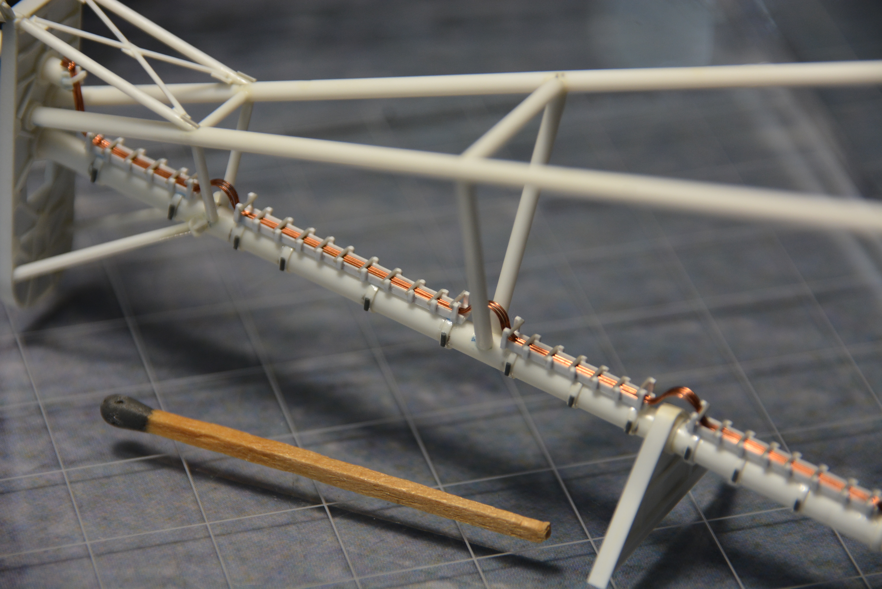

The next step, the wiring, was not that easy at all. First, what had to be done is 4 sections of brackets, at an uneven spacing, and lots of wiring in the racks. After some research, I could not find a complete picture of the rear of the main mast of a modernized Fletcher (to say nothing of Jorge Juan herself), and even in sections, I found out that not all the ships had --as usual-- the same arrangements, but I could more or less stablish that most of the ships had similar numbers of brackets in similar sections, so as representative of the class I was using the mast of USS The Sullivans, of which I have excellent pictures.
At first I tried to replicate the racks in the aft stack, and made all the pieces accordingly, using 2.00x0.5 mm. Evergreen strip,with sections of 0.5x0.25 mm. Evergreen as well. It had worked well on the stack, but (I noticed it too late), because it had required no handling at all and I was using small sections of stretched sprue for the wiring itself. It was not the case here: I had to handle it continuously, using copper wire for the wiring, because the stretched sprue broke easily with so much handling and bending at odd angles. I also discovered at my own expense that the copper wire has a life of itself and takes its own decisions, that in even in small bundles can coincide or not with my own decisions.
All this together along with the amount of glue that I had to use made the vertical strips too soft, and eventually they bent and broke. A full three-day work directly to the bin...
I had to start everything again, this time trying to make the thing a bit more solid, using 2.mm Evergreen channel and 0.5x0.5 mm. strip instead. The only drawback is that the channel limits the number of wires to only 5 instead of the 7 that I was using before, but it was now way stronger, and I thought it could cope with the unavoidable handling. It did..
The trickiest thing was to comb the copper wire in the right places at the right angles to form the three waves that are so typical of these masts, and all of them at the same time, the only possible way that I found to have all of them identical. I did the job using a 3.2 mm. tubing section bent under the pressure of two 2.00 mm. rod sections. I made a couple of tests before, and apparently it worked.
I made the middle wave first, and then the third and then the first, because the middle can be done stretching the wires un and down, but the other two have to be made with only a two mm. margin. I said apparently, because this time the copper wires got really temperamental and all the three curves seemed to agree on bending together to almost 30º to the right. It cost me blood to take them to the right position, but more or less I think I got it.
After this I simply had to add stretched sprue sections to the sides of the racks, this time a bit thinner to compensate the thickness of the 0.5 mm. bars.
I had to accept some compromise in the relative thickness of the elements, but I broke nothing, all the elements are there, the racks are not thicker than the mast itself (my fear nr. one) and I have to add the vertical ladder, many smaller elements and all the rigging and halyards yet, so I think the final effect will be good all the same.
Feel free as usual to let me know your views and suggestions if there is something else I can do at this stage.

And hi again.
The second cable trunk, that runs up all the lenght of the main leg, was attached to the mast by means of brackets fore and aft, and was made of different sections screwed together. It would very simple to make if it was not for the fact that it has to go around the platform of the AN/SPS main radar, in order to avoid the scuttle for the vertical ladder.
This is the trunk:
And this was the next headache:
I used a 0.5x2.00 mm. Evergreen stripe. I made the big angle at the top heating the bar, instead of cutting and glueing two sections, to give it some additional strength, and cut the rest of the elements accordingly. It was a headache to make everything dry-fit in position all along the process. I wanted to have this trunk complete, instead of making the sections and glueing them in place, so that I could be able to control the proportions at all times, and complete the small details without making a poly mess.
After much essay and mistake, and some reasonable amount of cursing, I completed the thing with small sections of stretched sprue, and eventually I was able to produce this, 37 pieces all together:
When set in place there are no gaps in the sections, it is parallel to the mast, it has the correct angle to follow the inclination of the platform, it is correctly aligned with the axis, and this is everything I wanted to see.
