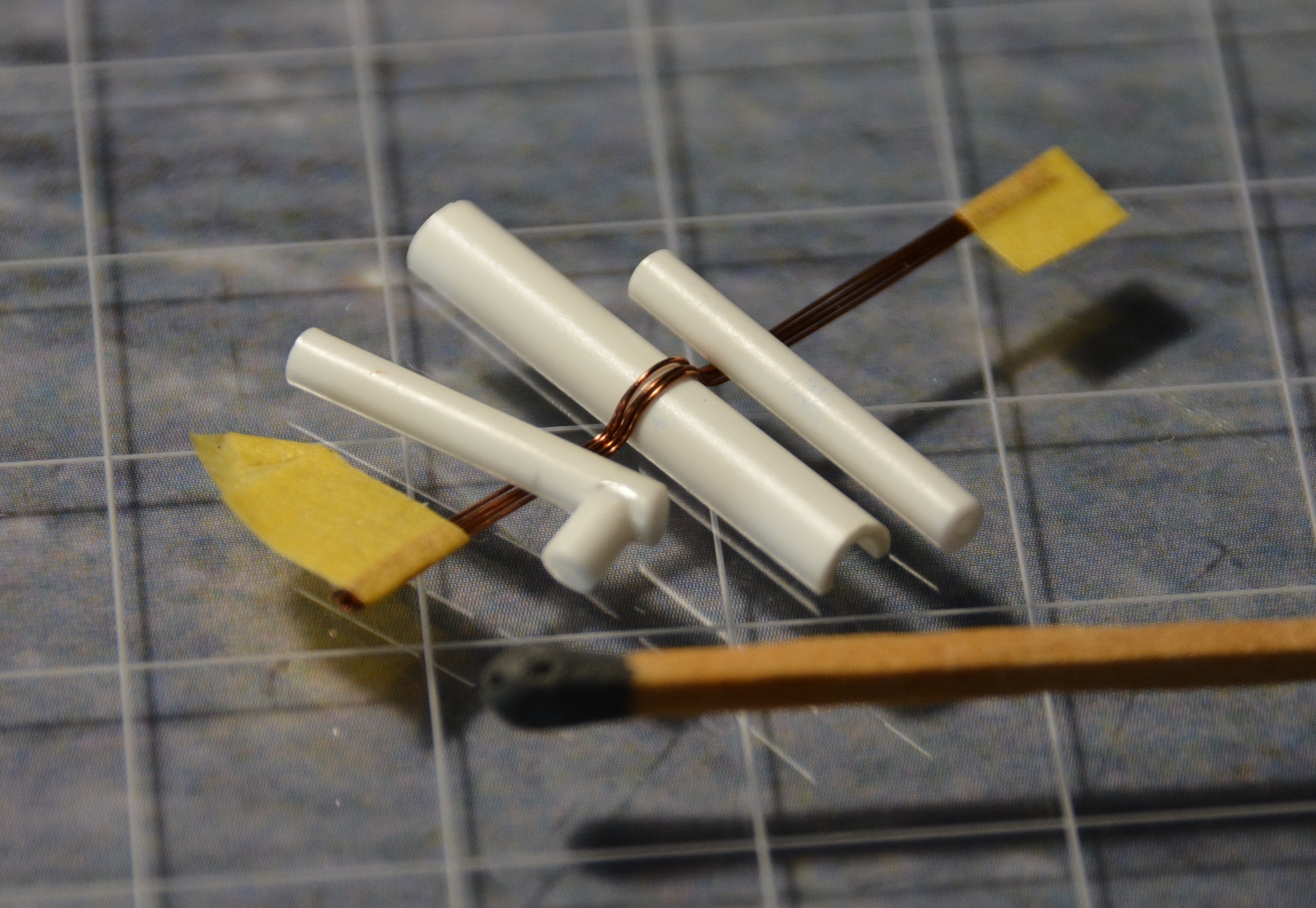

The next step, the wiring, was not that easy at all. First, what had to be done is 4 sections of brackets, at an uneven spacing, and lots of wiring in the racks. After some research, I could not find a complete picture of the rear of the main mast of a modernized Fletcher (to say nothing of Jorge Juan herself), and even in sections, I found out that not all the ships had --as usual-- the same arrangements, but I could more or less stablish that most of the ships had similar numbers of brackets in similar sections, so as representative of the class I was using the mast of USS The Sullivans, of which I have excellent pictures.
At first I tried to replicate the racks in the aft stack, and made all the pieces accordingly, using 2.00x0.5 mm. Evergreen strip,with sections of 0.5x0.25 mm. Evergreen as well. It had worked well on the stack, but (I noticed it too late), because it had required no handling at all and I was using small sections of stretched sprue for the wiring itself. It was not the case here: I had to handle it continuously, using copper wire for the wiring, because the stretched sprue broke easily with so much handling and bending at odd angles. I also discovered at my own expense that the copper wire has a life of itself and takes its own decisions, that in even in small bundles can coincide or not with my own decisions.
All this together along with the amount of glue that I had to use made the vertical strips too soft, and eventually they bent and broke. A full three-day work directly to the bin...
I had to start everything again, this time trying to make the thing a bit more solid, using 2.mm Evergreen channel and 0.5x0.5 mm. strip instead. The only drawback is that the channel limits the number of wires to only 5 instead of the 7 that I was using before, but it was now way stronger, and I thought it could cope with the unavoidable handling. It did..
The trickiest thing was to comb the copper wire in the right places at the right angles to form the three waves that are so typical of these masts, and all of them at the same time, the only possible way that I found to have all of them identical. I did the job using a 3.2 mm. tubing section bent under the pressure of two 2.00 mm. rod sections. I made a couple of tests before, and apparently it worked.
I made the middle wave first, and then the third and then the first, because the middle can be done stretching the wires un and down, but the other two have to be made with only a two mm. margin. I said apparently, because this time the copper wires got really temperamental and all the three curves seemed to agree on bending together to almost 30� to the right. It cost me blood to take them to the right position, but more or less I think I got it.
After this I simply had to add stretched sprue sections to the sides of the racks, this time a bit thinner to compensate the thickness of the 0.5 mm. bars.
I had to accept some compromise in the relative thickness of the elements, but I broke nothing, all the elements are there, the racks are not thicker than the mast itself (my fear nr. one) and I have to add the vertical ladder, many smaller elements and all the rigging and halyards yet, so I think the final effect will be good all the same.

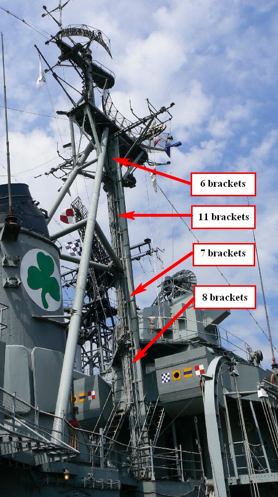

Even if there were the usual variations in the location of the different elements, the Fletcher class had a common equipment reg. the topgallant masts, and USS McGowan had the most usual location of aerials, this one, in 1956, short time before the transfer to the Spanish Navy, and one that she kept for some years:
The wiring was attached to the masts following also a common pattern, with beautiful curves that were IMO as specifically designed for modelling:
On the other hand, Jorge Juan had an further upper topgallant added AFAIK in the mid 60�s, the moment in which I try to represent her (no other reason than I was born in 1964). Sadly, there is (or I have not been able to find it at least) absolutely no clear picture of this part in both Jorge Juan and sister ship Alcal� Galiano. I have been able to find only these two crops :
One of the elements is clearly an anemometer, very easy to carve in a piece of sprue. The other elements seem to be the AS-390/SRC aerial, two supports for the topgallant mast placed in a 45� angle, and apparently a small rounded platform for two more aerials (?) just under the anemometer.
I am not completely sure that all this is 100% true but I have found no better source, so this will have to do. Making it all was much easier than finding the information.
I think it is quite consistent with the pictures, and in any case it is not unrealistic, and it is enough.
