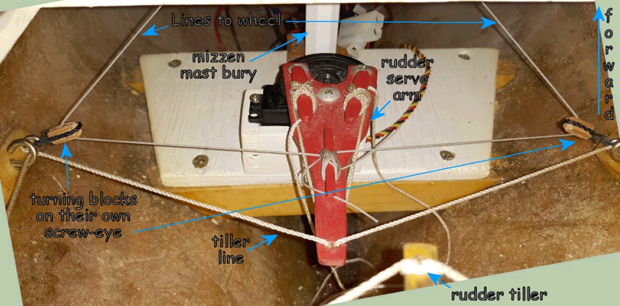

Shifted work to another model trying to get it's controls in order. But Constellation did get some work done...
File comment: a pit of paint on some printed parts
File comment: Connected to steering wheel to the rudder servo

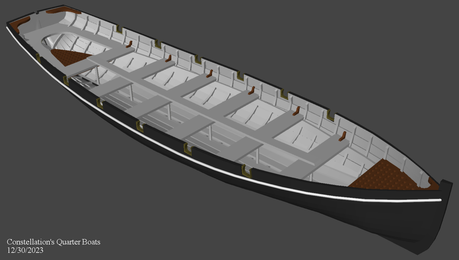

As 3D printing things for the models was going pretty well, I decided to also print the remaining boats. I had already built the launch and 1st cutter, and planned to build the 2nd cutter next, in the same way, but began a 3D model back in 2020.
File comment: Ship's launch and 1st cutter in wood with some 3D printed parts added.

Once the 2nd cutter was printed, I focused more on the quarter boats. It's one 3D model, but two of them get printed to eventually hang on davits on the aft quarters of the ship.
File comment: x-ray view of quarter-boat in progress

These boats look very much like the cutters, but are a little longer, not as tall, with narrower sterns. At 1:36 scale, they're about 8-7/8th inches long (22.5cm). All the boats will be too long to print in one piece, and are made in halves, but both quarter-boats can be printed at once with room to spare.
