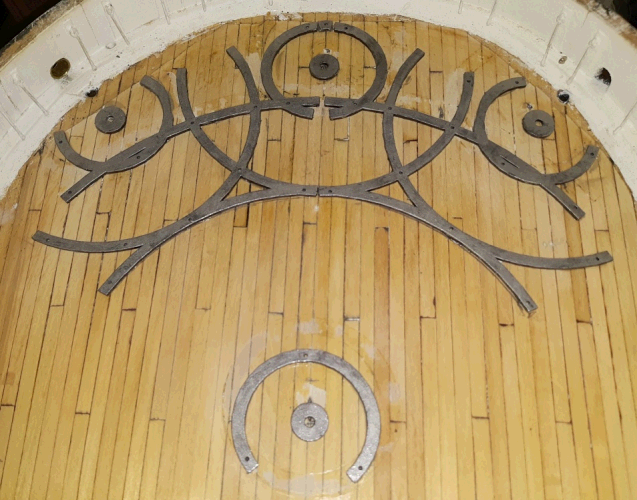

File comment: More elaborate deck circles printed
File comment: Bow deck circles painted Steel
File comment: Stern deck circles painted Steel

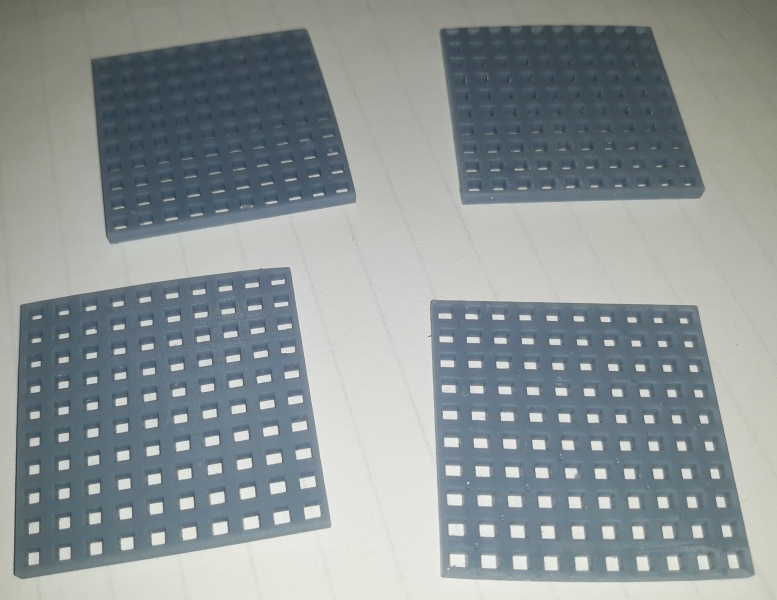

File comment: printed gratings

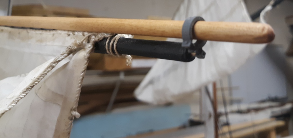

File comment: When the brass square-stock came in, the outboard stuns'l boom irons got installed and painted.

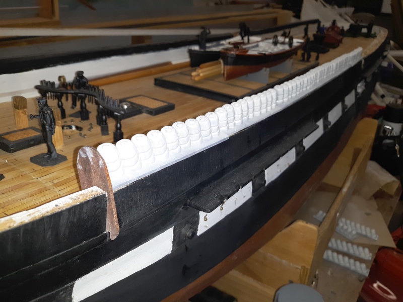

File comment: Gluing down starboard side hammocks
File comment: Seam between hammock pieces and bulwark covered with a strip of basswood. Still 3/4 of the rails to do like this.

John Dahlgren submitted a drawing, dated July 31 1850, proposing his idea of the ideal armament for "First-Class Frigates" suggesting they be armed with six 10 inch pivot guns on the spar deck, and 26 9 inch guns on the gun deck. The Navy rejected the proposal, mostly; they opted for two 10 inch pivots and the gun deck armed with 8 inch shell-guns and 32# shot guns, and the big frigates, razees (cut down frigates) were armed in this manner, including Constellation, the newest, and largest sloop-of-war that wasn't a razeed frigate.
File comment: 10 Shell Gun ~ Pivot Carriage
from Dahlgren's 1850 proposal
On a visit to the ship, years ago, they showed the Mississippi Pivot Gun plans, saying that was what Constellation was originally armed with; which were eventually replaced with Parrott rifle pivots, a plan they also showed me. I took some pictures of the Parrott plans, but went to the National Archives in College Park Maryland, to get a proper copy of the Mississippi plan.
On August 26 1854, the sloop-of-war Constellation would be launched. Almost a year later, June 1855, the plan for the 10 inch pivot guns for the side-wheel frigate Mississippi was drawn. Another year on, Constellation was commissioned on July 28 1855.
File comment: Plan for Mississippi's 10 inch pivot guns of 86cwt

Installing the pin-rails is a bit involved. Painting the bulwarks after the pin-rails are installed would be a huge pain-in-the-a$$.
The 3D printed hammock are on "trays" that are slightly wider than the bulwark to accommodate any irregularities. That overhang has to be ground flush with the bulwarks, so a covering board trim piece can hide the seam.
File comment: 3D printed trays of hammocks
File comment: How the model's bulwarks are constructed
That done, any gap were filled with epoxy/sawdust putty, and the bulwarks got painted. I also painted the hammocks, but the color doesn't look canvas enough for me.
File comment: Hammock trays ground flush, and some paint
