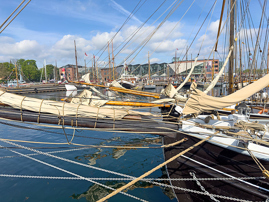

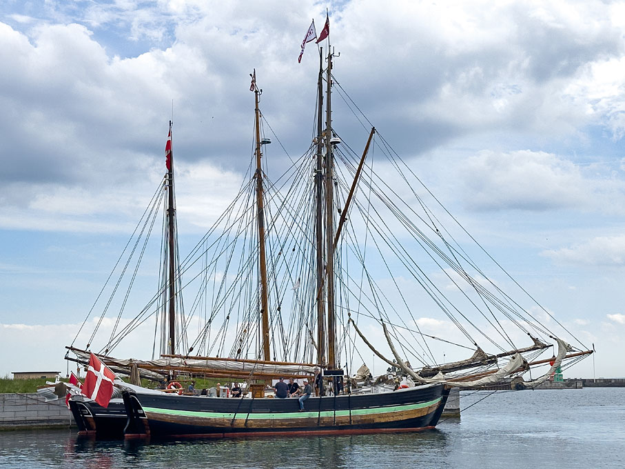

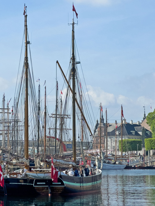

A sign of Life from the Shipyard
The last few weeks since the posting at the end of April have been crazy with travelling. I have been two weeks to Switzerland, a week to Denmark, and another week in Spain, mainly for business reasons.
I extended that business-trip to Copenhagen by a few days in order to re-visit a few museums in and around the city, including the M/S Museet for Søfart in Helsingør, the Vikingeskibs Museet in Roskilde, and the Krigsmuseet in Copenhagen that now houses the naval collection from the Holmen.
It being the long Pentecost-weekend, there turned out to be a sailing ship gathering in the harbour of Helsingør in front of the Kronborg Castle (of Hamlet’s fame). Among the various schooners, galiots, and smacks (jagts) there was also JENSINE af HADERSLEV (https://www.jensine.dk), a Danish jagt originally built in 1852, so more or less contemporary with the Rahschlup. She has the kind of livery that I have chosen for my project.
Unfortunately, JENSINE was sort of parked in third row, so I could get close to her. However, there are a few shots from this event below.
In between travels, I continued to work on small bits and pieces, but nothing has progressed to a stage that can be shown yet.
Updates to come soon …
