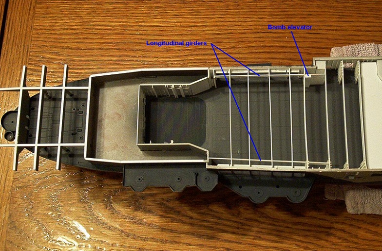

Improving the Hangar Deck overhead
The real ship's Flight Deck was supported by various structural girders that were visible from below inside the Hangar Deck. The space enclosed by these girders in the midships area contained various offices, berthing and ammunition handling rooms associated with the air group. None of these details is included in the Trumpy kit. Since I opened up all of the Hangar Deck roller doors on the kit, the absence of any overhead details would be conspicuous therefore they would have to be scratch built. Here you can see some of the work to add transverse and longitudinal girders as well as the midships area containing the air group's compartments.
Forward and aft of the midships Air Group compartments, the space enclosed by girders was largely open to the hangar deck below except for the space immediately to port of the aft elevator. (I chose to build that structure on the bottom of the kit's Flight Deck parts therefore it isn't visible in the images below.)
File comment: Note that two gallery deck level 40mm ammunition handling rooms are installed adjacent to, and inboard of, the two port,
aft Bofors platforms. Since these compartments are visible from the hangar deck it was necessary to make them.
File comment: Here, the fore transverse girders are installed. AOTS drawings indicate that the transverse girders on the real ship varied in height and were not spaced evenly. Note that four longitudinal girders between the forward elevator and midships Air Group compartments have not yet been fabricated nor installed. Some minor adjustments to the alignment of the girders will be made.
