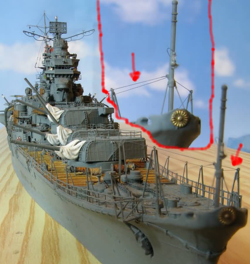

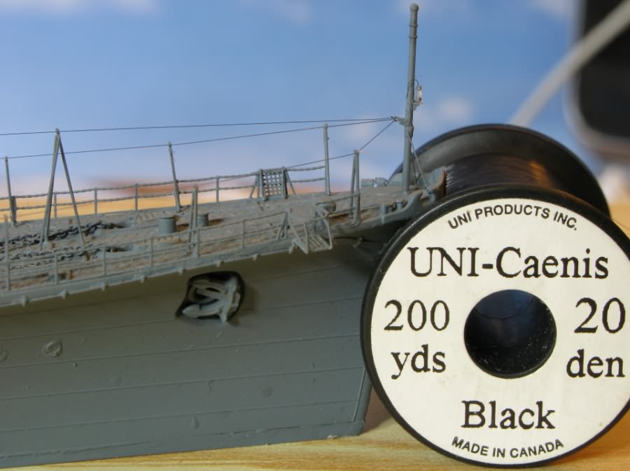

Thanks Jose :wave_1: for the endorsement concerning the 25 mm steel bases!
I added awning stanchions (from Gold Medal Models Gold PLUS Takao Details) and the corresponding line (Uni-Caenis 20 den).
Mogami184
Mogami184
Mogami185
Mogami185
The unit �den� or �denier� means the mass m in g per length of L=9000 m length. So this makes m/L=0.020kg/9000m. When the density ? of the fiber is known, it is possible to calculate the fiber radius with the equation r=?(1/???m/L). Assuming ?=1400 kg/m^3 this gives r=22.5�m. For a model scale 1/350 this gives a line diameter of approximately 16 mm in the real world. So I think, at least for 1/350 this should be close to reality. (I hope that my calculation is correct and the density assumption in the right order.)

Nice job with those steel baseplates and with the awning stanchions. Rigging on the latter looks very subtle.
The lamp with its cable on the jackstaff is another brilliant detail. :thumbs_up_1:
Thank you for the explanation about den thickness!
