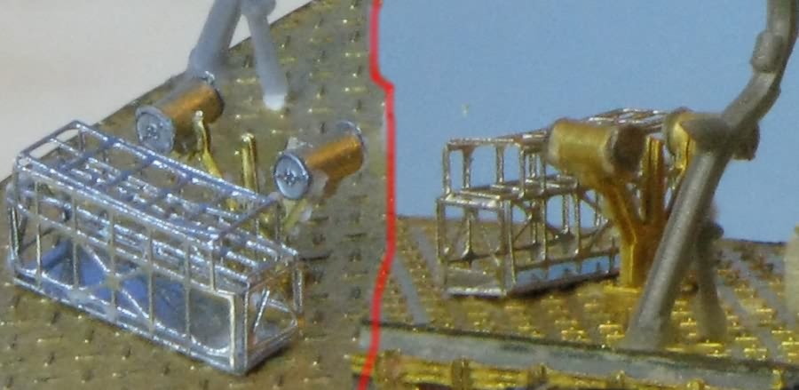

Now I started to detail the rear area. Because no place for my huge fingers I glued the ship to a metal tool. I decided to use the Fine Molds davits. Finally I found a solution for the twin 13mm. It was part of the Lion Roar 25mm AA gun set II (LE70042). Lion Roar made a mistake here: The guns are only deep etched from one side. Therefore, they should be mirrored. This is not the case. If you want to assemble both with the etched side out one has to be upside down with the magazine pointing down. I fixed this partially.
Depth charge magazine is from Lion Roar, depth charge thrower from Flyhawk and depth charges from Voyager.
