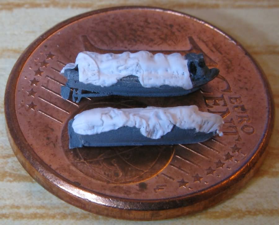

The IJN Kongo I started (viewtopic.php?f=59&t=58973) is my first model in scale 1/700. To get more experience in this scale I decided to start with a very small ship before I continue with a battleship. I selected the IJN Submarine Chaser Type 13 from Tamiya 1/700 (from the WWII Japanese Navy Auxiliary Vessels kit). This is an older model and a lot can be improved.
File comment: Subchaser01
First I removed everything from the deck (1: before 2: after removing deck details).
This is the state now after adding the first details.
