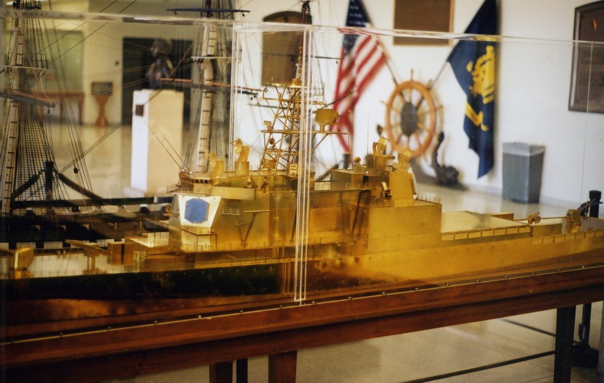

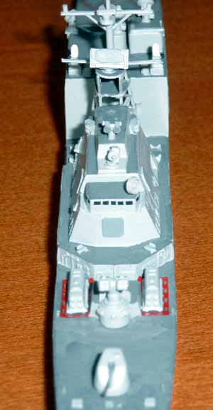

I plan to make a 1/700 test-run model of this class of ship before I make the financial investment into a 1/350 ISW Virginia-class model. Does anyone have suggestions or comments before I begin?

Where is that brass model?

so how about some designs.. since CGN-38 has been scrapped (just the main deck and hull are left from I understand).. Are you purposing using a Spruance/Tycho hull for the base line?... Or stretching a FLTII Burke out for greater stability and upgrades...
On a side note.. NAVYDAVE.. the only 1/350 kit is resin.. 1/700 has plastic and resin version of CGN-38.. have you given thoughts to what will be the starting point..

Oh, and the brass model is in the Rickover building at the Naval Academy.
With exception of the mast, this is what the forward structure will look like.
