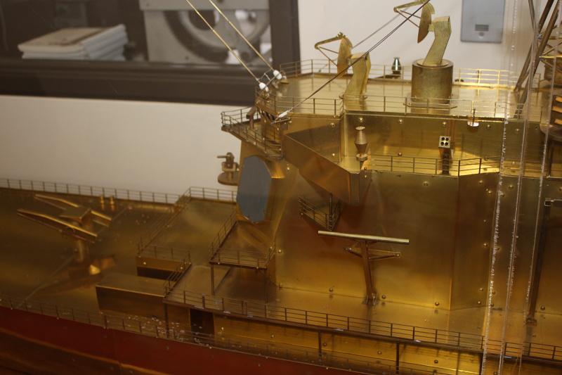

Way back in the 1970s we had nuclear cruisers on order called the Virginia-class CGNs, and these were to be some bad @$$ ships. As they came on-line they actually turned out to be some extremely valuable ships. During the 1980s they were given the New Threat Upgrade (NTU) which brought them up to par with the Aegis weapon direction system. The only draw back was that NTU had rotating radars instead of static radars like Aegis. In all practicality and desipte other assertions, this did not make a lot of difference with the war-fighting capability of the NTU ships. However, because the Virginia-class CGNs had a lot of people on board, required a lot of money to maintain, did not have Aegis, were restricted to the majority AAW role with MK-26 launchers, had no helicopters, and were thus limited to escort duty, they were decommissioned, defueled, and the hulls are ready to be scrapped at 1/2 of their nuclear reactor’s lives.
Despite the four existing ships being ruined and destroyed, eleven ships of this class were initially ordered. Construction halted after the initial 4, because there was a concept to continue the class but equip it with the Aegis weapon system! This would have provided nuclear powered Aegis ships...“unlimited steaming Aegis platforms”. These ships would have been heavily armed and capable escort ships for nuclear powered aircraft carriers.

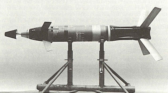

One might suggest the Advanced Gun System (ASG) instead of the Mk71. When one examines the capabilities and level of development one discovers that AGS is a terribly large gun system that provides inferior fire for ship roles, both in NSFS and NSuW. However, since the Mk71 8" gun is simply an expansion of the Mk45 5" gun, delivering 75% more ordnance than a 155mm (AGS round) and 250% of a 5inch round, incorporating the 8inch gun would only require a larger base ring than the Mk45 5", a slightly larger magazine, and it would deliver a far superior precision guided round onto either ship or shore targets. The large amount of surplus volume inside the hull, 600 8inch rounds forward and 475 8inch rounds aft, would provide this ship with an anti-ship and NSFS capability unheard of since the WWII designed heavy cruiser USS Newport News!

Where is that brass model?

Oh, and the brass model is in the Rickover building at the Naval Academy.

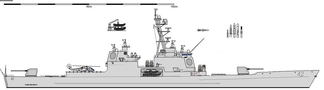

Yes, before I made this post I made a ship bucket drawing:
I will continue to revise this arrangement taking into account internal volume. Striking the balance of internal volume to afford the largest 8" magazines is the next concern. In addition to the 5" magazine I would like to find out what replaced the below-deck helicopter hanger. That will determine how large the aft 8" magazine can actually be. An advantage this hull offers is the very great amount if depth of hull for those penetrating weapon systems, especially in the stern where machinery usually consumes a lot of space, here the stern was designed for an entire below-deck hanger, and that offers a lot of internal volume free of critical machinery like rudder controls.
I will continue refining the smaller details such as structure angle and other RCS concerns.
Keep the observations and suggestions coming.

I know I harp on this theme but I really think that the helo landing area in your drawing is way undersized. Using the scale in the drawing, the landing area looks to be about 60-65 ft (fore/aft length). By comparison, the Perry FFG, which has the smallest SH-60 Seahawk family landing area that I'm aware of, has a landing area of about 83 ft. Recall that the original short-hull Perrys were not (are not) rated for SH-60 operations and that the Navy lengthened them to safely accomodate Seahawks. That suggests that the Navy believes that the shortest, safe operating length is about 80 ft. I know that given a pressing need a good helo pilot can probably land inside a much smaller area but no pilot is going to want to do that on a regular basis.
Also, there is a chance that the aft Mk71 gun is a problem as far as height relative to the landing surface. Again, recall that the stepped down area at the stern of the Perry's landing area was the result of the capstan sticking slightly above the landing area surface. Now, in your drawing, the gun is further aft so it might not be considered a problem.
I'm not a helo expert, by any means, and I'm only drawing conclusions from the examples that are out there. You should try to contact a helo guy and get the real story on landing areas. In the meantime, though, remember that the Perrys had to be lengthened to be able to operate SH-60s. It seems unlikely that a 60-65 ft area would be acceptable on a new build.

With exception of the mast, this is what the forward structure will look like.
