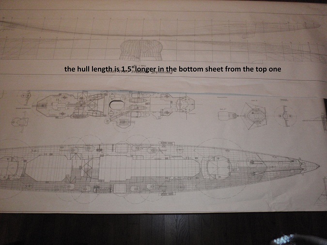

i received my plans today they came in the wrong scale,and there is lots of discrepancys.there are 4 sheets and the only distance that is right is the beam,it is the same on all sheets,the length verys 1.5" .the plans are in 1/100 scale and the length should be 73.5" but the deck plan is 75.5" the hull lines one is correct at 73.5 .i have to scale these down to 1/144 but the top and side elevations are the wrong length,not only that the top elevation has the deck assemblys on it and thay do not match the top view.the plans are for graff spree and i would like to do the sheer as of 1944 which has a atlantic bow,capped funnel and a differant bridge area.i knew the funnel and bow where differant but the bridge area came as a supprise,i had no idea this was differant as of 1940.i have a rough idea how it looks but i will have to find some good drawings of this area.the reason for naming this thread deutchland class is because if i cannot find good enough drawing for sheer she will be graf spree.p.s i have one more sheet of plans coming it is supposed to be sheer as of 1945 i hope it is right.i think i can start cutting frames once i get the hull lines sheet scaled down.
File comment: the funnel here is bigger than the one below,both of these sheets are 1/100
File comment: these frames do not match the ones on the hull lines sheet ,they are bigger

Hi Russ,
what a pitty with the drawings. I constantly make such experiences even with original drawings. Sometimes they are so off that I think it must have been an anti-espionage mean ....?!

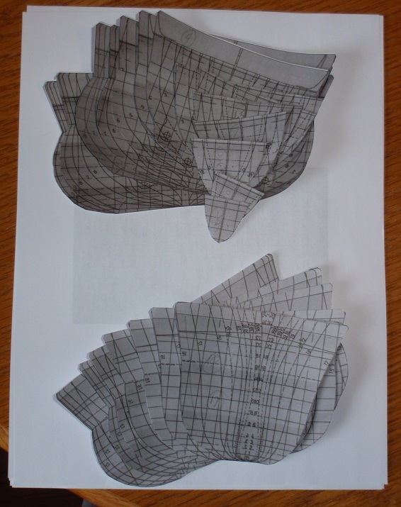

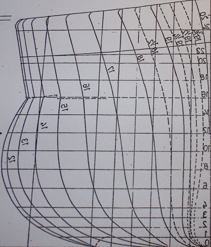

yikes one has to really check and double check plans and drawings.i have been rescaling my plans down to 1/144 from 1/100.i have every thing done and thay appeared to be good,then i started working on hull frames,opps a problum. on my plan the frames are drawn as half frames for the forward ,then the stern frames are shown on the other side,looks good but the stern frames are smaller.see pic #1.if i had not found this when i cut the frames, half of them would have been 1/8"smaller.Not good.second pic is a mirror image of the right side of first pic,i did this for the redone other side also .them i spliced them together to make a complete frame the third pic.the last pic is the first 12 frames and the aft 13 frames.i printed out 14 of these ,now all i have to do is trim each one and stick it on plywood and start cutting.i will not be able to cut the formost frames because thay are for graf spree not sheer as of 1941-45.does anyone have a drawing or any idea how much more sheer there is and how much more length. She is 610 ft 1939 is she a little longer with the atlantic bow.
i made the frames 1/4" smaller to allow for sheeting.i am not sure if i will glue them to the center board or cut and slide them on,if i glue them on one side at a time i will have to trim 1/8" off the center board side to keep the right beam.hope this all makes sense.

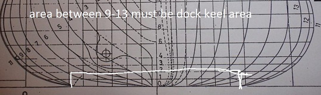

PostPosted: Mon Jan 03, 2011 6:08 pm
Posts: 1173
hello 109 the plans show something ,but i am not sure what it is.if they where nuckles would not they be added to the outside of the hull not indented.plans show a flat bottum so what good would thay do anyhow.she would sit flat on a drydock .i will more than likly just ignore the dotted lines.i am not an expert on this and i have enough trouble with plans so i no not need more grieve,thanks for your interest :thumbs_up_1: heres a pick of hull frames ready to glue to plywood,the bow ones stop at #17 forward of this is the atlantic bow area which i am sure will be differant,just can't seem to find any info on that area.
PostPosted: Mon Jan 03, 2011 6:39 pm
Posts: 550
Hi,
the point is to lengthen the flat hull bottom over the bilge which enlarges the flat surfaces on which the ship rests while in a dry dock. It is better to spread a load onto a flat surface than onto a curved one, because on the curved one the load rests on a single point or line of an exessive load which will damgae the ship. You can see this shape on SC hull on the fotos of the capsized ship, look out for the area behind the rear end of the bilge keel.

thanks dave, As in chess ARH.is king i am but a lowely pawn.Hi 109 i have been studying pics and drawings for days, I think the dock keels you refer to are the areas between frame 9 to 13 in the pic below.the hull sides come down and instead of a gradual curve to the keel it has a sharp tranition to a flat bottum,if this is what you mean it should be no trouble modeling them.on the side view plan they are from the rear range finder to just in front of the bridge. i still cannot find adrawing or good pics of the atlantic bow.
this is holding me up as i can't cut the hull frames

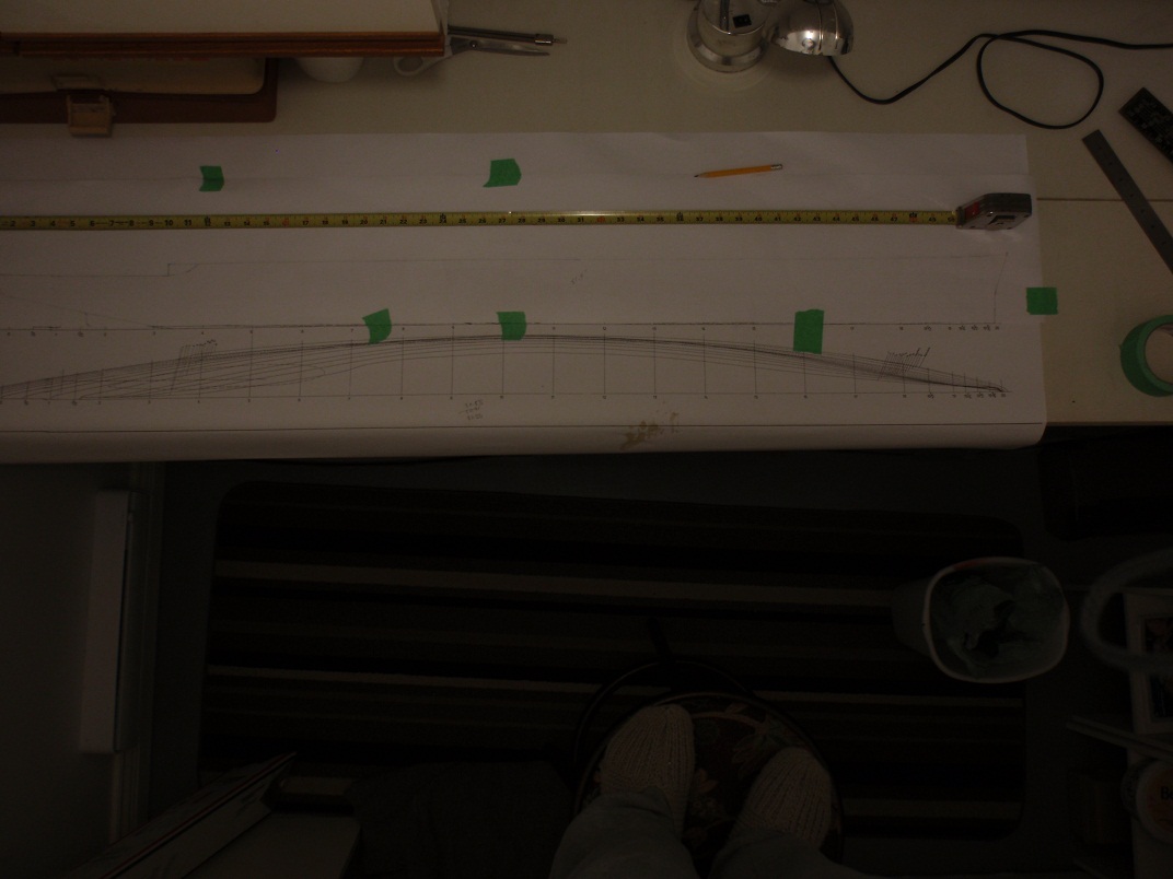

just some more getting ready to cut frames and center board.i trace all my frames and center board onto another sheet of paper,because if i screw it up i still have the original to go back to.the bow area on the center frame will stop at frame19.5,i will add a piece of fairly thick styrene for the last few inches.this is easyer than trying to shave down the 1/4 in plywood and gives a nice sharp edge to the bow.heres some pics of plans and frame work.
File comment: tracing center board onto another sheet of paper
