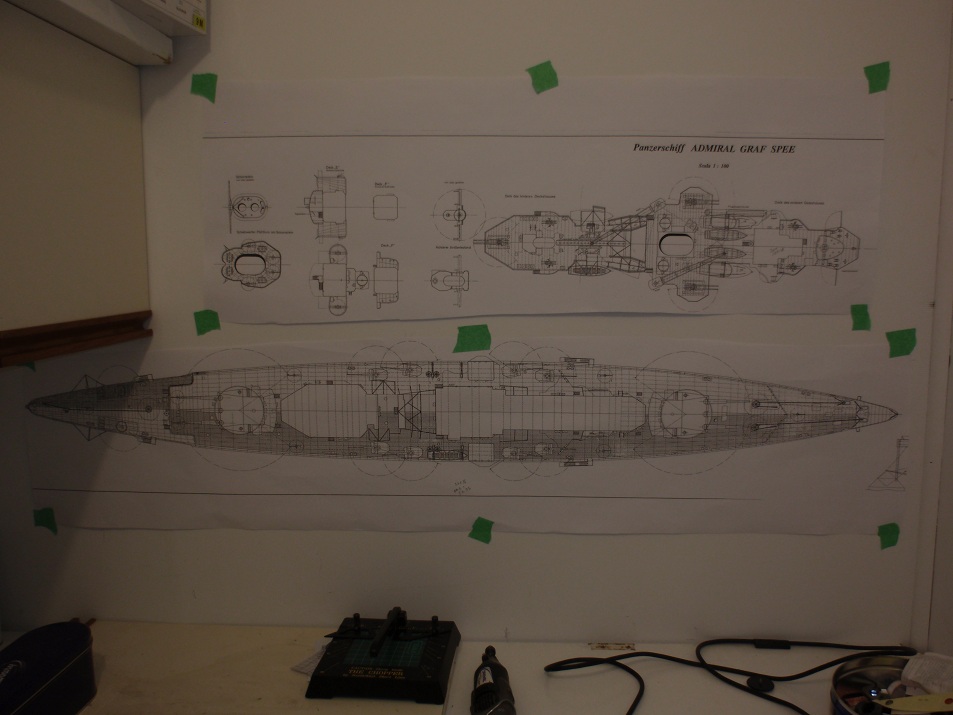

i received my plans today they came in the wrong scale,and there is lots of discrepancys.there are 4 sheets and the only distance that is right is the beam,it is the same on all sheets,the length verys 1.5" .the plans are in 1/100 scale and the length should be 73.5" but the deck plan is 75.5" the hull lines one is correct at 73.5 .i have to scale these down to 1/144 but the top and side elevations are the wrong length,not only that the top elevation has the deck assemblys on it and thay do not match the top view.the plans are for graff spree and i would like to do the sheer as of 1944 which has a atlantic bow,capped funnel and a differant bridge area.i knew the funnel and bow where differant but the bridge area came as a supprise,i had no idea this was differant as of 1940.i have a rough idea how it looks but i will have to find some good drawings of this area.the reason for naming this thread deutchland class is because if i cannot find good enough drawing for sheer she will be graf spree.p.s i have one more sheet of plans coming it is supposed to be sheer as of 1945 i hope it is right.i think i can start cutting frames once i get the hull lines sheet scaled down.
the funnel here is bigger than the one below,both of these sheets are 1/100
these frames do not match the ones on the hull lines sheet ,they are bigger

thanks for the info bernd.every thing is helpful.keep up the great work on your hull,and the best in the new year.i got the plans rescaled, some sheets had to be done twice,everything is now within 1/4" of each other. i will not do any work on the hull until i get the drawings for the sheer,she must be a little longer and have more sheer forward ,thats a little bit of a pun :big_grin: .,so my hull plans will have to have a little modifcation.

Hi Russ It's good to see that you have managed to re-scale your new plans successfully but not getting quite the drawings you wanted is frustrating..In the past I have been aware that even copying a drawing can in fact alter the dimensions sufficiently to throw other parts of the plans out .My confidence in accurate drawings is tempered by the knowledge that constant copying does make the accuracy suspect. Non the less good luck with your build.

hi dave ,yes i am happy with the drawings now.i am looking forward to building in 1/144, every thing a little bigger,but it means more detail to add.i have a photo shop program on my computer so if there is a differance between two drawings i can take a pic of it crop it and make it come out the right size.it sometimes takes a few print outs ,but i enjoy doing that sort of thing.
