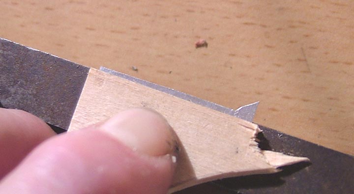

This is what I use.
ARH :wave_1: :wave_1: :thumbs_up_1:
Simple but effective.

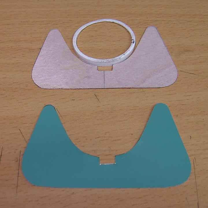

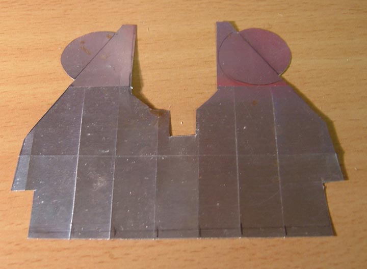

We are having a change tonight from planking, on ID we have some metal decks, I never like just painting over ply or plastic, I like to plate my decks, some times with cardboard but this time a new technique with the litho plate,
Looking like batman, this is the deck pattern of the rear superstructure when cut out, it is turned over and marked off like 8ft x 4ft sheets of steel, then it is scribed on the back lightly.

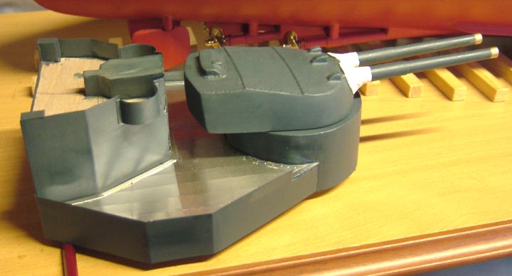

Combings are cut round the edge, at the back of the turret I have shown some riveting.

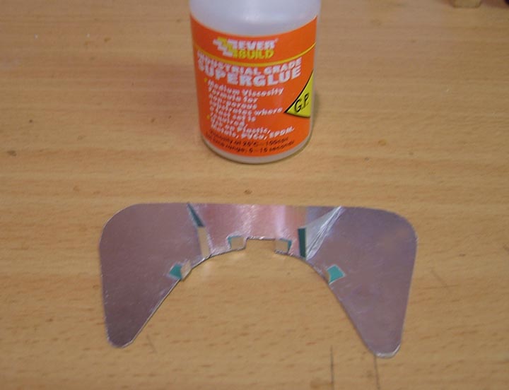

This is the shape of the upper deck.
Turned over and a fold put in to it,

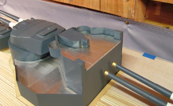

Fitted in place and glued down, now you can see where the fold went.

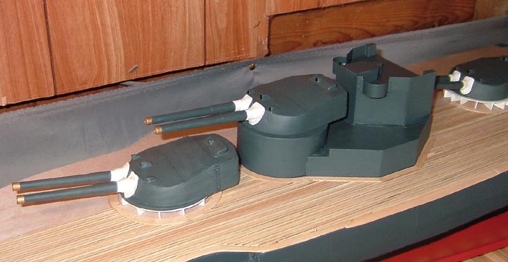

An overall view of the structure with the three turrets.
With this method you could plate a modern ship if you took your time, and would look effective.

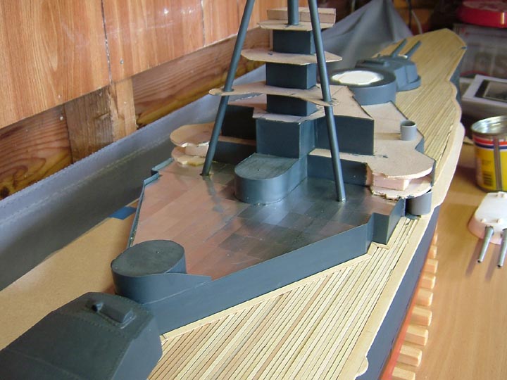

Rear superstructure decks painted, same colour as structure.
Plating for armour bridge deck.
Fitted in position.
Overall rear view.
Overall bow shot.

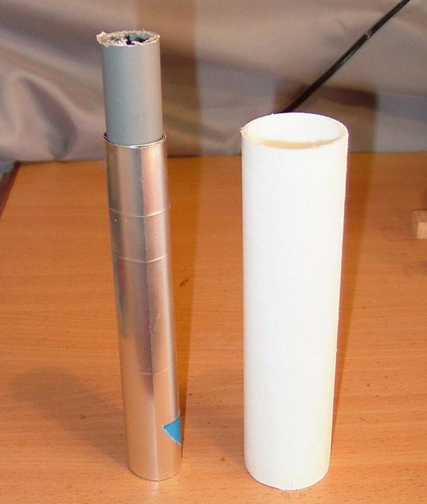

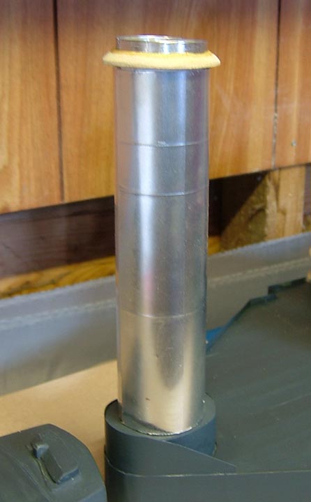

We have the litho rolled up on a small tube, when released it will spring out larger, we also have the lining of the stack, you can see the difference in size.
One lining fitted and glued, one rolled up.

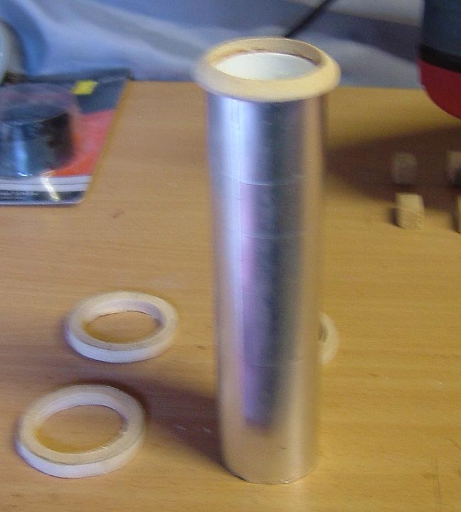

Hi Guys, I will continue with the funnel (smoke stack.)

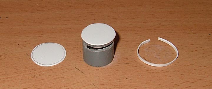

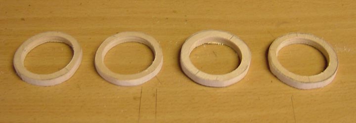

The next step was to mark and cut out 4 rings .
The inner part was saved and glued on the the base of the stacks.
These were cut out on the vibro saw.
One ring sanded to shape, this is for the top of the stack. Ring fitted in place.
Cut from litho plate and shaped round , this fits inside the ring on top.
Fitted in place.

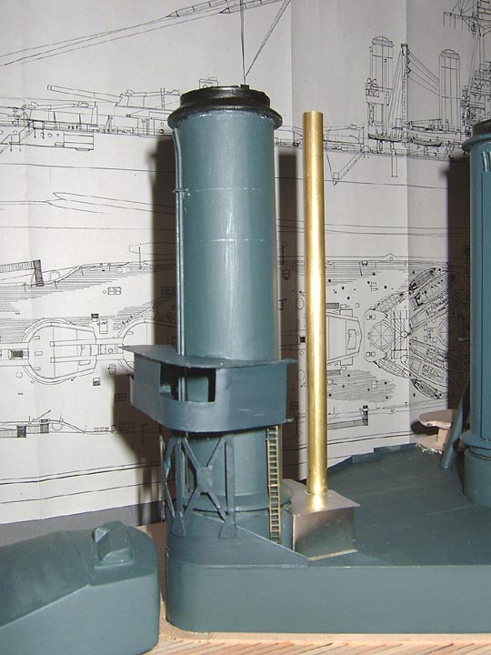

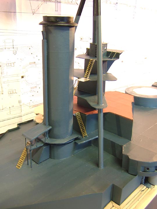

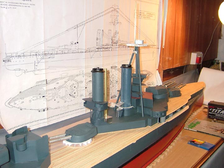

Steam pipes, made from aluminium and opened up at the top to make a flared opening, 2 brackets fitted.
Stern view, second top cowl fitted, and stack painted.
All top and bottom cowls fitted.
The forward stack had 2 steam pipes, but most of them were encased in a metal trunking, this was made out of a brass box section and super-glued to the stack.

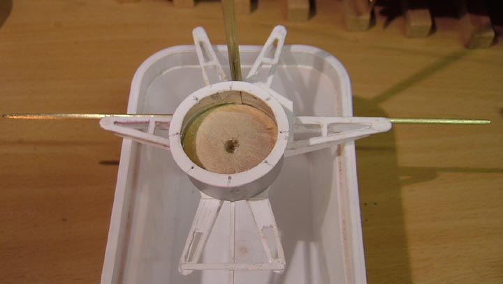

We will continue with the stack.

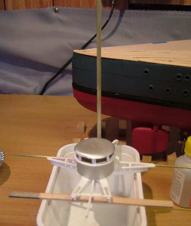

First the birds nest on the top, made out of wire and soldered.
Scribe a circle and divide it up into 8, at each point drill a hole. Then place each section in and solder.
Fitted in place.

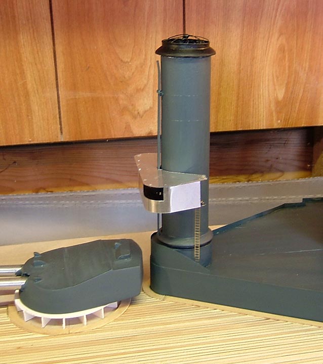

This is the floor of the search light platform, drilled ready for handrails and a quick paint, a little easier to do it at this stage, just one coat for now. Fitted in place, also p/e ladder.
A overall view of the work.

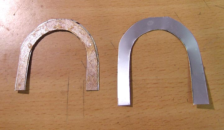

Then I cut some strips of litho and super glued them in place. Next I cut all the strengthening sections. Starting in the middle, I again super glued the oblongs in place. Then along the top and bottom.

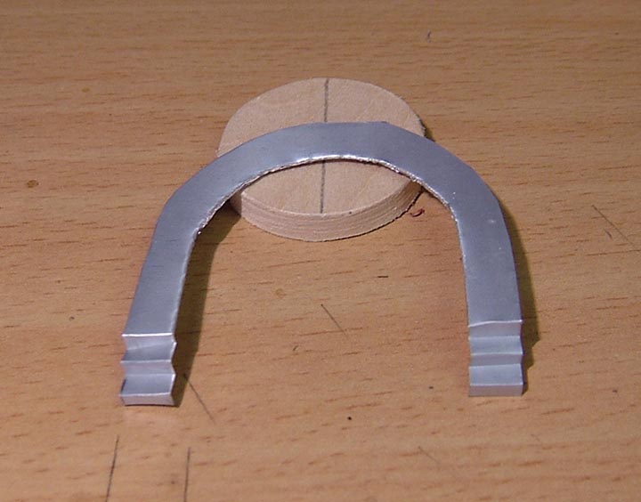

When set hard they were bent over a roll of cardboard to form the shape.

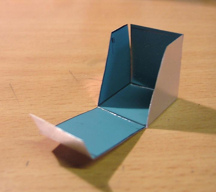

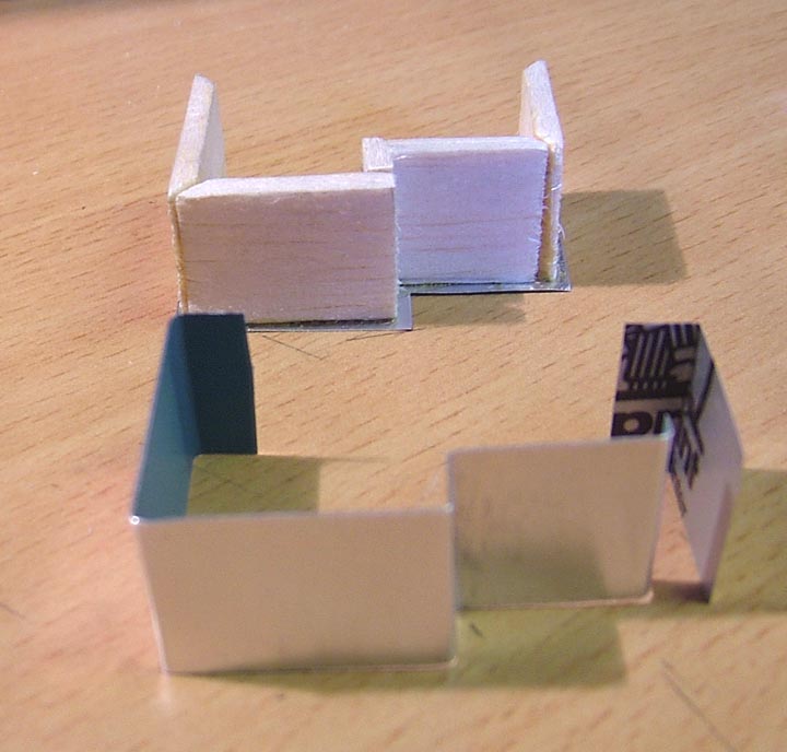

Now we come to the blacksmiths workshop. I cut out all the parts required, all measurements are doubled from my 1:192 scale drawings.

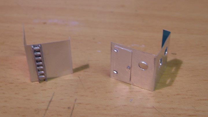

Gluing together the balsa on to my litho base. Next I bent to shape the litho to form the outside.

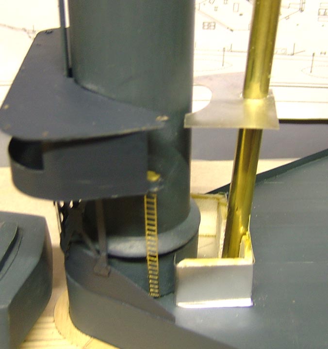

Next I drilled a hole though the roof, the base, the deck and fitted a large section of round brass.

Hi Guys, We are going to make a water tank , a walkway round the funnel and the control platform to the boat davits,
Water Tank.
First I marked out the litho plate. Then I cut it out and folded it.
Then I glued it all together, added air vents and placed in position.
Walkway.
First three U sections were cut, the two smaller ones are glued together, the third is ready to be glued in place.
All glued together and the steps formed at the bottom.

The 2 uprights to hold it in place,
How I make it in to an angle, over a square edged piece of metal.

The roof and uprights fitted.
Looking from the bow, work to date.

Hi Guys, I am going to start on the fighting tops.
This time I am using Evergreen plasticard, I first mark out the shape of the top of the supports. Then I drill in to each corner and cut out each section with a #11 blade.
Mark out for box that fits under the fighting top and glue in place.
Next mark out and drill support sections, these are then folded in half.
All sections done and glued in position.

I showed the bottom part of this last night, I have put in the supports and formed the roof, this was done out of litho plate, placed over a hollow tube and with a handle of a file rubbed it round and round till it gave the con-curved shape, it was then glued in place.

You know the old saying, we all make mistakes, :lol_3: :lol_3: well while I was looking at the drawings I noticed I had missed out a small cabin that fitted around the main tripod, :lol_3: well how do I fit it. I made it in two halves.
Then fit it round the mast, the tricky part was to get the roof on. I drilled a hole large enough to fit round the main tripod and cut though at the back and slip it round in place :jump_1: :jump_1:
The whole structure viewed from the stern
Viewed from the bow

Hi Guys, Not a lot tonight, I just want to show you some nice P/E from my friend Gordon Brooks, it is 1/96 scale ladders, but he does do smaller.
The first 2 folded and fitted in place.
Funnel removed to gain access to the back of the fighting bridge, 3 small platforms cut and glued in place, hand rails will be fitted later, also ladders fitted.
Funnel back in position and 6 ladders fitted.
Overall view of ladders, also you may notice a slight difference to the fighting top, the angle strengtheners under star fish have been trimmed to a sharper angle, all 6, I got a PM from Jim B saying they were more tampered than what mine were. So Jim I have altered them, like I told Jim, when your building a scale R/C model you have to build things stronger, because they soon get knocked and damaged, some time you have to compromise. :jump_1: :jump_1: :thumbs_up_1:
