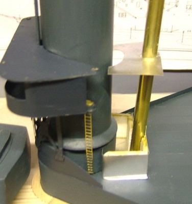

Hi Guys, We will carry on after we were so rudely interrupted, we are going to make the stanchions that hold the look out post in place. Also the blacksmiths work shop and the main derrick support.
First we mark out on a piece of wood the shape we require. Then I cut and bent at the bottom some brass, a little thicker than the litho plate.
Then I cut some strips of litho and super glued them in place. Next I cut all the strengthening sections. Starting in the middle, I again super glued the oblongs in place. Then along the top and bottom.
When set hard they were bent over a roll of cardboard to form the shape.
They were then glued in place and painted.
Now we come to the blacksmiths workshop. I cut out all the parts required, all measurements are doubled from my 1:192 scale drawings.
Gluing together the balsa on to my litho base. Next I bent to shape the litho to form the outside.
The structure placed in position.
Next I drilled a hole though the roof, the base, the deck and fitted a large section of round brass.
This is the main upright for the boat cranes, you can see it in the background on the drawings.
enjoy, ARH :wave_1: :wave_1: :thumbs_up_1:

Hi Guys, Not a lot tonight, I just want to show you some nice P/E from my friend Gordon Brooks, it is 1/96 scale ladders, but he does do smaller.
The first 2 folded and fitted in place.
Funnel removed to gain access to the back of the fighting bridge, 3 small platforms cut and glued in place, hand rails will be fitted later, also ladders fitted.
Funnel back in position and 6 ladders fitted.
Overall view of ladders, also you may notice a slight difference to the fighting top, the angle strengtheners under star fish have been trimmed to a sharper angle, all 6, I got a PM from Jim B saying they were more tampered than what mine were. So Jim I have altered them, like I told Jim, when your building a scale R/C model you have to build things stronger, because they soon get knocked and damaged, some time you have to compromise. :jump_1: :jump_1: :thumbs_up_1:
