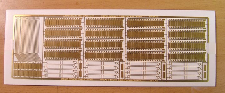

djronbxs wrote:
hi,
what filla paste do you use ?
This is what I use.
ARH :wave_1: :wave_1: :thumbs_up_1:
Simple but effective.

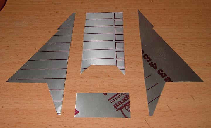

We are having a change tonight from planking, on ID we have some metal decks, I never like just painting over ply or plastic, I like to plate my decks, some times with cardboard but this time a new technique with the litho plate,
Looking like batman, this is the deck pattern of the rear superstructure when cut out, it is turned over and marked off like 8ft x 4ft sheets of steel, then it is scribed on the back lightly.
Next it is glued down using contact adhesive.
Combings are cut round the edge, at the back of the turret I have shown some riveting.

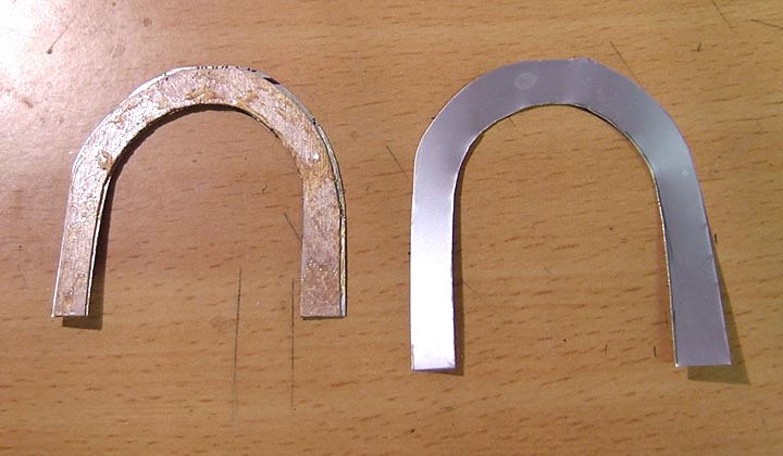

Cut from litho plate and shaped round , this fits inside the ring on top.
Fitted in place.

First I marked out the litho plate. Then I cut it out and folded it.

First three U sections were cut, the two smaller ones are glued together, the third is ready to be glued in place.

Hi Guys, Not a lot tonight, I just want to show you some nice P/E from my friend Gordon Brooks, it is 1/96 scale ladders, but he does do smaller.
