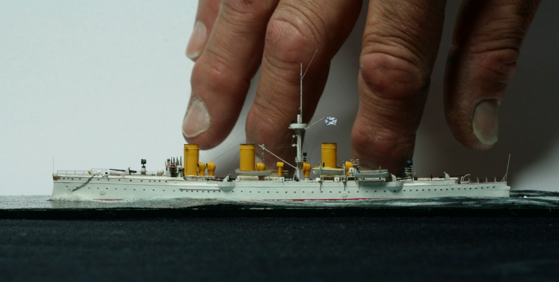

with Novik now finished....
I now intend finishing her Russian built sistership Zhemchug
