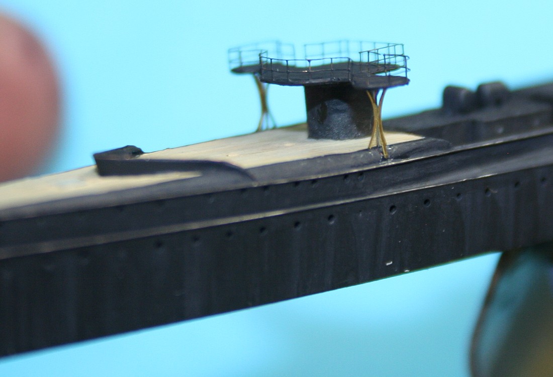

Zhemchug had an unusual bridge wing support arrangement--quite different from Novik.
This was made using curved pieces of longitudinal pieces of 1/350 PE railing
The strips curved aft, fwd and outboard ( as far as I could ascertain from photos !)
