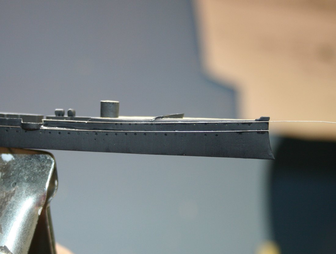

Making progress....
The strakes have been added of nickel silver wire- this took quite few attempts to prevent buckling and kinks...
tacked at each end--glue drawn along the strakes with a section of stretched sprue as the glue carrier
