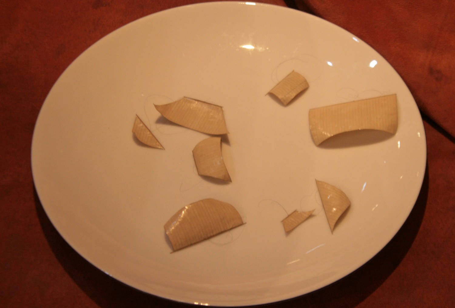

anyhow-- have also made another set of sails --this time using 2 mm seam spacing
Have cut and moulded these in the oven as before
and I have been gluing 0.1 mm copper wire ( butt edge to edge join! to the paper ) around 3 sides to simulate the boltropes
but also because that way I can shape the leeches to orientate correctly to sheet tension and direction.
It also holds the shape permanently !
The sail attached to teh yard is the lower foresail,
is are shown here BEFORE painting
( I shall be using watercolours --hence I have sealed the paper with varnish)
we shall see if the layers of thin paint will degrade the harshness of the seams and give a softer feel
will report in soon :big_grin:

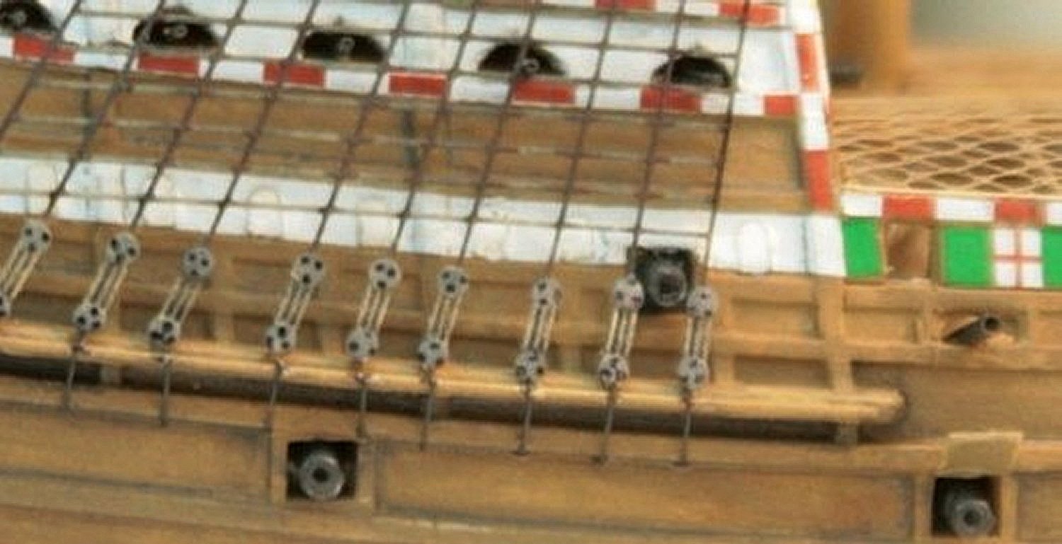

inevitably... I had to try out the netting in action on the ship
i have only applied half -
so that I can still place some rope coils on the belaying benches at the mast baes
( coils are in build now )
along with the coiled tails of the halyard braces and the sail braces
anyhow
herewith some pics of the much discussed and fabled antiboarding netting
and some of the ratlines port side--
The ratlines were quite tricky to get aligned to allow the footropes to be horizontal
The AOTS book shows the footropes to be inclined--but I have yet to see any ratlines with the footropes at an angle on any ship
The netting was glued on with tiny bits of CA, the nylon or polyester based mesh being quite recalcitrant to my
gluing endeavours...
Once installed the outer cut edges were covered up with thin pieces of stretched brown sprue that hid the raw edges

the mesh--was dyed in a really really( almost treacly!) strong mix of instant coffee, as neither tea of other dyes would touch it!!
I ' fixed' the dye ( hopefully ) in a bath of vinegar ) -- useful that Katrin's kitchen is well stocked !
Before adding more mesh...(!) I added rope coils at all masts on the belaying rails at the bases of the masts, as well as some rope coils on the waist deck and foc'sle
These wree made by winding thin beige thread around cocktail sticks 5 turns at a time, covering in white glue to soak and then wiping away excess.
Once set I slipped the off the cocktail stics, cut, shaped and applied!
Cutting the mesh with scissors ( sharp new Fiskars orange handles needlework long blade) was very successful, the cut edges were crisp and accurate,
however so as to prevent distortion of the netting whilst cutting I sandwiched the mesh in between the tacky part of a post-it note
and my template( made using the tacky part of the post-it note.
This meant that the open edges of the mesh were supported whilst cutting and template removal, without distortion
Once glued in place using minute amounts of glue applied on the end of a piece of copper wire, I covered the raw edges with pieces of stretched brown sprue .
This gave a crisp outline and a welcome bit of contrast in brown and beige
==> result was satisfactory!

PostPosted: Tue Jan 31, 2017 6:41 pm
Posts: 5558
....All day I have had a feeling that something was wrong with my model....
bothersome...
Eureka! :big_grin:
I had ' dotted' almost all my deadyees incorrectly-- :doh_1: :doh_1:
a quick repaint this evening and tomorrow I shall 'dot' the correct way round.
==> Moral of the story..-- do not rely on what one thinks one knows.... :big_grin:
the correct way is a below

PostPosted: Wed Feb 01, 2017 8:32 am
Joined: Thu Dec 18, 2014 7:58 am
Posts: 155
Location: Oslo, Norway
Ah, yes, I was just about to point out that your deadeyes were upside down but you beat me to it :)
As for woolding, it was used to keep the various bits that a "made mast" consisted of together. A made mast was a mast that was assembled from smaller pieces of timber, made necessary as A) masts got thicker and taller and B) all the really thick and tall trees were chopped down. Whether the Mary Rose would have had made masts or not is anybody's guess really - it's not inconceivable that big enough trees were still available at the time. Or not. Anyway, I see you have confined yourself to doing woolding on the main and fore lower masts, which is perfectly correct.
The "banding" that you refer to which connects the upper end of the lower mast to the topmast was actually a rather massive lump of wood, the "cap", normally a more or less brick-shaped piece with one, often square, hole for the top of the lower mast and another, round, hole for the topmast.
