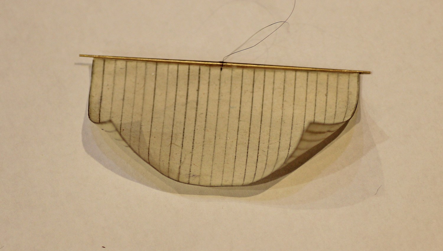

anyhow-- have also made another set of sails --this time using 2 mm seam spacing
Have cut and moulded these in the oven as before
and I have been gluing 0.1 mm copper wire ( butt edge to edge join! to the paper ) around 3 sides to simulate the boltropes
but also because that way I can shape the leeches to orientate correctly to sheet tension and direction.
It also holds the shape permanently !
The sail attached to teh yard is the lower foresail,
is are shown here BEFORE painting
( I shall be using watercolours --hence I have sealed the paper with varnish)
we shall see if the layers of thin paint will degrade the harshness of the seams and give a softer feel
will report in soon :big_grin:

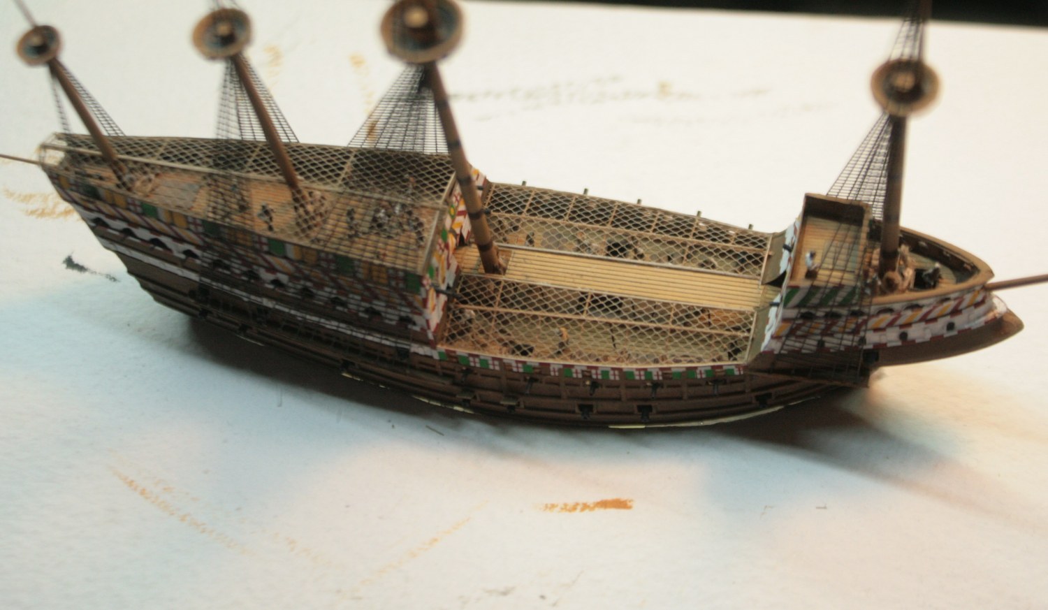

inevitably... I had to try out the netting in action on the ship
i have only applied half -
so that I can still place some rope coils on the belaying benches at the mast baes
( coils are in build now )
along with the coiled tails of the halyard braces and the sail braces
anyhow

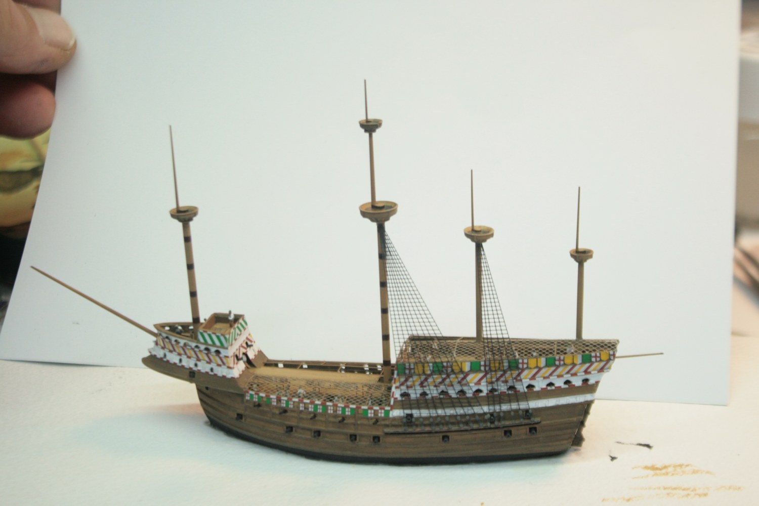

herewith some pics of the much discussed and fabled antiboarding netting
and some of the ratlines port side--
The ratlines were quite tricky to get aligned to allow the footropes to be horizontal
The AOTS book shows the footropes to be inclined--but I have yet to see any ratlines with the footropes at an angle on any ship
The netting was glued on with tiny bits of CA, the nylon or polyester based mesh being quite recalcitrant to my
gluing endeavours...
Once installed the outer cut edges were covered up with thin pieces of stretched brown sprue that hid the raw edges

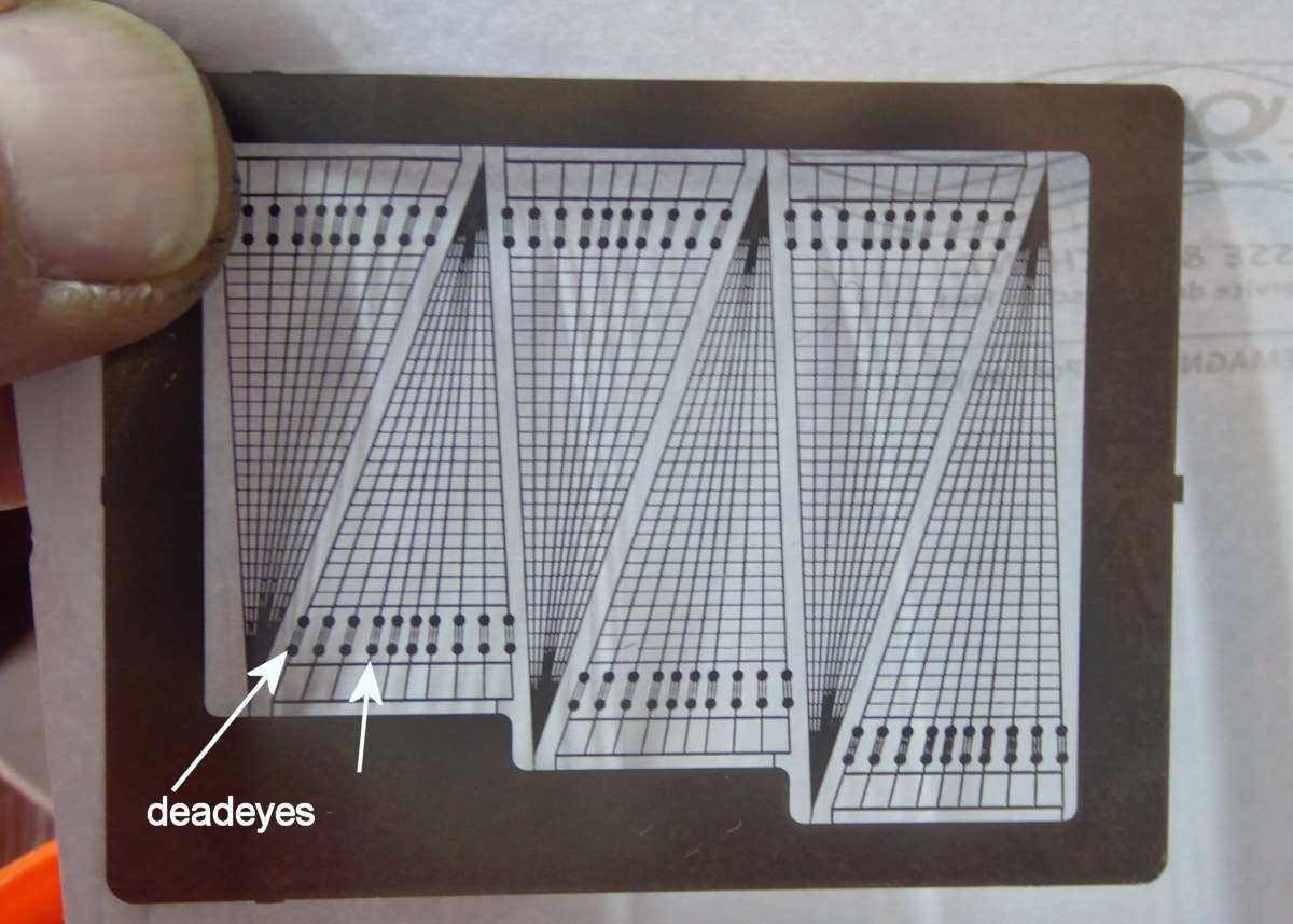

The Scale Warship ratlines were OK-- but I felt that the dead-eyes were a bit spindly for my linking
so I cut some more substantial deadeyes of a 1/600 "Saemann" set (from Germany
which looked more in keeping to my ideas
The overall end effect is better-
-I intend to add the dots and lashing ends with a fine Rotring pen

the mesh--was dyed in a really really( almost treacly!) strong mix of instant coffee, as neither tea of other dyes would touch it!!
I ' fixed' the dye ( hopefully ) in a bath of vinegar ) -- useful that Katrin's kitchen is well stocked !
Before adding more mesh...(!) I added rope coils at all masts on the belaying rails at the bases of the masts, as well as some rope coils on the waist deck and foc'sle
These wree made by winding thin beige thread around cocktail sticks 5 turns at a time, covering in white glue to soak and then wiping away excess.
Once set I slipped the off the cocktail stics, cut, shaped and applied!
Cutting the mesh with scissors ( sharp new Fiskars orange handles needlework long blade) was very successful, the cut edges were crisp and accurate,
however so as to prevent distortion of the netting whilst cutting I sandwiched the mesh in between the tacky part of a post-it note
and my template( made using the tacky part of the post-it note.
This meant that the open edges of the mesh were supported whilst cutting and template removal, without distortion
Once glued in place using minute amounts of glue applied on the end of a piece of copper wire, I covered the raw edges with pieces of stretched brown sprue .
This gave a crisp outline and a welcome bit of contrast in brown and beige
==> result was satisfactory!

afterwards I completed the installation of the ratlines, these were generally ok--though suspect my mast positions may have been out a wee bit.
It is unfortunate that the horizontal foot-ropes are etched the same diameter as the vertical shrouds,
I endeavoured to disguise this somewhat-not completely successful alas-- by dry-brushing the foot-ropes from above downwards only in a lighter brown
The channels ( shelf!) that form the bottom of the ratlines are alas a bit clunky on the kit moulding ( note to self--assume nothing! )
-I mitigated this by gluing on a piece of brass wire --this reduced the visual impact a bit...
The deadeye lashings--which I used from the an old Saemann PE set -- were all added., blocks painted on a lighter wood, individual
lashings lightly drybrushed and the 'eyes' marked in with a Rotring pen- this required quitea few gos at times as the deadyes are very small and it was not always perfect first time !!

For the dead-eyes, I gather, one could use paper discs on which short strands of (twisted) wires are glued. The volume of the dead-eye is made up with blobs of white glue. I believe McNarry is using a method like this.
For cutting in the rigging I am using eye-surgery micro-scissors. I got mine from a stand on a flea-market that sold 'seconds' of medical tools, but I think today they can be obtained quite easily via ebay. They come in different sizes and in an either curved or straight variety.
Eberhard
