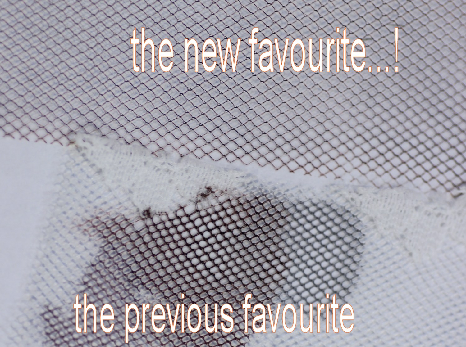

" our " HMS Victory man Dafi.... really very kindly indeed sent me some of his netting.
now coming from him of course--he being the "�ber-stickler" for precise detail...
obviously then.... it is a nice diagonal weave and is woven of satisfyingly thin thread lines ,
so that really is unarguable with, to this netting now not being the preferred netting for my model of HMS Mary Rose-
-allowing a view of the decks whilst being ' netted' !
a MONSTER enlargement comparative photo of the 'old' and the ' new' below....===> I think my mind is now made up!
DANKE !!
DANKE !!
