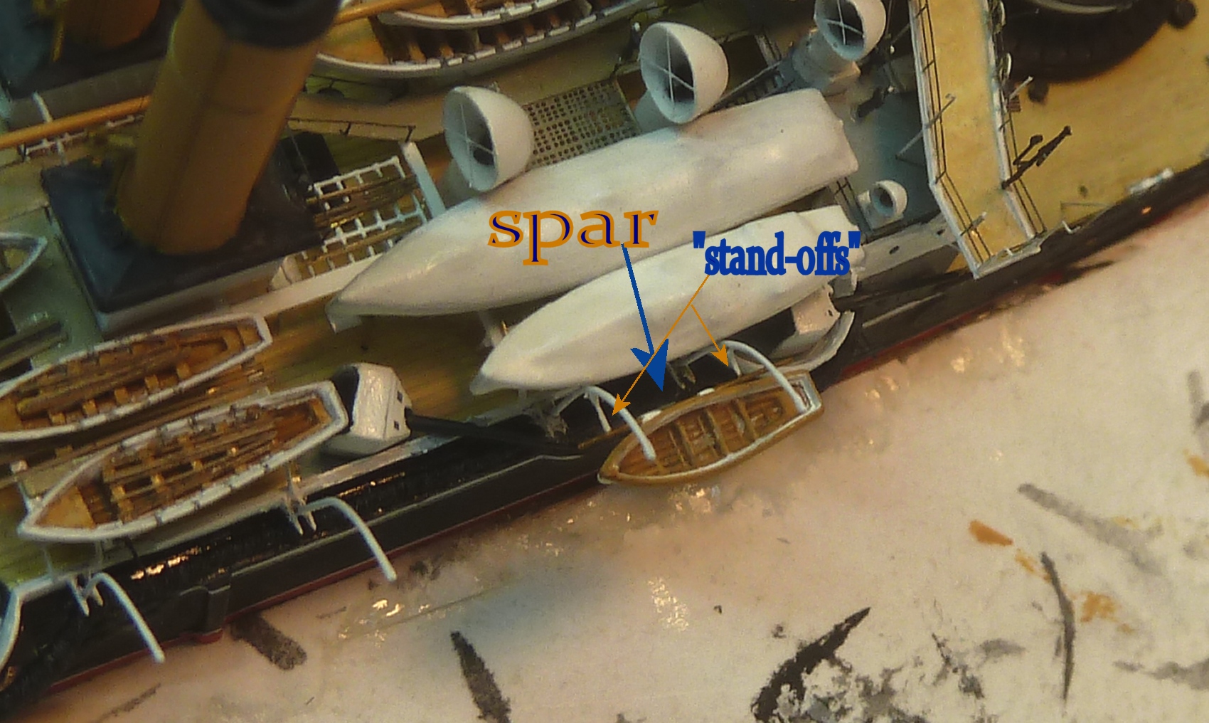

Ships boats that were suspended outboard on davits often( but not always) had a " griping" (sp /) spar to which the boat was strapped
against canvas/ rope covered pads
arrowed below
These spars had" stand-offs" in a vertical " V " so that boat would be suspended below the end of the davit concentrically
Making these to scale in 1/700 and not clunky and overscale whilst retaining structural strength was potentially tricky (!!)
so I err... simplified.
Uisng 1/350 hand-railing of appropriate width for correct distance davit spacing I cut some spars integral with stand-offs
Once painted by brush they took on a more circular shape, canvas pads were added with blobs of white paint
( note that in hood these spars varied from natural timber to painted white from year to year !!

The real ship had the boast suspened by ots block and tackles
I took the short cut of gluing the boat to the spar and will be adding the block and tackles afterwards
The full complements of boats is now in place
