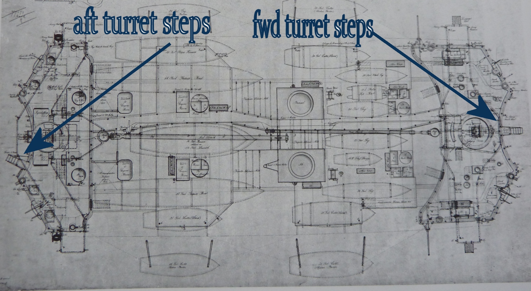

gentlemen...I made an error in an earlier update when I said the Burt book contained shipbuilders original drawings of this HMS Hood
the ( new edition) of the Burt book indeed does have good drawings --and some excellent resolution double-page photos
.....but the most excellent admiralty drawings referred to ( which answer sooo many mysteries!) of many RN pre-dreadnoughts
are to be found in this newly published very worthy volume by Norman Friedman
--an excellent ( must -have!) buy for any pre-dreadnought RN fan!

the location of the turrets access steps can be gleaned from some of these ( excerpts of ) drawings at very usable res too!

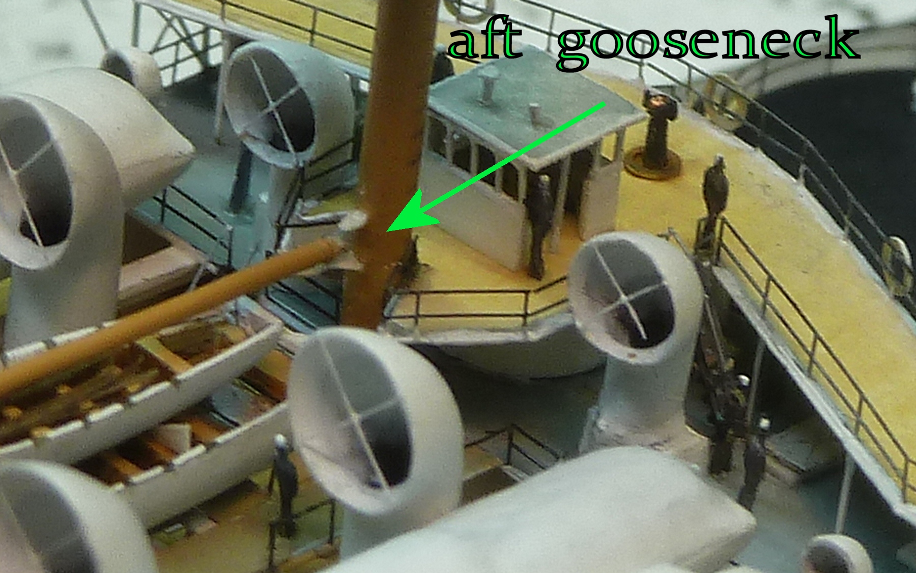

I made and installed the 2 x large boat booms--which overlap off-set midships on the cradles fwd / aft of the funnels
I spent some time trying to replicate the goose-neck end of these spars-- making the plates of thin paper attached with thinned varnish and backfilled with a drop of CA
I also made and installed the 3" Q/F gun carriage tracks of wire for the fwd and aft fighting tops
-- sprung around the mast at the wire circle split and sealed in place with matt varnish and a drop of CA

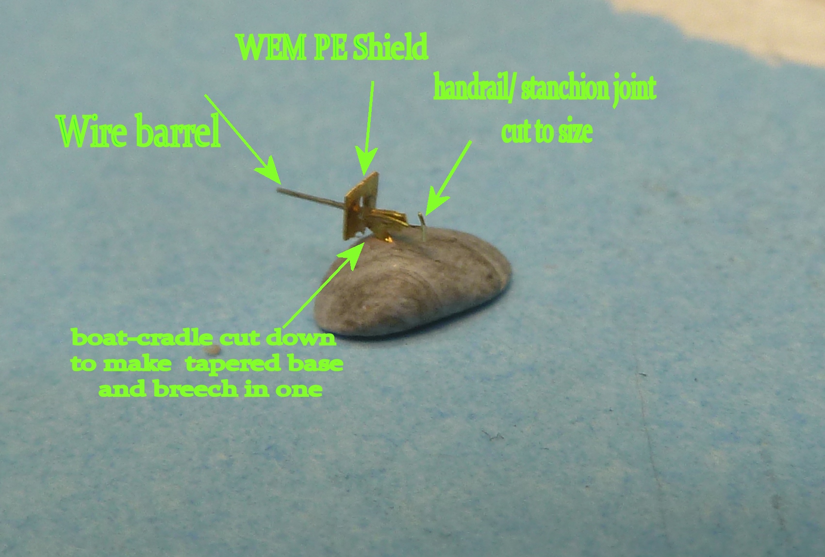

The aforementioned Q/F tracks need some carriages...
I made these by bending some boat cradles from my brass stash ( spare Henri iV Combrig PE )
they are very small-(!!! :smallsmile: ) - but add a bit of interest to otherwise dull insides of fighting tops
installing the Q/F guns was challenging, insofar as getting them over the rails... and under the deck ....
without damage to gun or rail... ( !!! ):Mad_5: :Mad_6: :mad_2: :censored_2:

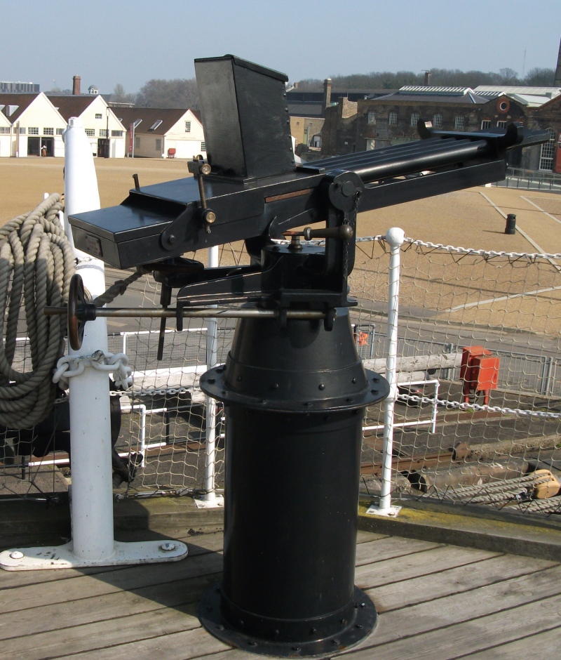

Rather harder were the Nordenfelt 1" machine guns
the real thing came in various sizes with barrel fitments ranging from 4 to 10 barrels.
They could fire 600 rpm (!) and were supplied with ammunition from the vertical hopper toward the mid rear
Fortunately the four guns on Hood had shields in the photos I had -phew!
-allowing me to simplify and not construct all the really hard bits !!!

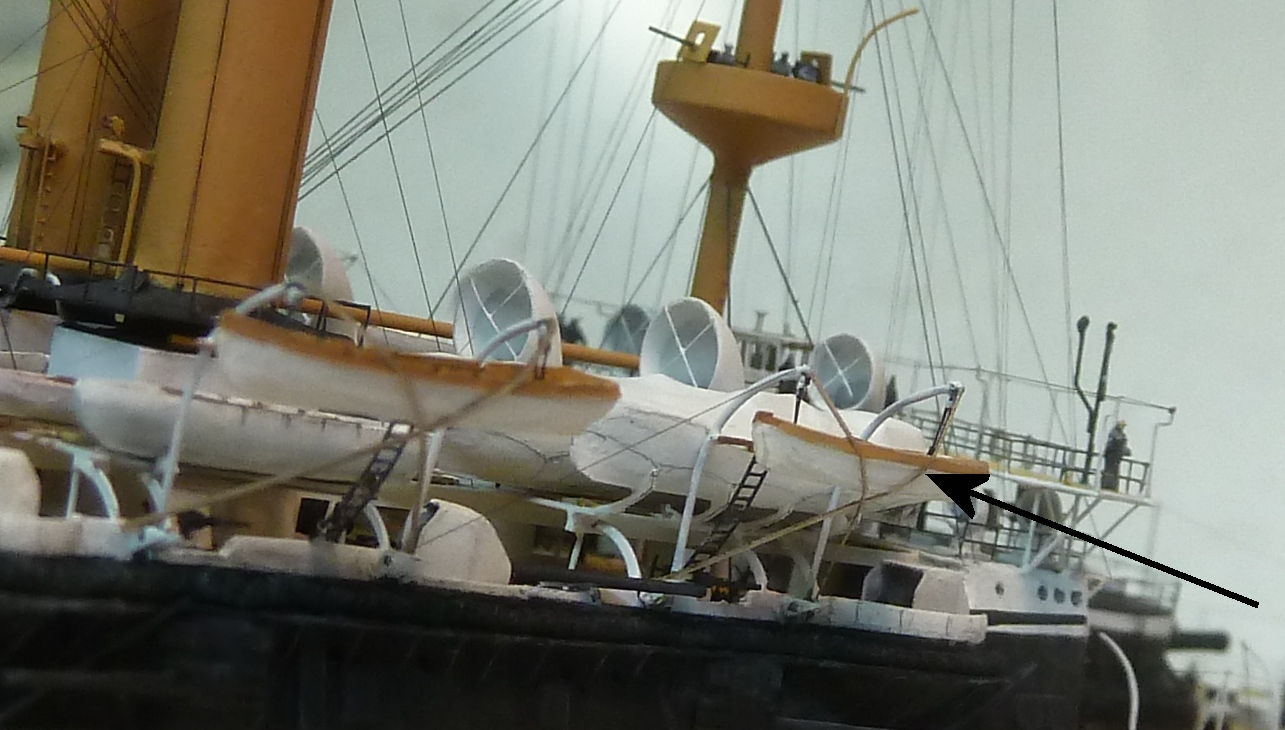

Ships boats that were suspended outboard on davits often( but not always) had a " griping" (sp /) spar to which the boat was strapped
against canvas/ rope covered pads
arrowed below
These spars had" stand-offs" in a vertical " V " so that boat would be suspended below the end of the davit concentrically
Making these to scale in 1/700 and not clunky and overscale whilst retaining structural strength was potentially tricky (!!)
so I err... simplified.
Uisng 1/350 hand-railing of appropriate width for correct distance davit spacing I cut some spars integral with stand-offs
Once painted by brush they took on a more circular shape, canvas pads were added with blobs of white paint
( note that in hood these spars varied from natural timber to painted white from year to year !!

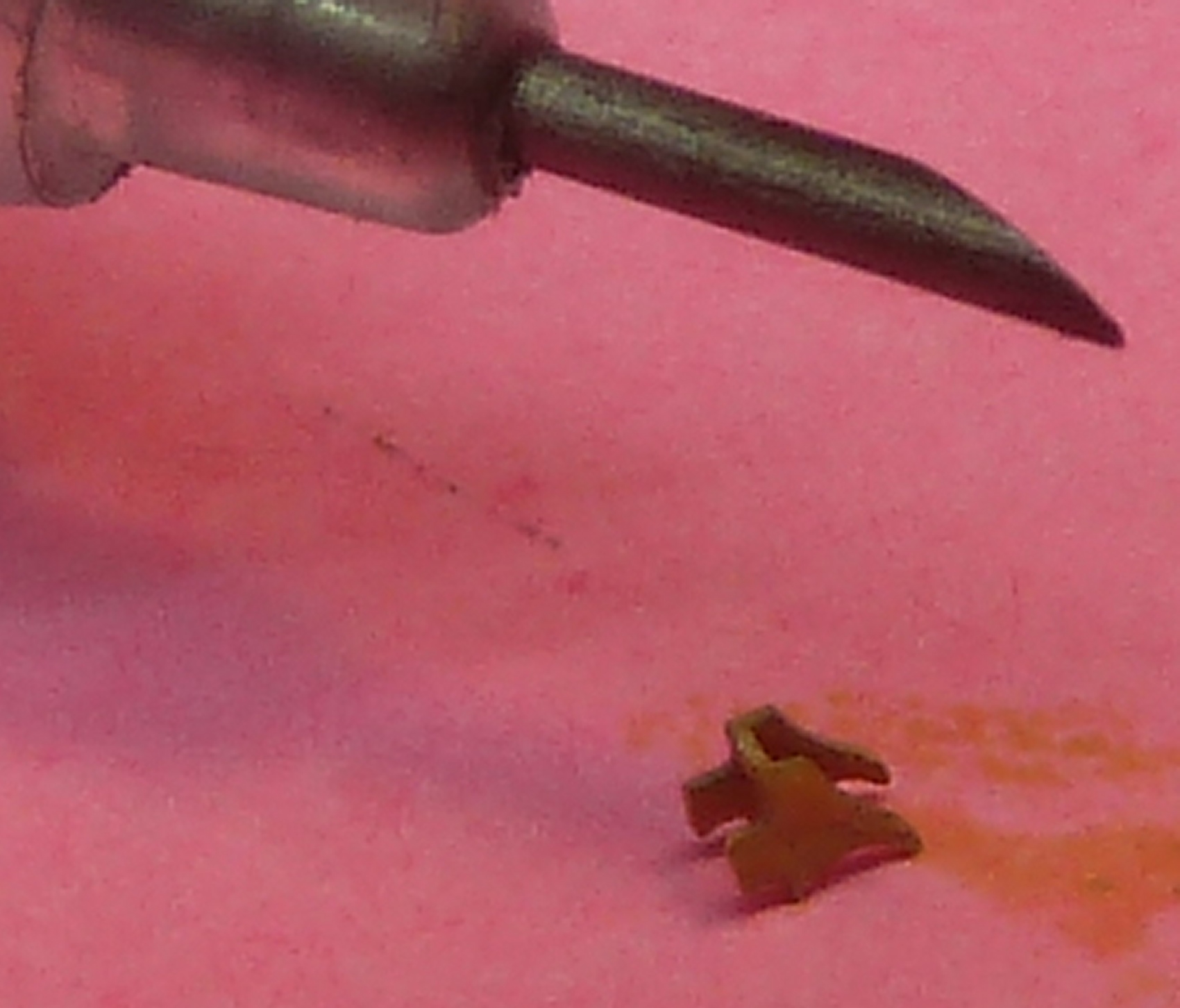

I had to paint them
I used Tamiya gold and contrived to stand the painted letters on end with the paintbrush so aid drying and removal from post -it-note
They were attached onto clear varnish ( on the end of a moistened cocktail stick) and then washed gently with thin black to dull down a bit
end result is alas a wee bit over scale...( !!) but the look is -I think satisfactory
and better than not at all

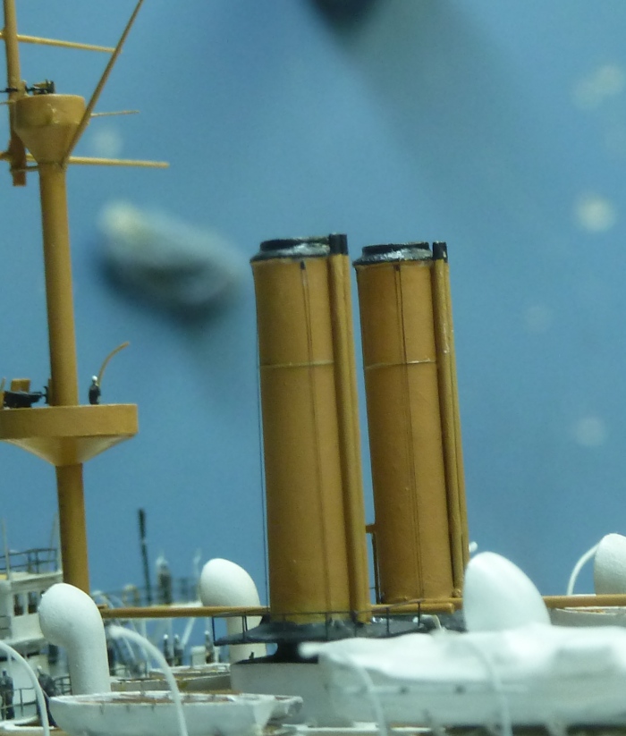

the first thing that I did was to install the painting 'chains'
( these would be substituted for hemp ropes when funnel painting/ cleaning--but thin chains were roved through the pulleys when not is use as the hemp ripe would rot with potentially disastrous consequences!

The ships boats slung outboard had canvas straps-- these were made of ' flat'-stretched sprue in brown plastic
The advantage is that one can -by softening the stretched sprue with liquid cement--
get the sprue " canvas " straps to follow the ' kinks and angles of the boats
to give them a taut look-
(alas -often these straps on models look too loose / and sagging ==> - and therefore not fulfilling their function. )

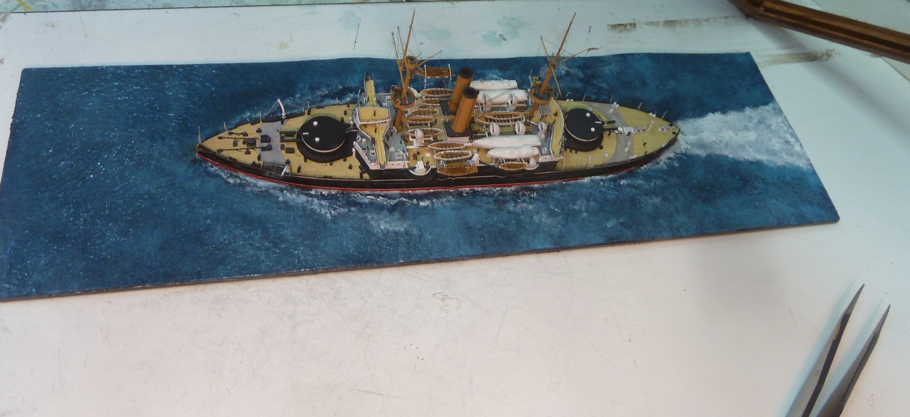

The firs coast of wet-on-wet sea paint have gone on
more coats and layer today hopefully
:wave_1: :wave_1: JB

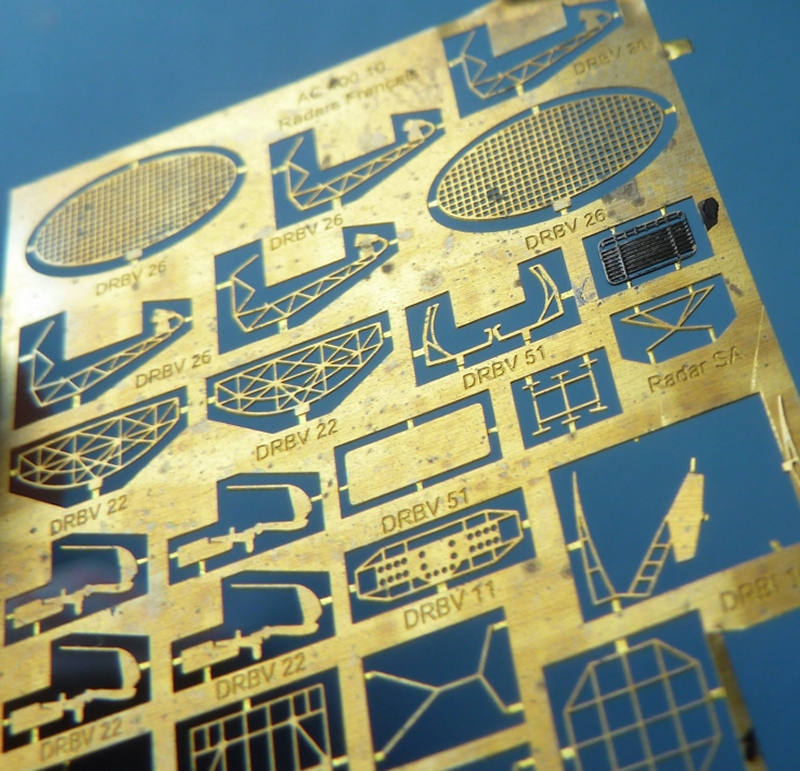

One thing that has puzzled me for a long time, Jim, is the stacks of PE frets you must have. How the heck do you find anything in them - and why does one have these stacks of them, they are not cheap ... ?
The one, who struggles just with a few internal struts in a funnel at 1:160 scale only ... :scratch:
Eberhard

hahah! its a relic of my somewhat less discriminate buying pattern over the last 25 years... :cool_2: :cool_2:
and whilst modern PE frets for large 1/350 projects ARE expensive per se
my stock--albeit considerable ( !) was monetarily much less than nowadays
and in any case-pro-rata --- brass is much cheaper than beer or petrol !
...==> that is how I sell it to myself!
Much of the OLD( 1990's :big_grin: ) PE is unusable for ' modern' / ' fine' modelling
BUT can supply the raw material for a number different aspects of re purposing
( awning stanchions from handrail, aircraft wheels for pulleys-- even the lettering .
Much old girder work PE can be reused
etc etc
