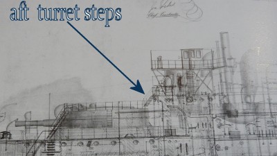

in the meantime

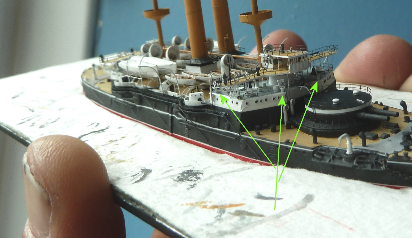

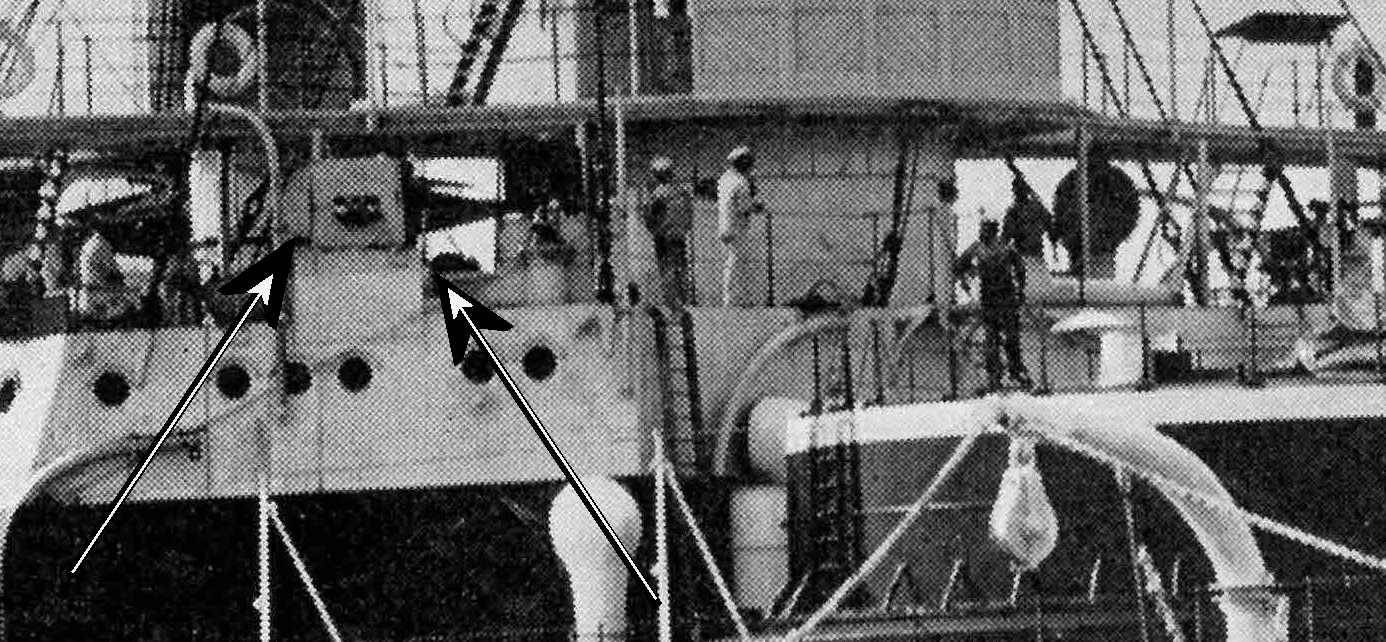

the location of the turrets access steps can be gleaned from some of these ( excerpts of ) drawings at very usable res too!

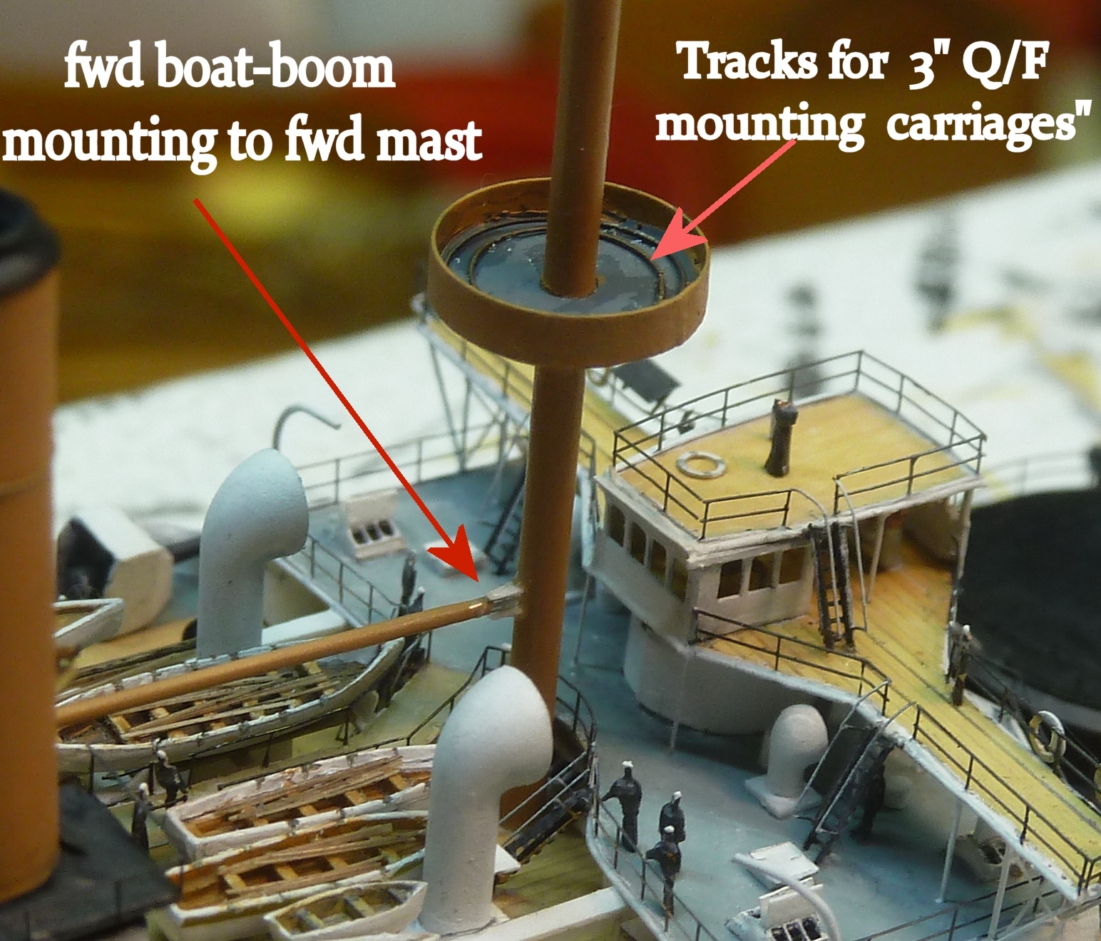

I made and installed the 2 x large boat booms--which overlap off-set midships on the cradles fwd / aft of the funnels
I spent some time trying to replicate the goose-neck end of these spars-- making the plates of thin paper attached with thinned varnish and backfilled with a drop of CA
I also made and installed the 3" Q/F gun carriage tracks of wire for the fwd and aft fighting tops
-- sprung around the mast at the wire circle split and sealed in place with matt varnish and a drop of CA

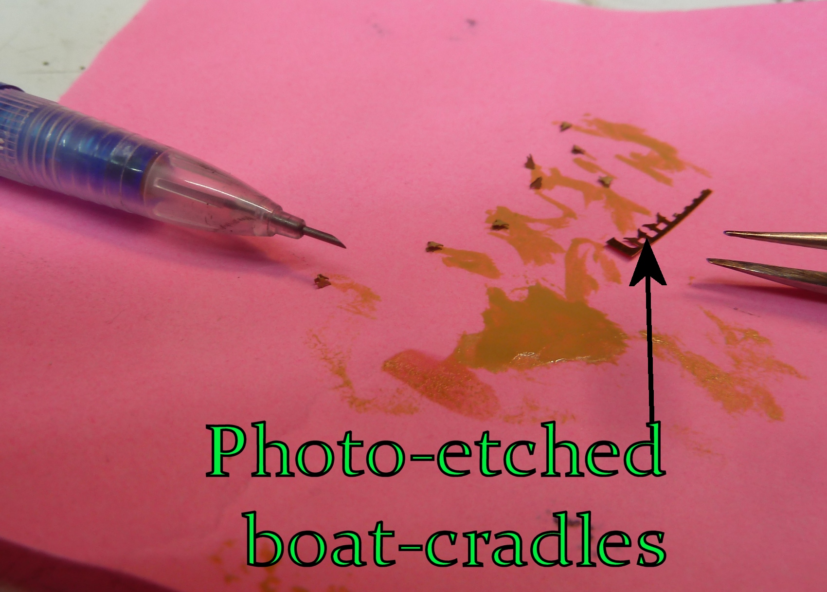

I made these by bending some boat cradles from my brass stash ( spare Henri iV Combrig PE )
they are very small-(!!! :smallsmile: ) - but add a bit of interest to otherwise dull insides of fighting tops

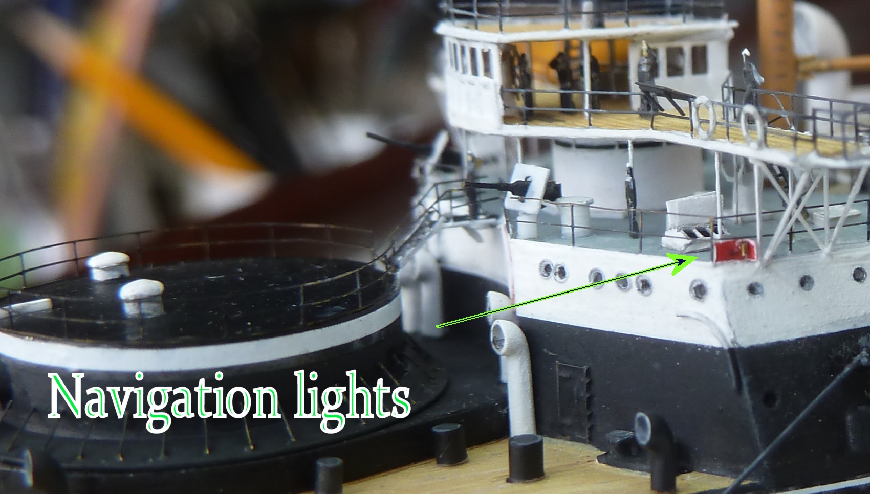

I added the navigation lights , small strip of paper with a 90 degree bend and with a piece of brass rod for the lantern

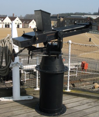

The shoulder pad / aiming ladder crutch on the left side of the gun
( this can also be central and of various shaes and configurations..)
( which on the real thing in 1/1 scale looks a bit like this...

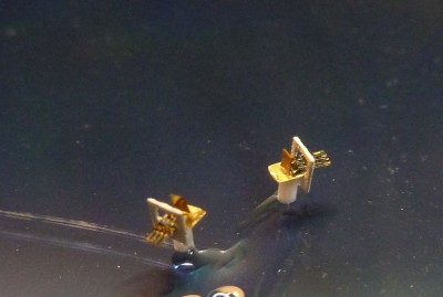

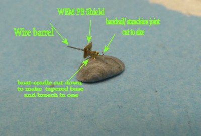

in 1/350 I managed this
in 1/700 I had to simplify-as I could barely see it and certainly could not manipulate it accurately
( WEM handrail cut as per image )

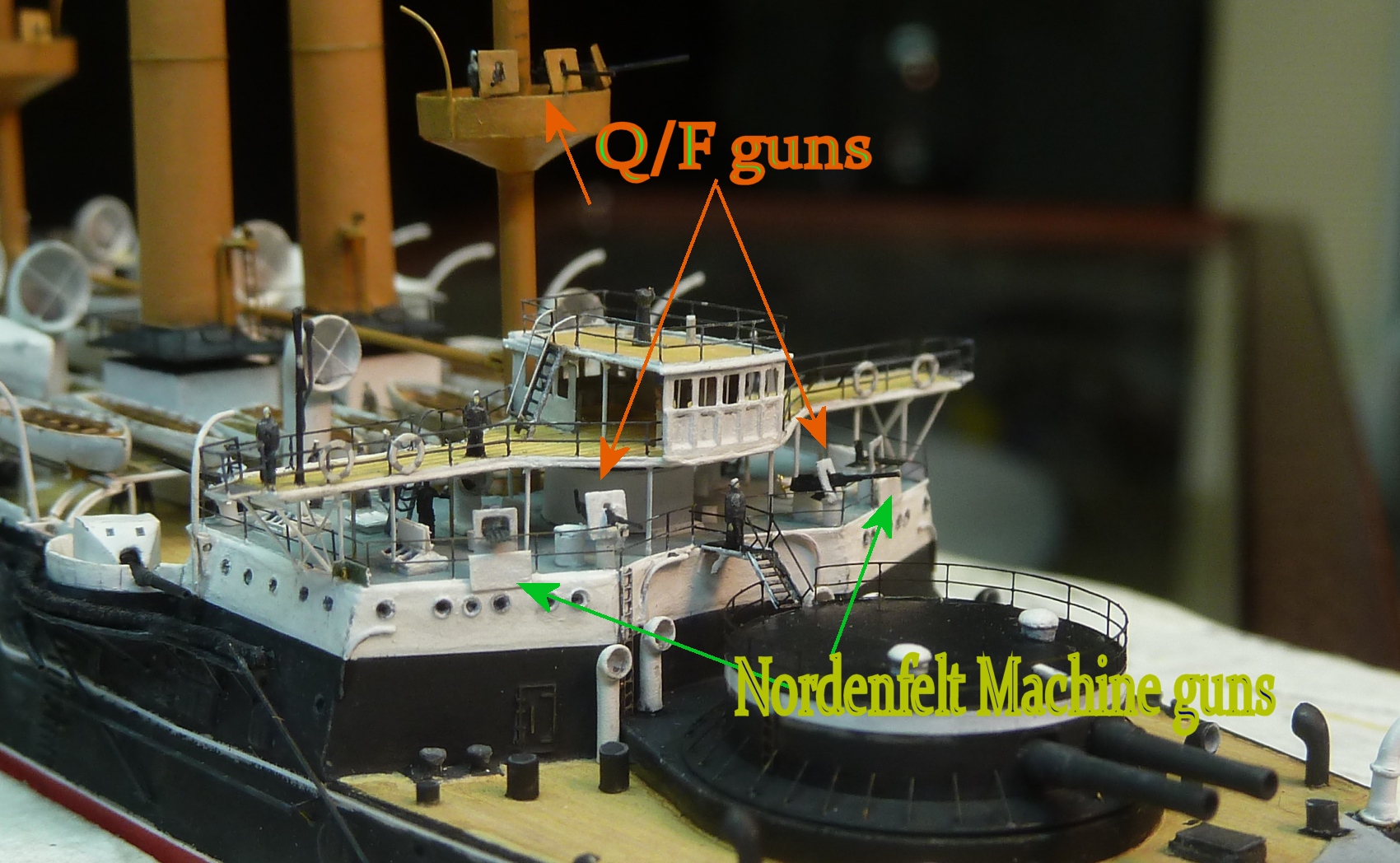

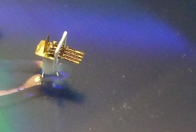

Rather harder were the Nordenfelt 1" machine guns
the real thing came in various sizes with barrel fitments ranging from 4 to 10 barrels.
They could fire 600 rpm (!) and were supplied with ammunition from the vertical hopper toward the mid rear
Fortunately the four guns on Hood had shields in the photos I had -phew!
-allowing me to simplify and not construct all the really hard bits !!!

I selected a piece of elderly PE( :L'arsenal PE ?)

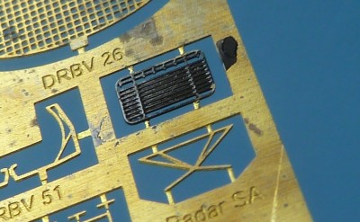

that usefully had what I needed-- etched corrugations top and bottom
These would make the barrels....
the PE shields ( Unknown source ) would hide the rest :smallsmile: :cool_2:
Installed they sort of look passably like the real thing in the photos

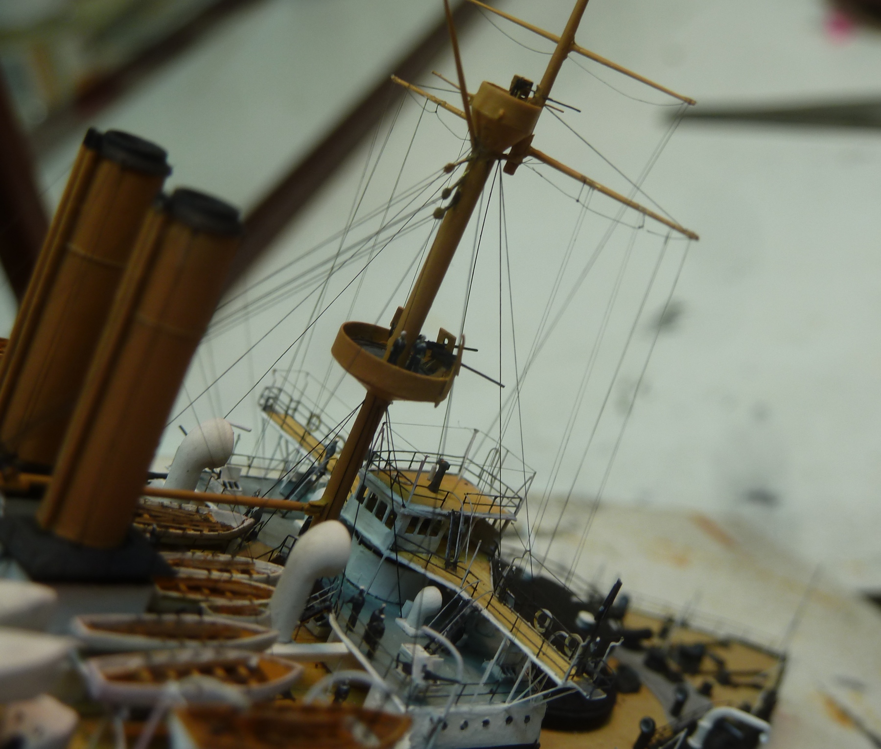

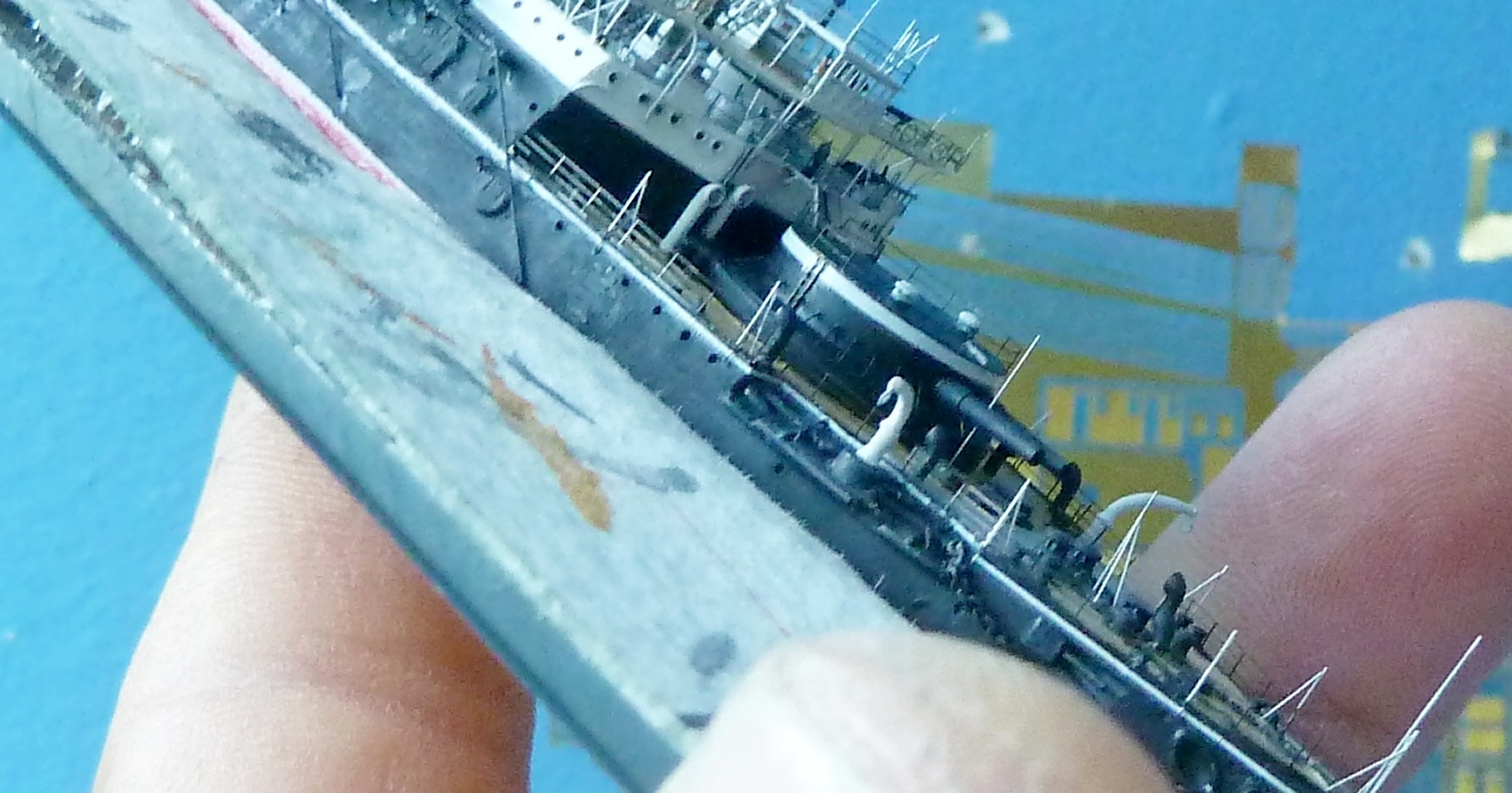

after fitting ( surprisingly arduously) the deck edge railing of very thin (over-etched :thumbs_up_1: ==> makes thiner still )
WEM ultra fine PE and gently depressing some- but not all - of the wire spans to give a gentle droop( as per original photos)
I turned my attention to the awning supporting poles
Hood being Mediterranean based was fitted with a vast amount of sun-awning supporting stanchions, dece eged as well a down the centre-line
these were made from 1/350 P E handrail longitudinals -
that way consistency in size of the material is guaranteed
cutting them from the handrail means that visual measurement is easy when judging cutting between the stanchions to give consistency
Each deck-edge stanchion--whilst mounted in cantilever mountings outboard of the rail -
-nevertheless had a tall supporting strut inboard also!
the same also on the aft deck

Uisng 1/350 hand-railing of appropriate width for correct distance davit spacing I cut some spars integral with stand-offs
Once painted by brush they took on a more circular shape, canvas pads were added with blobs of white paint
( note that in hood these spars varied from natural timber to painted white from year to year !!

I searched all my old PE stash but did not have a second old fret
from an old IJN cruiser GMM set of similar vintage.... in stainless steel there were also more etched thru bits of lettering;
These were slightly smaller still and easier to cut being attached only one side-( so I thought )-but the springy stainless steel
made it hard work , and many letters pinged thru the air--despite being cut inside a plastic bag !!! eh..?!
and H's on that fret were precious ( plenty of O's and even a few smattering D's !!)
once these were cut and retrieved successfully...
I had to paint them
I used Tamiya gold and contrived to stand the painted letters on end with the paintbrush so aid drying and removal from post -it-note
They were attached onto clear varnish ( on the end of a moistened cocktail stick) and then washed gently with thin black to dull down a bit
end result is alas a wee bit over scale...( !!) but the look is -I think satisfactory
and better than not at all

The rig is now completed...--phew!
intense and careful study of the photos available eventually revealed where the bracing lines for the yards went
aft- it was -sailing ship style to the gaff-- was a ' discovery !

fwd ...-- the yard braces went to the upper fighting top.
All the sun awning rigging was done around the perimeter as well on the bridges and fwd and aft supports
