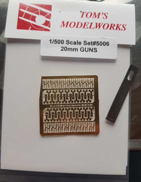

bought 1/500 railings, US radars...and 20mm oerlikon from tom's model

the 20mm..I bought the 1/500 PE from WEM...need to build one before I stick to them or buy the 3D model ones

did 1 PE 20 mm gun...pictures in order
how they are packed
gun vs finger to see size
the stand bend 3 times...and glued
on the ship vs kitgun

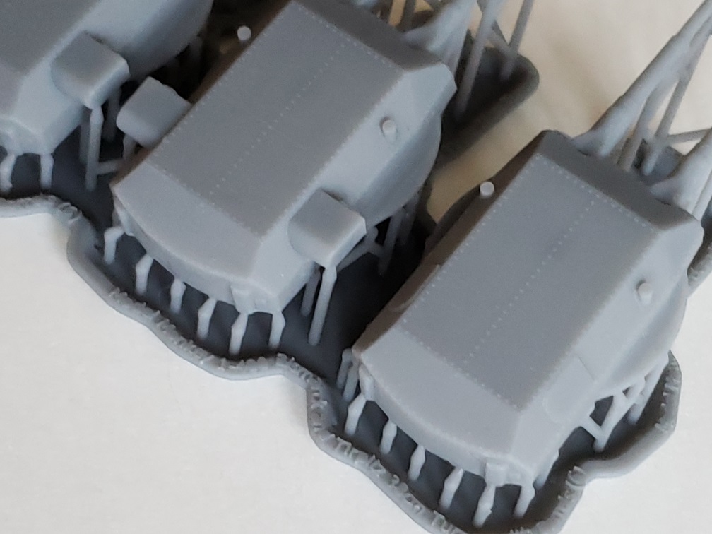

5"/38 cal. Mk.28 and Mk.37 Directors, "Angle-back" from Model Monkey 3D-printing...also bought the 1/400 Bismarck main guns with blast bag...have that one ...and Tirpitz in waiting for the make.
that way I can see difference and decide if I go for more 3D printed stuff...
Shipped today! Thank you!
Here they are, the actual products you will be receiving.
Model Monkey 1-535 Mk.37 Directors angle-back a.jpg [ 137.76 KiB | Viewed 1838 times ]
Model Monkey 1-535 Mk.37 Directors angle-back b.jpg [ 129.18 KiB | Viewed 1838 times ]
Model Monkey 1-400 Bismarck and Tirpitz 38 cm Turrets a.jpg [ 161.32 KiB | Viewed 1838 times ]
Model Monkey 1-400 Bismarck and Tirpitz 38 cm Turrets b.jpg [ 185.82 KiB | Viewed 1838 times ]
Model Monkey 1-400 Bismarck and Tirpitz 38 cm Turrets c.jpg [ 176.33 KiB | Viewed 1838 times ]
Model Monkey 1-400 Bismarck and Tirpitz 38 cm Turrets d.jpg [ 149.22 KiB | Viewed 1838 times ]
Model Monkey 1-400 Bismarck and Tirpitz 38 cm Turrets e.jpg [ 170.29 KiB | Viewed 1838 times ]
Have fun, Monkey around.™
PostPosted: Mon Nov 19, 2018 6:29 pm
Posts: 1125
lol good having you here...I should ask for funding ...making you publicity lmao
now no kidding ... but those tirpitz guns look great on your pictures
