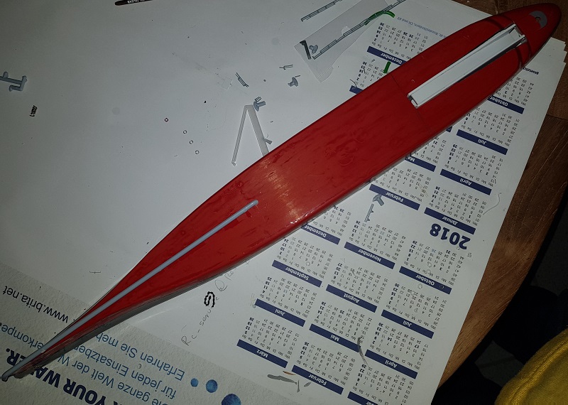

ok...starting most difficult first....
brute sketch of target

gonna line all on rear...say fins so ...make space to put in fins...and no more way back lol

Re: re-do of old 1/535 Iowa revell
next I'll be making ribs for the roundings....and cover it all with the plastic 1mm greensomethingname and finish it with mastic.....and a lot of sanding
the rear is gonna get way more rounding so more cutting away from original hull...but hey...taking it step by step...problem after problem.

I first was gonna cut whole rear....but then I thought better to keep as much of hull as possible...matter of fixing and strength.
I won't keep the steps either
