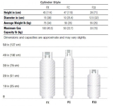

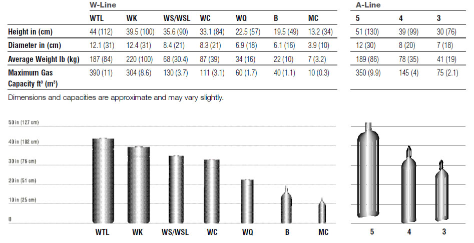

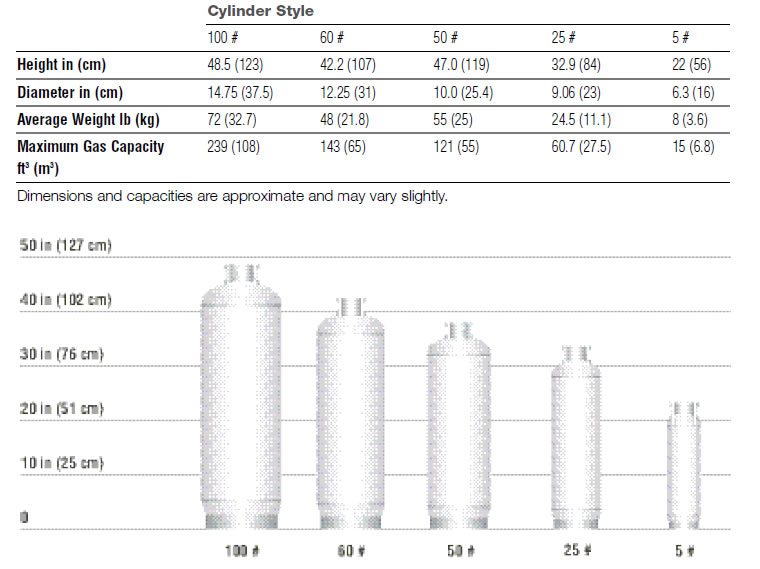

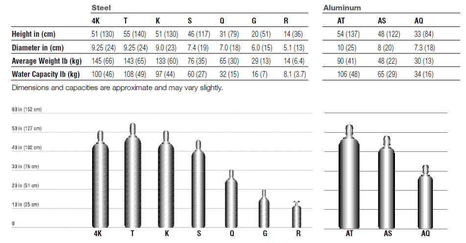

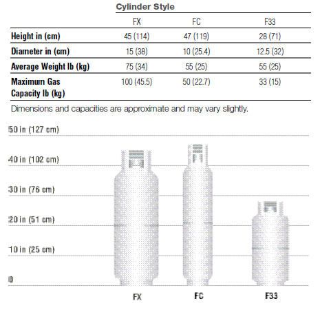

The photo below shows cylinders of two different sizes stored aboard ship in the racks mentioned by Jim. Sets of 3D-printed cylinders of both sizes are available in 1/200 scale and larger.
Below the photo are tables of common cylinder sizes. The first table shows generic, high-pressure cylinders. The other tables are specific to the type of gas stored in them (acetylene, propylene and propane, etc.). Model Monkey 3D-printed cylinders are based on dimensions taken from these tables.

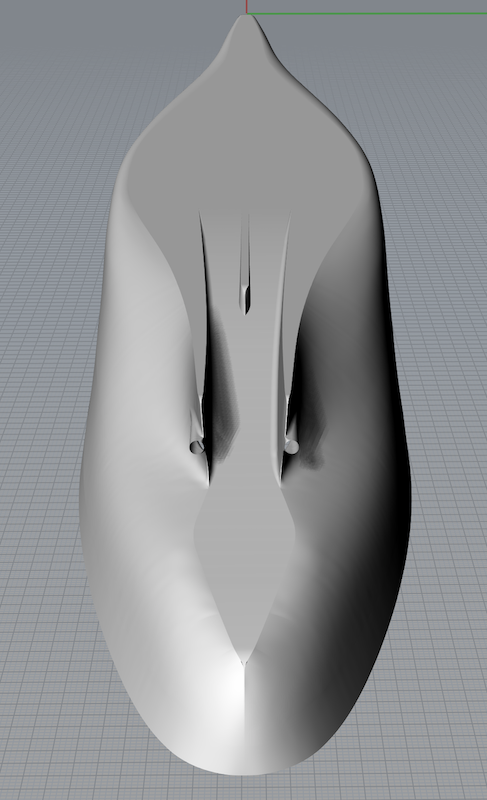

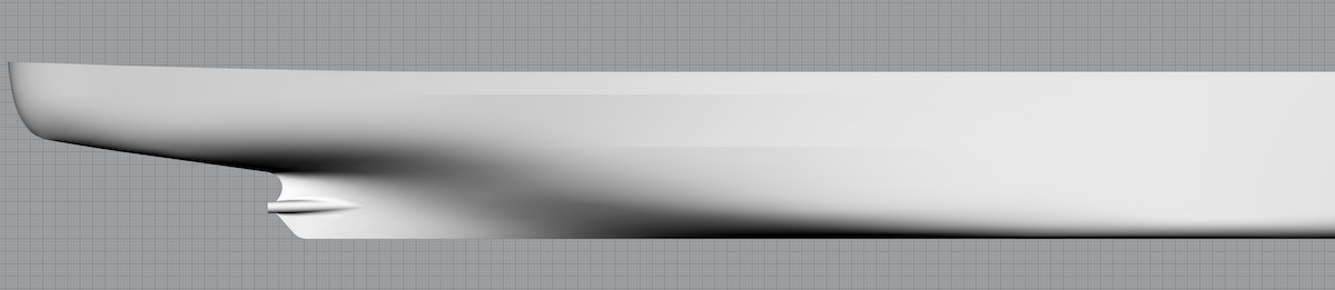

Iowa Class Hull Shape
Hopefully, this will be my last ever hull model, having refined this iteratively over several years.
This is based on the molded lines. I am testing the practicability of doing a plated version. First the bottom. Every kit I have seen has FUed this. The docking keel is likely not to be there or will be way too short. The twin keels are integral part of the hull and are not "skegs" attached to the hull structure. THe plan NEVER refer to them as skegs. Note the curve of the half siding at the bottom and how it compares with kits.
Also note the half siding at the stern that also tends to disappear in kits.
The plating does not follow the knuckle lines so the knuckles are less prominent on the ships.
At the side, the profiles in the area at the right are lines above the heel curves. Aft of that there is a transition where the line starts to become a V, creating knuckles at the vertex of the V and at the bottom of the V where the hull is curve.
At you move aft. the lines of the V transition to curves. Again, the hull plating does not follow these knuckles.

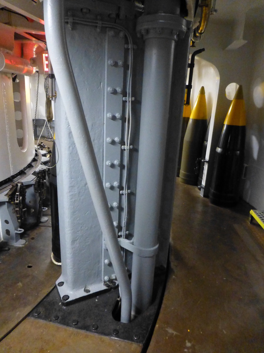

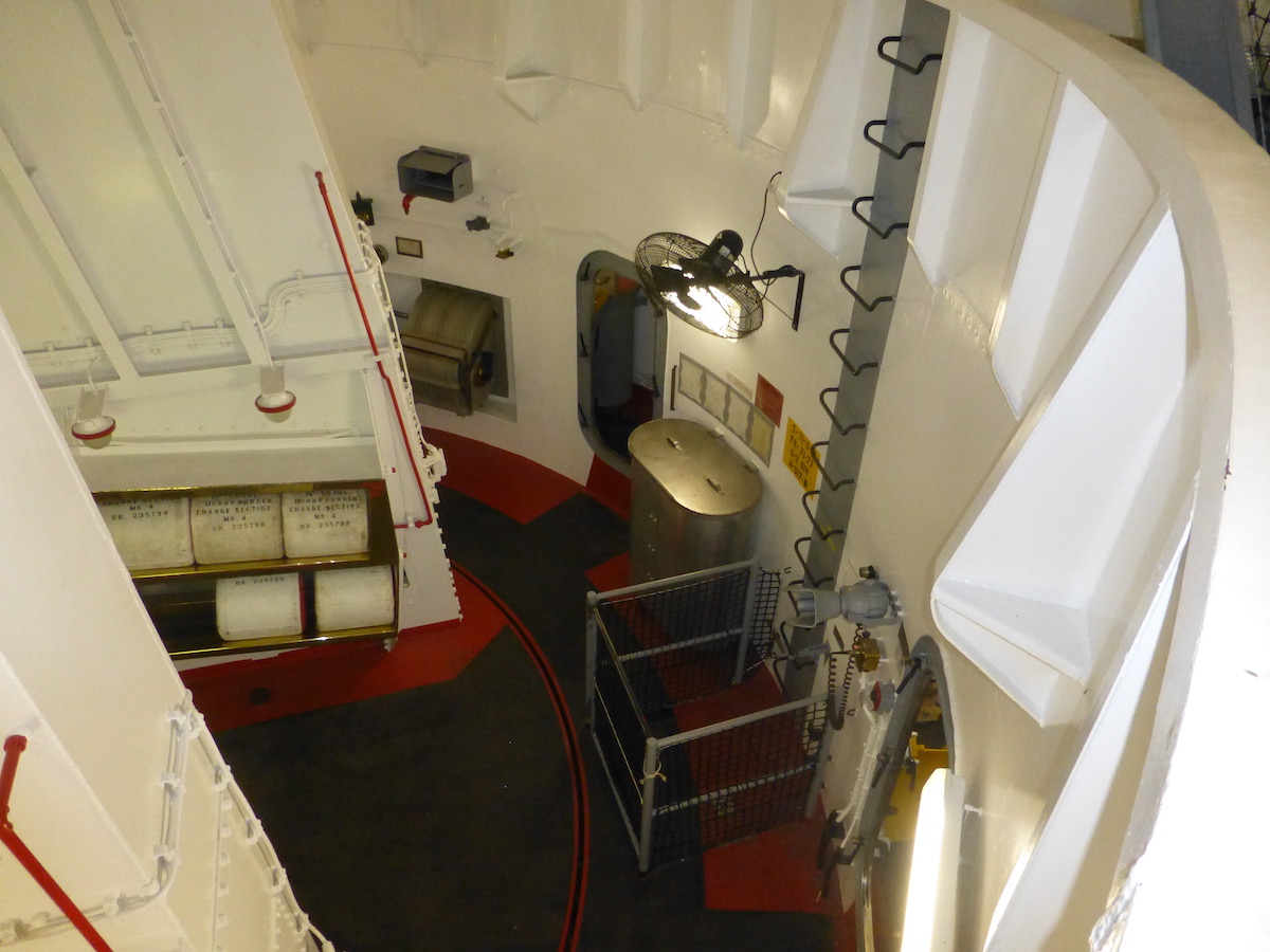

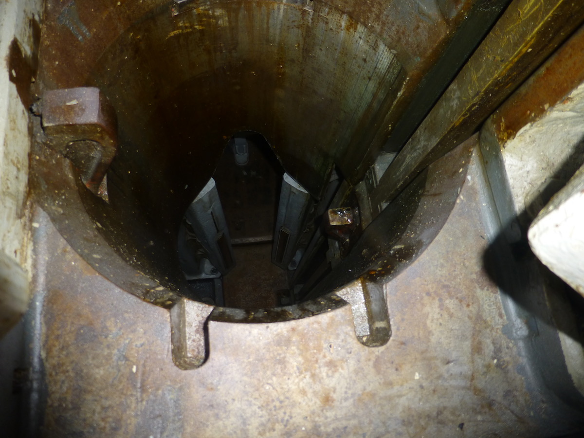

Some pictures of the New Jersey from off the tour. Actually this first picture is on the tour. This is one of the three projectile hoists in the lower flat of turret two. Note the cylinder that is used to jack the projectiles up through the hoist and the pipe with fluid to drive the cylinder.
Moving to the upper projectile flat, this is the view into the hoist. Note the pawl at the left attached to the hoist tube. Further down to the right is a pawl attached to the moveable pawl carrier. The piston drives the pawl carrier upwards. That pushes the projectile past the next fixed pawl, which retracts as the projectile goes by then springs back once the projectile goes past so the projectile cannot go back down. The operator lowers the cylinder and the pawl carrier. It's pawls retract as they go downward past projectiles then spring outward once below them.
The operator repeats that cycle five times to get a projectile from the lower flat into the cradle in the gun chamber.
There can be five projectiles in the hoist and and one in the cradle. The system disengages when there is a projectile in the cradle. The official projectile storage count of 1,264 includes five projectiles in each hoist.

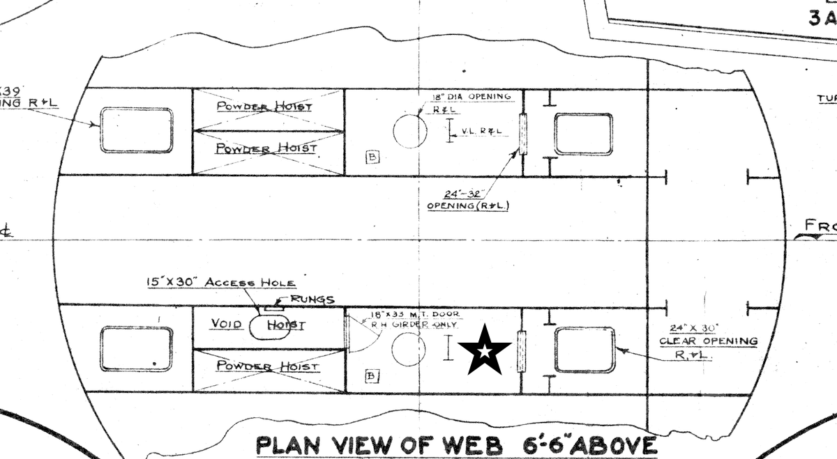

This shows where the picture was taken. The plan shows a ladder immediately in front but it was not there.

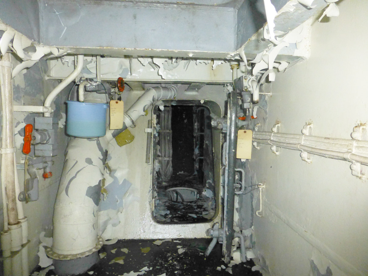

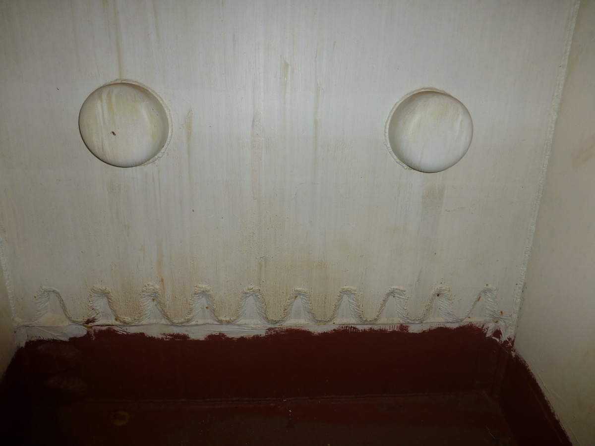

This is where the class A belt armor meets the lower class B tier. The plate that is scalloped at the bottom is the backing bulkhead that supports the class A armor. That is attached to the bulkhead with bolts (the two round covers are examples). There is about an inch between the backing bulkhead and the class A armor. The gap is filled with concrete.
The backing bulkhead overlaps the class B armor and is welded to it along the scalloped edge. This gives a larger welding surface.
Below this weld joint, the class B belt armor forms Torpedo Bulkhead 3. Above the joint. the backing bulkhead forms the rest of the Torpedo Bulkhead.
When the turrets were redesigned after the original design would not fit on the ship, books say it produced a cramped layout. You would not believe how cramped. I wish I had taken more picture crawling through but this the level just below where the gun crew stands. You have to crawl on your knees. The ladder in the background leads to the center gun chamber.
