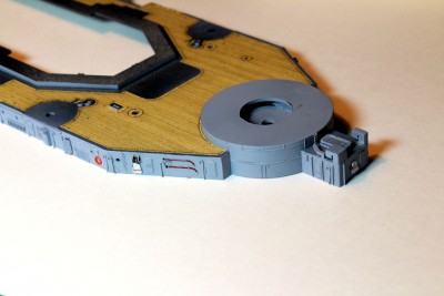

I placed the 1st Superstructure Deck in place here just so you could see where Turret #2 goes. This photo shows it straight out of the box with nothing done to it.

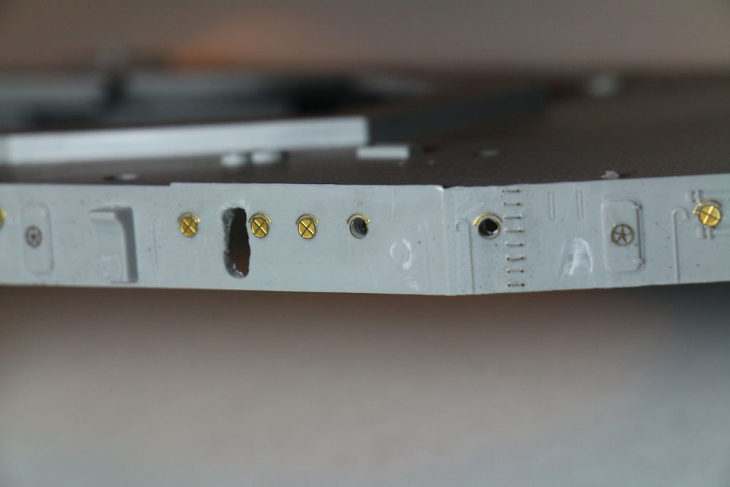

The first thing we do is to drill out the portholes with a hand drill. I decided that I wanted a couple of the hatches opened so I drilled out the opening using my Dremel. Then I added the ladder rungs. Luckily they give you a drilling template, as you see here. Drilling is done by hand with a 0.3mm drill.

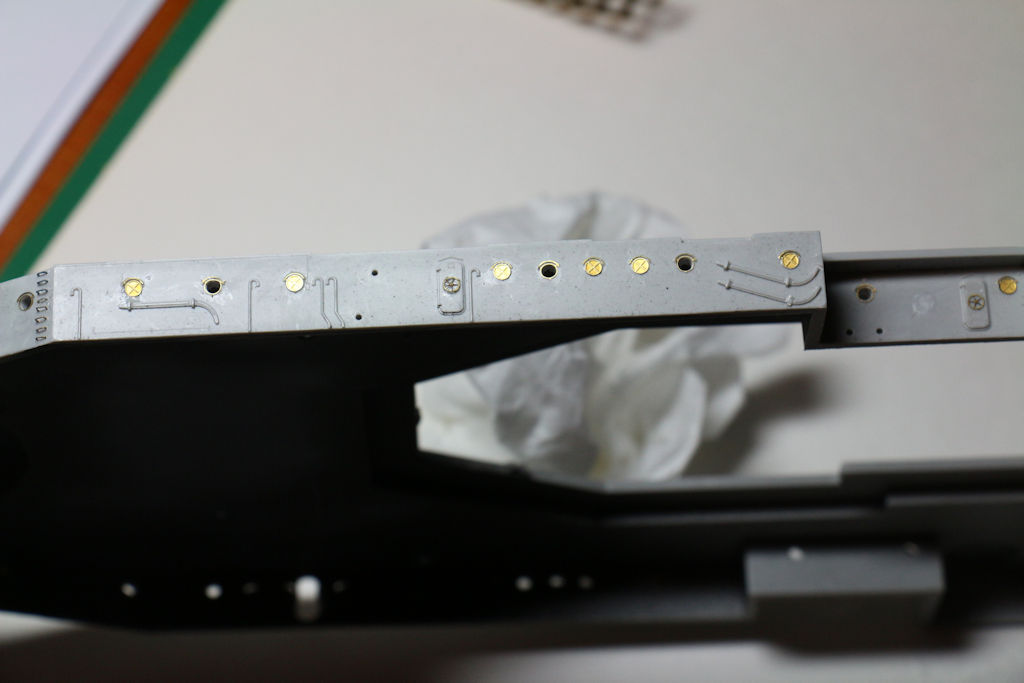

The next step is to glue in the porthole rings and the “eyebrows” above the portholes. You can select the portholes as being either open or closed. There is enough brass photo-etch supplied with the Pontos detail kit for whatever pattern you choose (providing you don’t screw too many up!)
This photo shows the porthole rings glued in place. As you can see, some are open while others are closed. Also, note that I added are brass hand wheels on some of the hatches. Yeah, I had to buy these extra, too. Dang boat is costing a fortune!

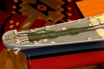

Next comes the waterways, or “scuppers”. These are strips of Pontos brass photo-etch (PE) that have been primed and sprayed Intermediate Blue.
The plastic part has an embossed deck pattern but the Pontos detail kit includes an actual wooden deck. It’s extremely thin and very fragile, which for my clumsy fingers is not a good combination.

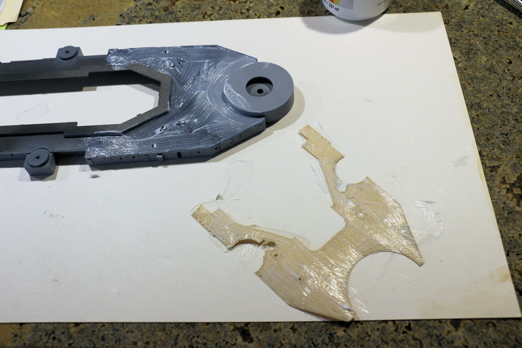

The wood deck is adhesive backed, but many model ship builders here have complained that it does not stick down properly over time. To prevent this, we instead glue the decking down using artists matt gel medium. An 8 ounce bottle like this costs around $14.
We kill the adhesive on the back of the decking with Krylon clear spray and then slather on the matt gel, making sure every bit of the surface on both parts is covered.

The gel doesn’t dry right away so we can position the deck where we want it. Then we make sure there are no bubbles or air pockets underneath, and using a brush and water, we clean all the excess off and set it aside to dry overnight.

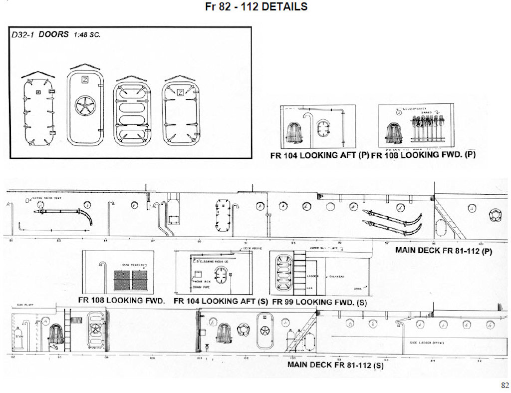

Now we’re ready to start adding detail to the sides of the deck. I’m using a set of plans for the ship from The Floating Drydock that shows the deck in accurate detail as to what should be placed where. Yep, these plans cost extra too, but they are a little over 9 feet long and worth every penny! Unfortunately though, a lot of the detail shown on these plans are not included in either the ship kit or the two detail kits and must be hand made. Here's an example of what these plans show:

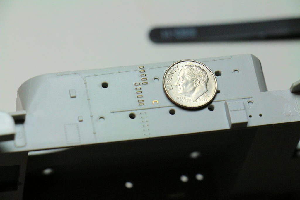

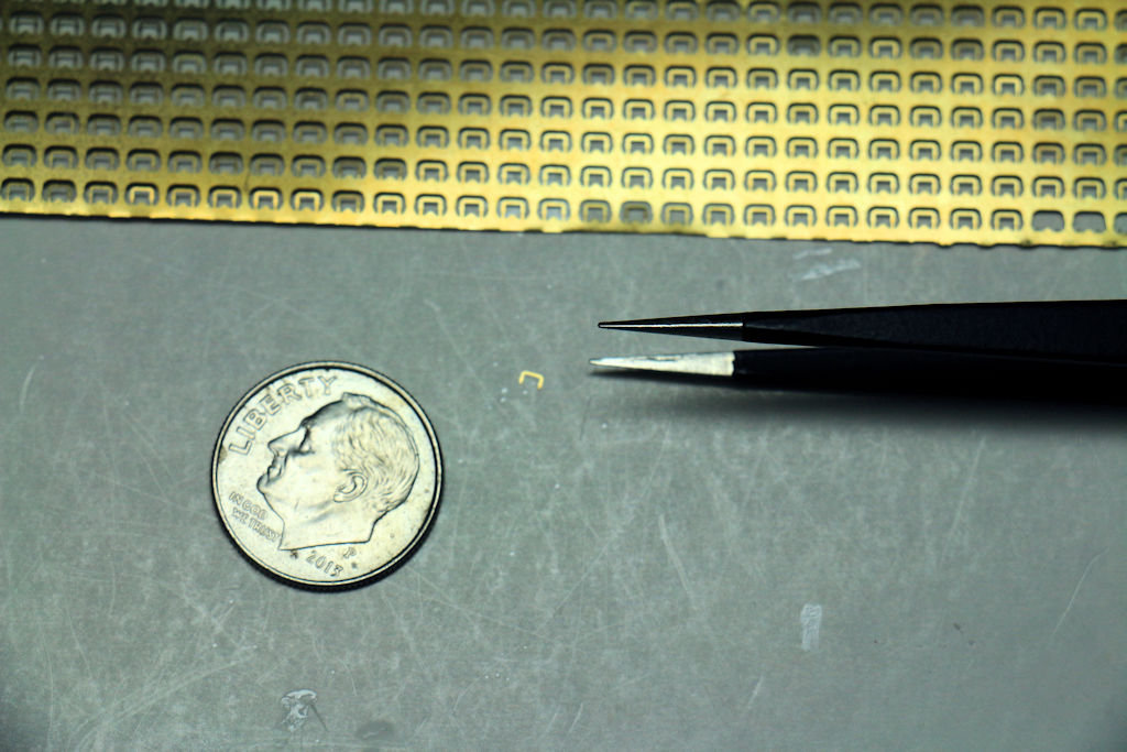

Here I've placed a dime next to this part so you can get a relative idea if the size of small parts I'm dealing with. Now, mind you, this ship model is 53 inches long. That's 4-1/2 feet! A magnifying glass is a must!

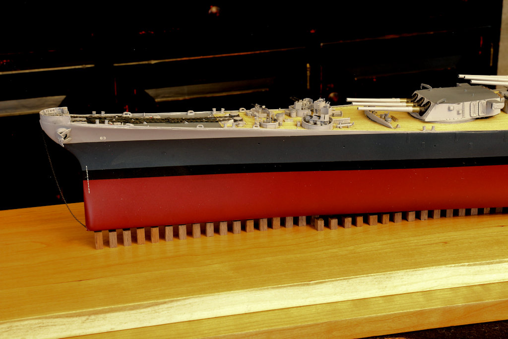

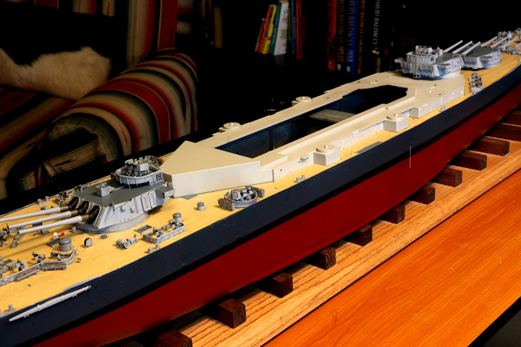

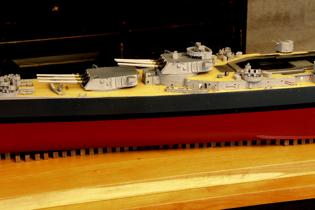

Normally big, elaborate ship models are mounted on brass pedestals, but I didn’t want to do this. I wanted something different - something on the order of what Hank mounted his New Jersey on. I wanted my ship to rest on keel blocks. And even more, I wanted the keel blocks to emulate the layout of keel blocks that were installed in the drydock where the Missouri went for its last refit. Here’s a picture if what the drydock looked like - before it was filled with water, of course!

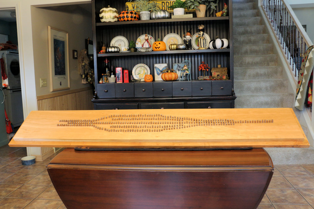

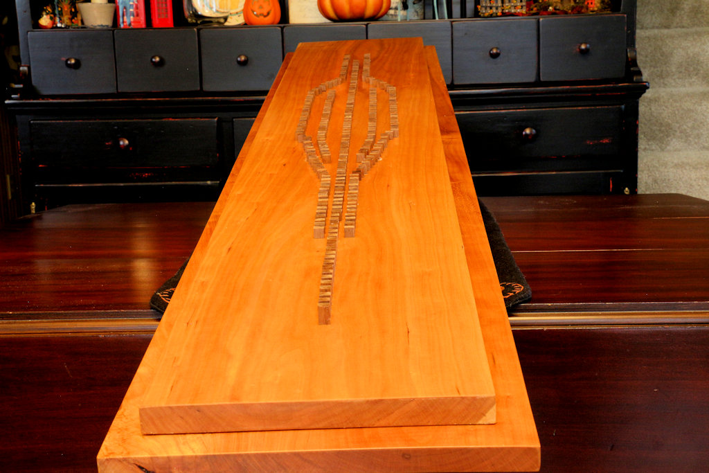

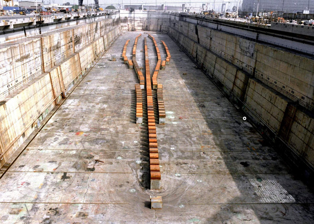

My pattern isn’t exactly the same, but it’s close enough for me. I used walnut for the keel blocks to provide a contrast to the lighter cherry wood. Besides, I had the walnut so it didn’t cost me anything.
I used 288 walnut blocks 3/8” x 3/8” x ¼” spaced every ¼” apart. Actually, it was easier to do than it looks. The hardest part was cutting them out. My thumb suffered an injury from the blade of my hobby saw. Told you earlier I was clumsy!
At the same time I was cutting out the keel blocks, I found a local acrylic fabricating company that could make me a clear acrylic case for this ship. If any of you are from southwest Michigan, I highly recommend a company called PlexiCase, located here in Grand Rapids. They were competitive, dependable, and did an excellent job. This case only cost $235. (Yeah, I know! More $$$$$$)

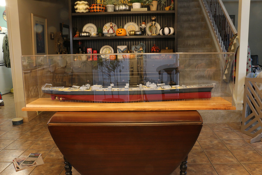

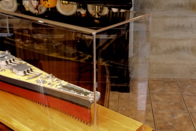

Plexicase borrowed the base and made the case to fit exactly over the lip of the bottom board. They did it in only a couple weeks, too. I promised them that when I finished the model, they could put it on display in their showroom for a month or so. They were delighted to hear that. Sure hope I finish it before they go out of business!
The case is 60” long, 10” wide, and 15” high. It is make of 3/8” acrylic and the seams are rounded and flame treated for smoothness. The ship is 53” long, which gives 3-1/2” clearance at both bow and stern. I’m having a nameplate engraved for the case, but it’s not finished yet. And yes, the case IS high enough. I may be dumb, but I ain't stupid!

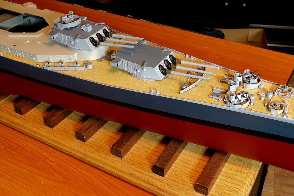

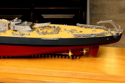

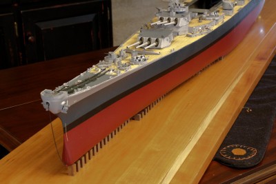

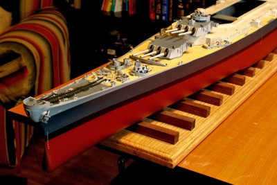

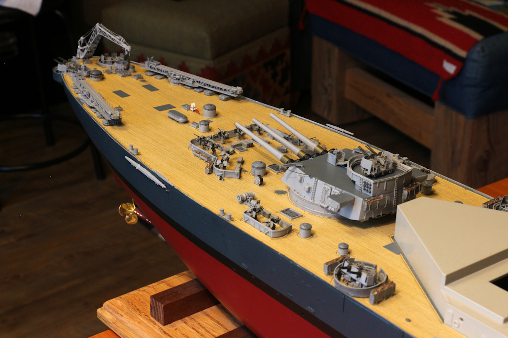

This and the next three pictures show the ship resting on the keel blocks. Looks kinda neat, don't you think?
I think this looks a lot nicer than if the ship was mounted on a couple pedestals.

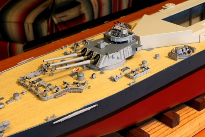

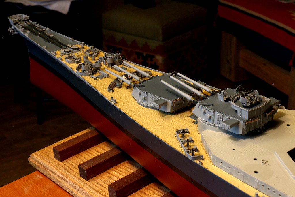

Another shot of the ship resting on keel blocks. This is a lot more work than using pedestals, but I think it looks a whole lot better.
The stern of the ship mounted on the base. I don't know if I told you or not, but the silver colored strips on the prop shafts are zinc anti-corrosion plates. There are some on the rudders also. This is actually automotive striping tape!

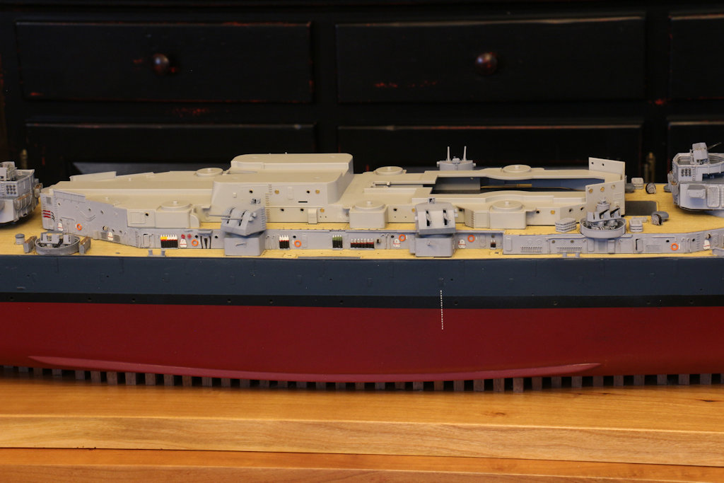

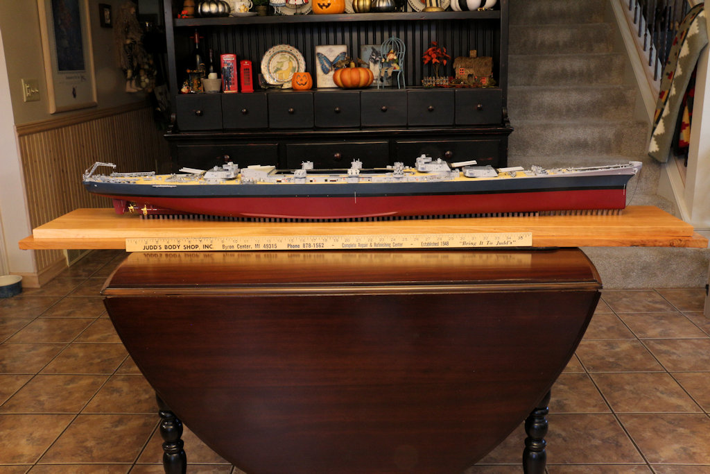

This is an overall side view shot of the ship mounted on it’s base. A 36” yardstick is placed in front of the model to show the relative size of both the ship and the base. This is one BIG ship!! And please don't ask me where I'm going to put it!

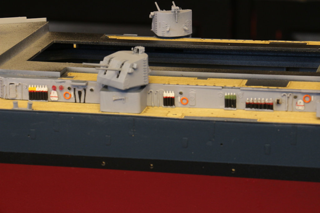

The next several pictures show close-ups of the detail on the sides of the first superstructure deck. The angled tubes you see on the outside of the 20mm splinter shield are spare gun barrels for the 20mm guns. Also, note the 9 gun crew helmets located on the outside of the 40mm gun tub. These items were all made out of bits and pieces of plastic. They are not part of any kit.

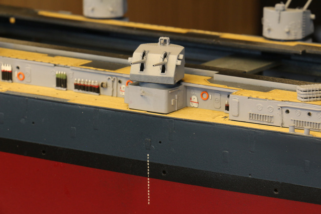

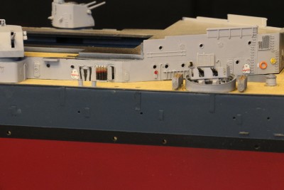

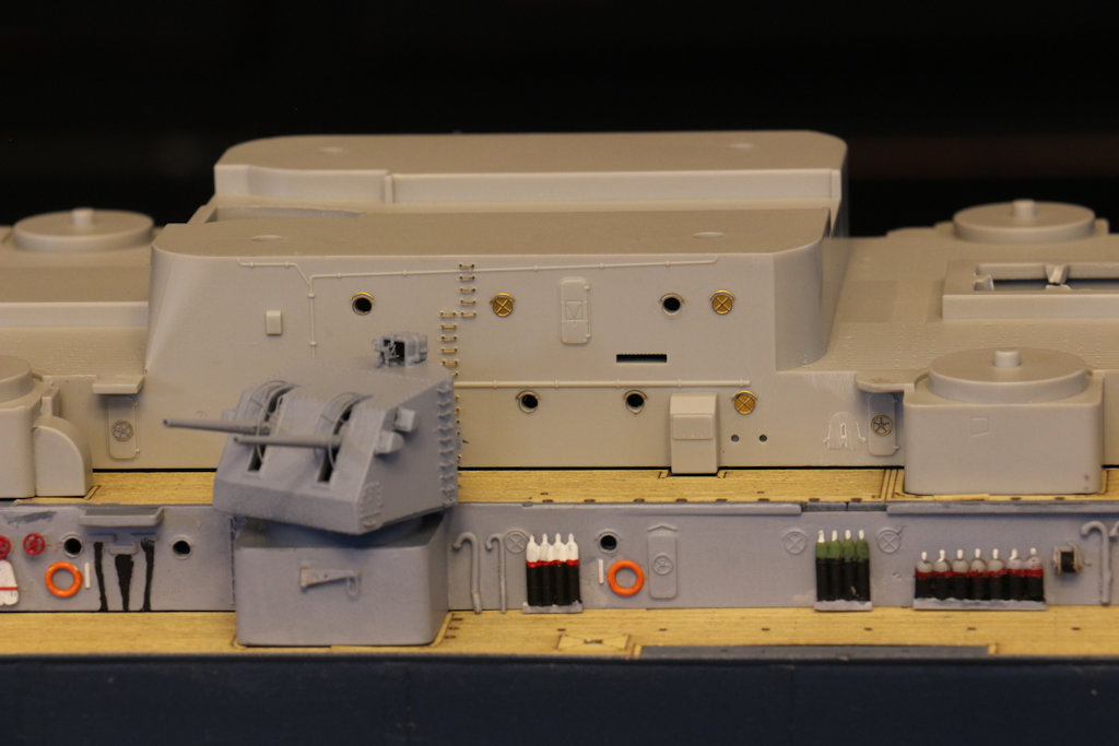

Here we are starting at the front of the starboard side of deck #1. We see a hose reel, fire hose, and life preserver. Note that all the vent pipes are hand made from thin brass rod, with a tiny dab of CA glue at the tip.
This view shows the detail of one of the 40mm quad Bofors gun mounts as well as the ladders and miscellaneous equipment hanging from the deck sides. I see from this photo that the open hatch is slightly drooped, which has since been corrected. This deck has not been glued down yet, resulting in the visible gap where it joins the hull deck. Note that many of the vent pipes are "kicked out" at the bottom about 4-5 inches. This bit of information came from the TFD plans.

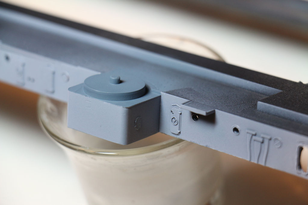

This is a little further aft on the starboard side. Note the hoist on the side of the 5” gun platform. The two red valves above the fire hose are identified on the blueprints as steam cutoff valves. Also, the compressed air tanks with the yellow top are dichlorodifluromethane, which is used as a refrigerant. The location of the compressed gas bottles I've shown here and not actually as positioned in 1945. I'm trying to show a representation of the types of gas bottles that might appear on the ship.

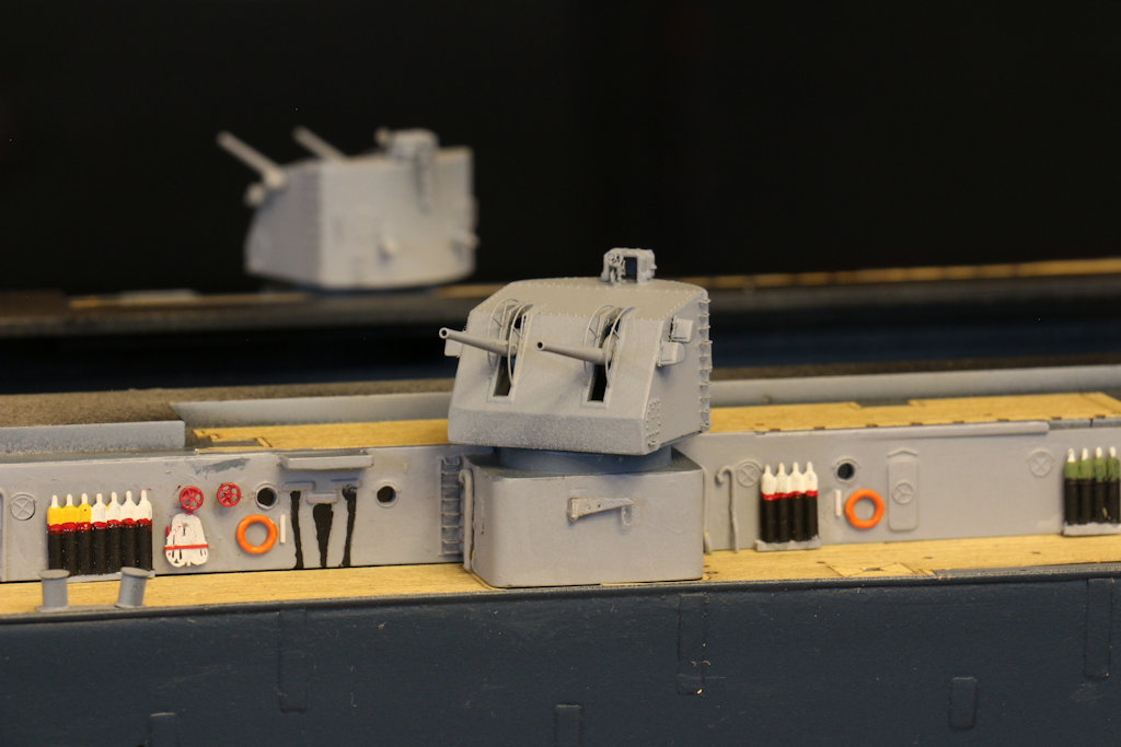

I took this next shot to show the detail on the back of the 5” gun turrets. Note the hatches to gain access to the insides of the turret and also the two shell ejection chutes. These little snots were a bugger to make. Took me a couple weeks to make all 10 of these assemblies. Building a model like this as actually building dozens of small models and then putting them all together. Well, more or less!

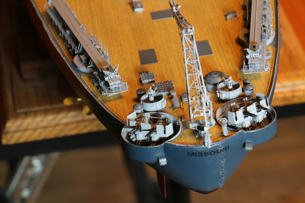

And speaking of deck #2, I set it in place temporarily so you could get an idea of what I’m working on next. I’m building this beast from the bottom up, however a lot of the railings and other really intricate detail won’t go on until the ship is nearly complete. They’re way too fragile. Also, there is quite a bit of detail that mounts on the main deck in front of deck 1 that isn’t in place yet. Things like ladders, winches, fire nozzles, etc.

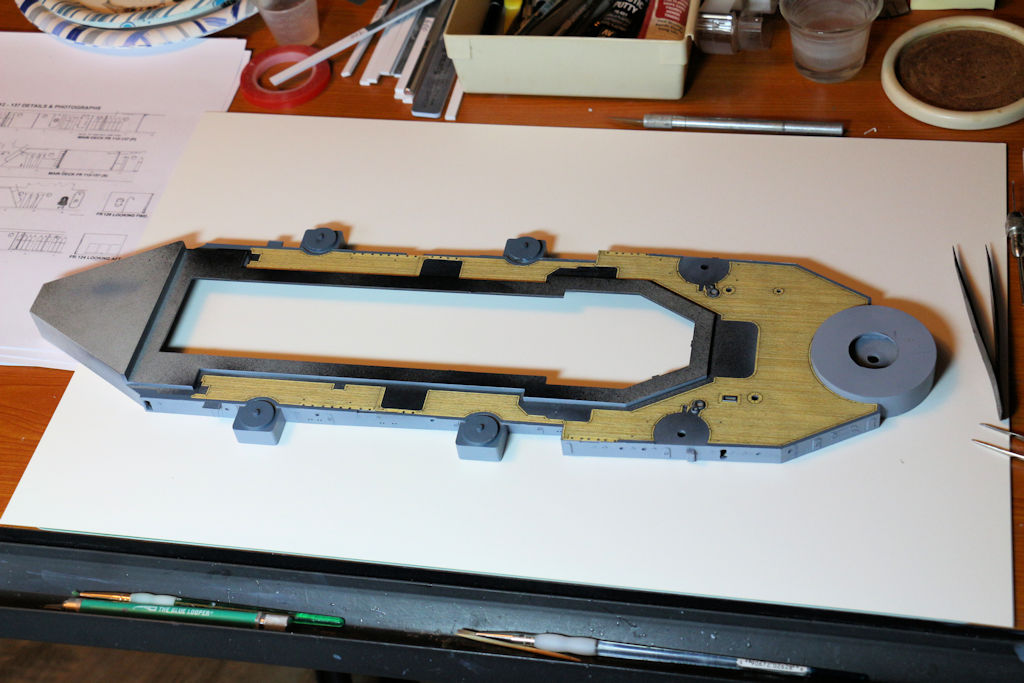

I'm building this ship from the bottom up, so the next step involves adding decks 2 and 3 and the associated detail that goes with them.

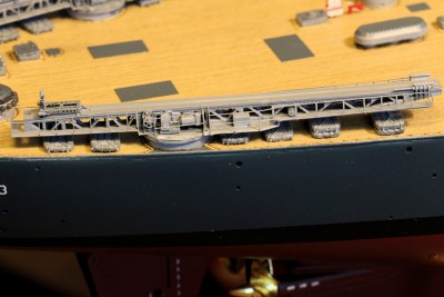

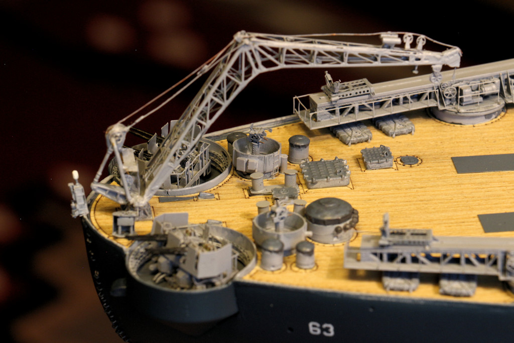

As you can see in the following picture, I added some detail to the life rafts. I took Evergreen plastic rod, cut it to length, and squeezed one end flat to simulate oars. I then also tied the stack of rafts down with fine wire to make things look more realistic.

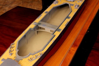

Here is more added detail to the ship. Note that the superstructure is not yet glued down to the deck, resulting in a slight gap. The net baskets have fine fabric (called Toule) rolled up in the bottom and small pieces of plastic rod painted brown on top. The triangular protrusions on the conning tower and below the windows are antenna lead-in for when I attach the rigging to. Also note that I added windscreen wipers where they were found. The one turned out OK, but the rear one not so good. I since have replaced it with a better one. And oh yeah, there's a rack to hold spare stanchions at the base of the conning tower. The Floating Drydock plans I have indicate this is present.

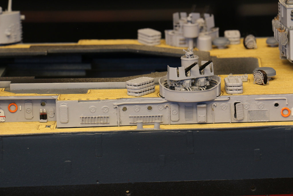

Here's a closer view of the life rafts as well as a mop rack. Hey, they look like mops, don't they? If you use your imagination??

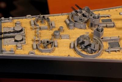

This next view shows the various compressed gas bottles that were carried aboard the Missouri during WWII. The ones with a green top are Oxygen and the short, stubby ones with grey tops & a red stripe are acetylene. Also shown are the spare gun barrel tubes attached to the outside of the splinter shield of the level 3 20mm gun position.
If you look just inside the passageway between the port and starboard sides of the ship, you will see a rack of compressed cylinders of propane secured to the wall. Just more detail that my TFD plans show.

Greetings, Peoples,
I figure it's about time to share a few more pictures of my plastic toy boat. So, here we go:
This shot shows gas bottles, hose reels, life rafts, fire suppression equipment and again, my feeble attempt at making a Stokes litter. I painted the area behind the air intake grills black to make them stand out better.
A few places on the ship I opened up the hatchways for a little more realism. You can see where a 20mm AA gun mounts here and also the ammunition racks that are mounted on the inside of the 40mm gun tub. Those of you who built or are building this ship know what a pain these can be!

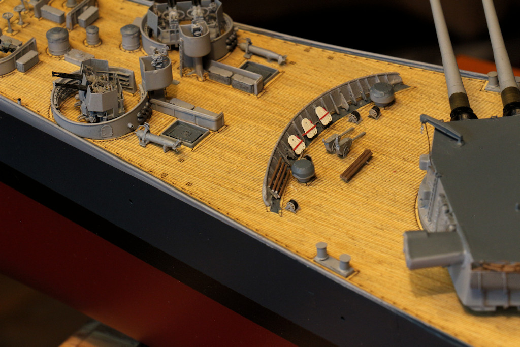

Here's a close up of the oars and the tie downs I added to the life rafts. Gives a little added realism to the ship.
Now we're on the port side working our way up toward the bow. Pretty much the same as on the starboard side.

The kit doesn't mention it, but my plans show a rack mounted here containing refueling hoses. So, thanks to Evergreen shapes, we now have said rack, complete with hoses.

Kind of a toss-up to know where to post this. If the moderators don't like it here, they can move it to the completed section.
THIS SHIP IS FINALLY DONE!!
That's right, friends, this beast is finally finished! After umpteen years, even more $$$, and lots of cussing (+ many bottles of vino!) I can call it finished. The last thing I had to do was paint 368 little people, approx 1/3" tall (360 sailors and officers + 8 Japanese). You wanna know what a pain in the butt that was! Especially the neckerchiefs the sailors wore! By the time I did all that, and positioned them in somewhat resembling a realistic manner, I was more than ready for this thing to be done. So, gang, let's take a look at the final project, shall we?
Here is the entire ship. You can't see a lot of detail in this shot. Be patient, we'll get there.
In case you've forgotten, I elected to mount the ship on simulated keel blocks similar to how they were when the ship was in drydock. I thought it looked nicer than mounting it on a couple brass pedestals.

This next photo shows a yardstick alongside the ship. The model is 53" long overall. It's a big sucker! And yes, if you look close, you can see some of the crew.
Here's a bow-on shot. You might be interested to know there are 4395 individual pieces of brass PE making up this ship. This is from the two Pontos detail kits, various Eduard sets, and the PE that came with the ship. As I finished a subassembly, I listed the parts on an Excel spreadsheet. (Yeah, call me anal!). In case you're interested, the modal contains 6754 discrete parts: 1325 plastic pieces; 730 resin parts, and 305 other misc parts, aside from the PE.
You have seen similar shots, but in case you forgot, here are a few pictures of the starboard side. I'm not showing port side photos as the ship is mostly the same on both sides. You can start to see the little sailors walking around.
