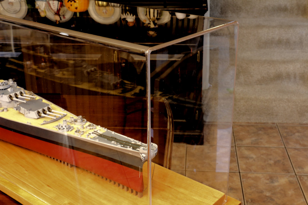

The case is 60” long, 10” wide, and 15” high. It is make of 3/8” acrylic and the seams are rounded and flame treated for smoothness. The ship is 53” long, which gives 3-1/2” clearance at both bow and stern. I’m having a nameplate engraved for the case, but it’s not finished yet. And yes, the case IS high enough. I may be dumb, but I ain't stupid!
This and the next three pictures show the ship resting on the keel blocks. Looks kinda neat, don't you think?

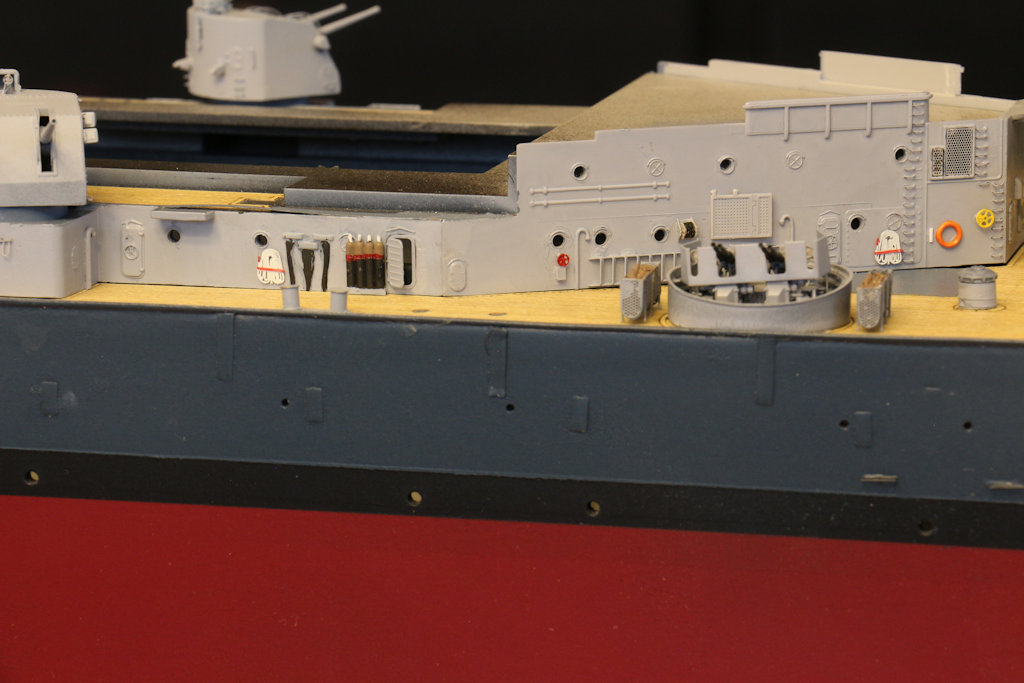

Here we are starting at the front of the starboard side of deck #1. We see a hose reel, fire hose, and life preserver. Note that all the vent pipes are hand made from thin brass rod, with a tiny dab of CA glue at the tip.

A few places on the ship I opened up the hatchways for a little more realism. You can see where a 20mm AA gun mounts here and also the ammunition racks that are mounted on the inside of the 40mm gun tub. Those of you who built or are building this ship know what a pain these can be!

In case you've forgotten, I elected to mount the ship on simulated keel blocks similar to how they were when the ship was in drydock. I thought it looked nicer than mounting it on a couple brass pedestals.
