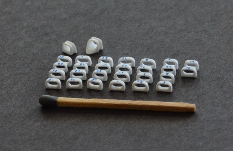

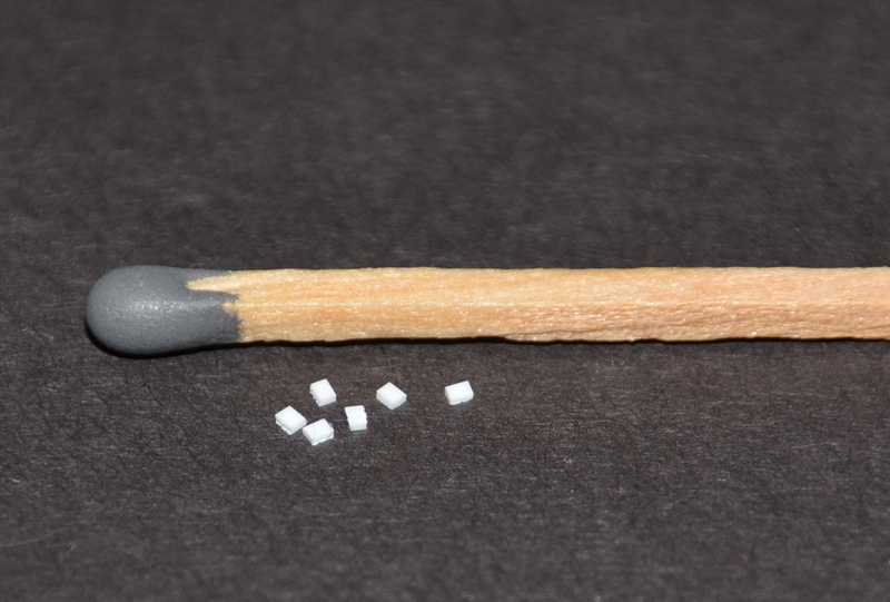

The next element was closed chocks, something again that gives much life to a deck.
This is the type all Fletchers were provided with: The profile is very easy to make, but it is necessary to notice that the inner profile is round, so that the lines do not break after rubbing against the borders.
There were 22 of these on board every Fletcher, so the task was somehow monotonous, but anyhow easy. To accelerate the process I made all of them on a single strip, drilling the holes in a row, refining the inside profile and finally rounding the outer upper angle with a cut and sandpaper; then I cut the segment away, and did the other corner. Gee, my fingers are big, and these things are small... I made some more than the necessary number, to choose then the best ones. With only a dry fit, the effect is quite convincing: Very slowly, but this hull starts looking like a Fletcher hull.

Pleased to see some more progress on your ship. Your chocks are very convincing. For my Missouri and Alaska I made masters and cast the rest. Today I would print them! But it is a tour de force of traditional building to make them all by hand and yours are quite authentic. Perhaps the most dedicated hand fashioner on the forum is Song, who would make his anchor chains by hand in wood! I suppose we spend more time about fretting about the job than it actually takes.
Best regards! Tom
Best regards! Tom

Willie,
Yes, those chocks certainly are much more realistic than the molded kit offerings. I too chose to remove them and do mine myself (3D printing in my case). Your model is looking very nice at this point.

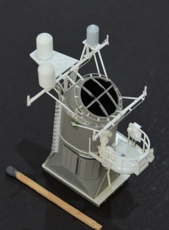

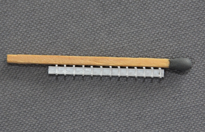

As I am still thinking of solutions for the bloody blast bags, I have had a try with the cable tray in the aft stack.
As it was discussed before in the thread this is what USS McGowan and Jorge Juan had, i.e., flat brackets: An arrangement that can be confirmed by a better picture of USS Uhlmann: I have used for this Evergreen 2 mm. channel and 0.25x0.5 mm. strips. The size is too big, but I thought that smaller sizes would be too fragile considering the following steps in the construction.
The tray was very easy to build, and was left to dry before attaching it to the stack, only to find the next morning that for some reason the combination of liquid poly and plastic had made it shrink and therefore comb badly. I thought at first it could be used anyway, but in a second thought, and as this is so easy to build, I didn�t want to run the risk of making a poly mess in the case the channel offered some resistance, and started the process again, this time in two steps. First step: And second: Using a channel I think I get for free the same effect that the original tray shows, plus a further inside channel that can be useful for additional wiring, in case it was necessary. As I say, the brackets are a bit over scaled, but this is something I have to sacrifice, trading caliber for resistance.
To be continued, and very best regards in the meanwhile,
Willie.[/size]
Thanks once more for your kind remarks.
Willie.[/size]

Willie,
Well, I'm not exactly sure how I intend to construct the similar cable tray for STODDARD, but I think you've done a good job on your model of JORGE JUAN.
Yes, it may be a bit oversized - have you already attached the tray to the stack, or is it just laying in place? If not, I would suggest making a 2nd cable tray slightly thinner in overall thickness and perhaps slightly narrower. Perhaps 1-1.5mm less in both directions. I would also "attempt" to count the actual cables running up the tray if you have any close up photos to give you a fairly accurate number. I would then determine a minimum length of these cable (including extra length for waste) and arrange those in the tray PRIOR to mounting and adhering the tray to the side of the stack. This way the cables and their holders are all in place when you mount the part to the stack. You can spread the upper ends of the cables as needed to the various RADAR units, etc. and terminate them; similarly, the bottom of the cables can be terminated at the deck. I don't know what you plan to use for "cables" - I am going to see if some old wall telephone wiring (6 wires/cable) will work - outer sheathing removed, exposing the individual 6 covered stranded wires. If these are too wide, I may use real thin styrene rods (0.020 dia. or less - 0.5mm) if it's available.
Hope this helps,
Hope this helps,

Hi there Hank and all,
Hank, thanks for your suggestion.
Nice going in NC, and best regards from this side,
Willie.[/size]
Actually it is only the protruding vertical parts that are somehow oversized, but I would say that the tray itself is OK. Maybe it is the perspective of the picture or the vertical parts (that obviously will be cut to less than a half of what they are now) that make it to look like that. I sanded the sides of the tray before attaching it to the stack, and it is now 1.9 mm. wide, slightly thinner than a standard size match: As for the cables, I will place them individually, and that�s why I have left the brackets open for now. It is going to be more complicated than anticipated, but I think it can be done.BB62vet wrote: Yes, it may be a bit oversized - have you already attached the tray to the stack, or is it just laying in place? If not, I would suggest making a 2nd cable tray slightly thinner in overall thickness and perhaps slightly narrower. Perhaps 1-1.5mm less in both directions.
Willie.[/size]

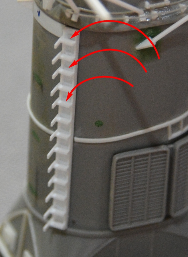

The next step was the wiring. I tried optical fiber at first, but it will never bend at sharp angles, but simply break, so i had to turn to stretched sprue.
Again, at first I tried to make complete wiring, from deck to every antenna, as things actually were, but the bar and support mess that this stack displays turned into a complete failure any attempt I made. Some of these pieces are really tiny, the stretched sprue has its limits, and after repeated attempts of glueing and ripping, some of them literally disolved in the liquid poly. To crown my miseries, I realized then that I had not set the upper platform in place yet, what made me delete the complete work, because it was now completely useless. I gave up the action for the day, not only having done nothing positive, but having to mend some of the damage caused to the base elements. S**t happens, and all this s**t at 1/144. I have to say that I kept thinking with every failure about how our common friend Marijn van Gils is going to make the hundreds of ropes in his diorama.
After this, I considered making the wiring in sections, starting with the most obvious elements, and going up to the rest afterwards. I made the tray accordingly, setting six wires, so that they are somehow visible when they are painted, and closing the box with stretched sprue. This : Then I fixed the upper platform: And then, I refined the tray, deleting the redundant stuff: At the same time I was adding the first elements of the wiring, merely schematic. If I could use CA I would be able to use some other stuff other than stretched sprue, but in the in the middle of the bar mess I have to deal with, CA is for me out of the question. Not only stretched sprue has got its limits. I have got mine as well.
Macro pictures are of course merciless, what else; at two feet distance, I think it looks aceptable.
Nice going and best regards from across the seas,
Willie.[/size]
Well, regarding your remark:
Same thing here, my friend. And I can even remember the first models I used to build, when (believe it or not) advanced modelling meant tweezers.Fliger747 wrote:I remember as a young man being able to work with small close subjects without glasses or magnifying hood. Certainly out of the question now!

Willie,
I think your tray looks fine - you've captured the essence of the cables, etc. and that's more than most modelers would even attempt. I've got a long way to go on my version, but I'll be posting my latest 3D designed part for this over on my build.
Your stack & associated RADARs are looking extremely professional - and I applaud your efforts!!!

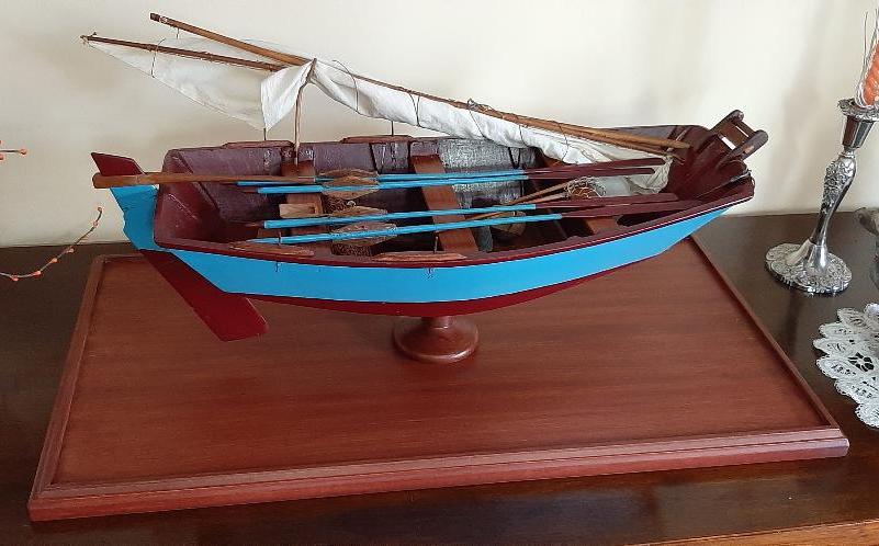

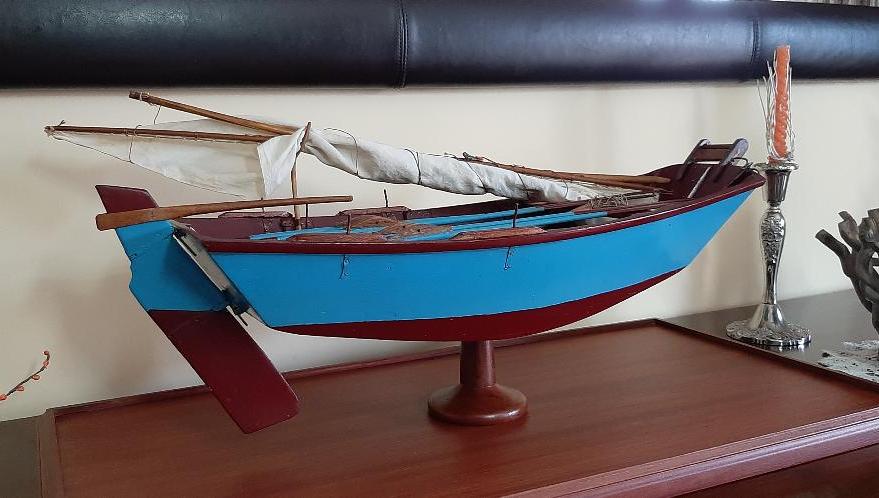

He devoted his last modelling years to build the traditional fishing boats of my village La Guardia, the so called "gamelas", in ca.1/20 scale, selling them to add something else to his retirement pension. The construction of these ships was very simple, and therefore very easy to model.
This is Grandpa in say 1966, building one of these gamelas: He died completely blind in 1979, so this specimen, that he built in 1969, was one of the last, if not the very last, that he ever built. It was a present to a granddaughter, that was in due time, some months ago, presented back to my mother, to whom it belongs at the moment. It was displayed in the open air in a sitting room for over 50 years, so I made a careful cleaning and restoration, and had a glass case made for it.
There are some little mistakes in the paint and other clues that make me think that Grandpa had already lost much of his eyesight by this date.
I can only imagine what my grandfather would have been able to produce had he had all the technological advances and modern stuff that we enjoy today.

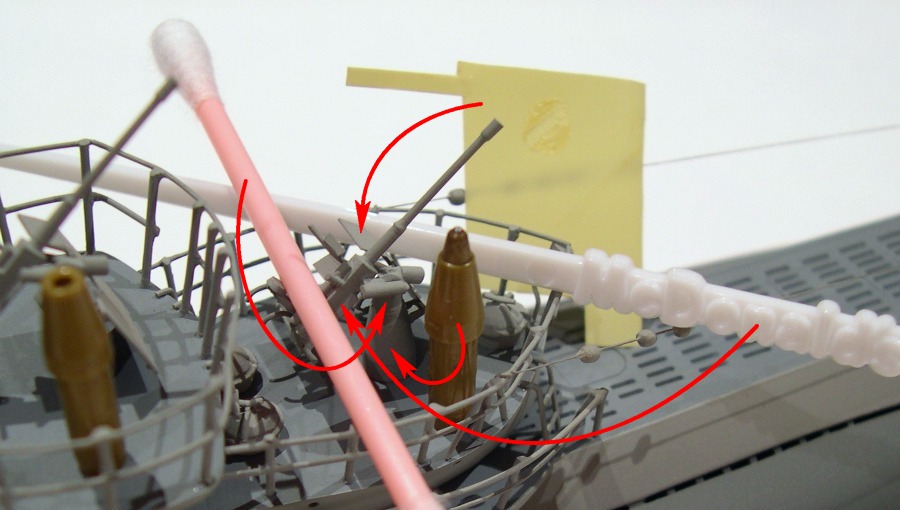

But honestly, scratch building is way easier than many modelers think. I have made it for years, with at least interesting results.

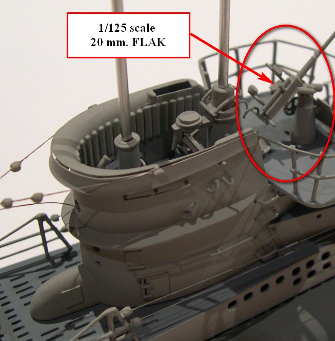

This is the old 1/125 Revell U-boot VII-B, that I built in 1991, with some scratch built elements, the most obvious of them, the Flak 20 mm.: This Flak was built using these very basic elements: Which were exactly these ones, minus the yogurt container for the shield: And we will always have the stretched sprue, that will never be enough praised nor appreciated.

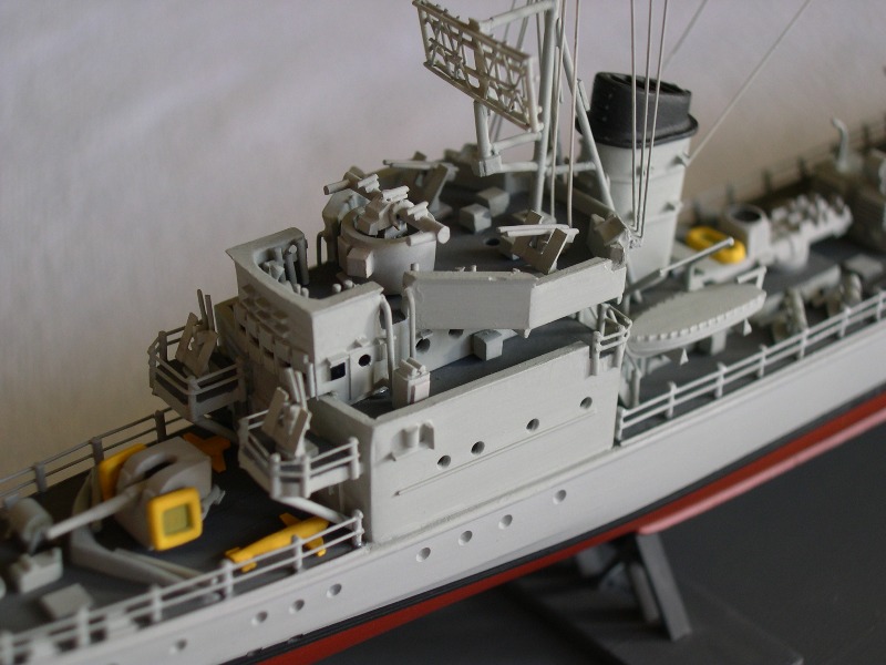

The mack of the French frigate Tourville, made with only stretched sprue: And a very, very basic 1/400 Heller Elbing class torpedo boat, with only streched sprue and yogurt container again, way before I discovered Evergreen: It can take longer than buying lots of built or ready-to-build stuff, but it is very easy to do, and goes for nothing at all in price. the level of satisfaction is also different, I could say, and here is the essence of modelling.
If you guys, Tom, Hank and many others, are printing your own stuff after learning the process, designing your own elements and setting them together to build your own ship, this is for me 100% modelling from scratch, and a path that my grandpa would be probably willing to follow as well. After all, he also bought his logs, because he was first a sailor, and then a carpenter and shipbuilder, not a lumberjack cutting his own trees after being a gardener and growing them in his property.
Heresy, heresy, I know... And I will lapidate myself before anyone cast the first stone saying that no, as I do not build my own hulls, I do not consider myself a true modeller.
Believe me, when I find the way to build my own hulls, I will devote the rest of my existence to build my own ship, SNS Catalu�a, the Knox-class frigate I served in in 1984-85, one of the best periods in my life. 1/144, with painful detail.

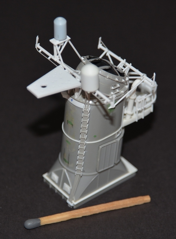

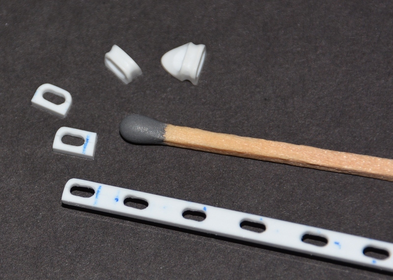

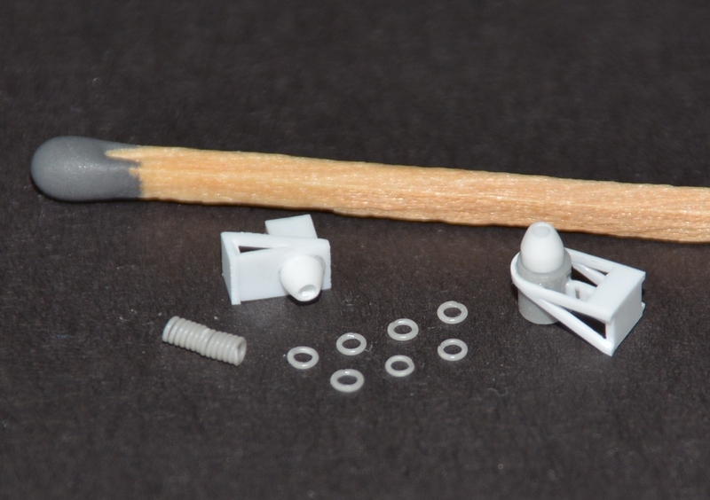

Hi there again, Tom and all the folks,
Tom, thanks once more for your very kind remarks. Coming from such a talented modeler, they mean really a lot for me. And believe me, fat fingers are already a common place in my shipyard.

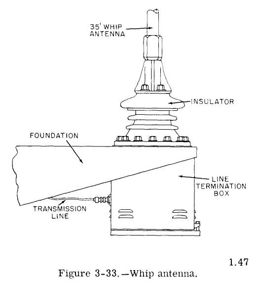

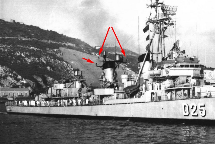

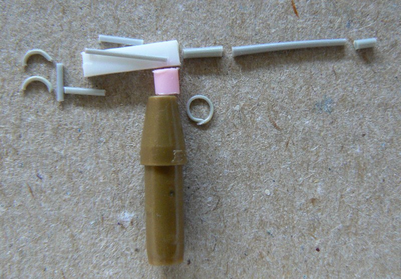

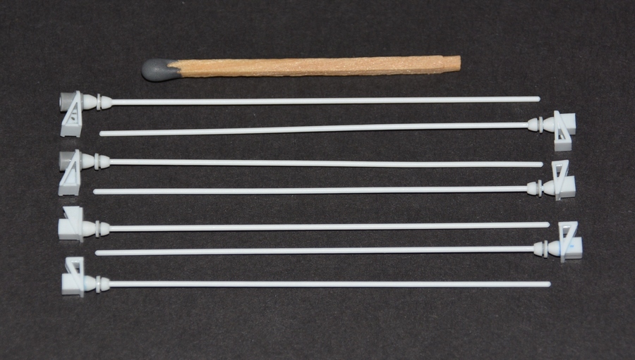

And after finishing the first radio and ECM antennas, this one was again communications week, having a try at the whip antennas afterwards. For once, I was using only pics from the Spanish Navy, something that is always appreciated.
I have to say that this ship has some surprises reg. antennas.
Firstable, the ones attached to the stacks, 66046 and 66047 whip antennas, these ones: The picture is not very clear, but this one of D21 Lepanto, ex-USS Capps luckily is: A very good sketch of this type of whip antennas shows many small details: Without a 3D printer, to reproduce all this is obviously out of the question, so I had to reduce the elements to a recognizable minimum, and also to use standarized Evergreen profiles to make sure all the elements were identical, i.e., 2.5x2.5 mm. strip for the line termination boxes, 3.2x0.5 mm. strips for the supports, 0.75x0.4 mm. strips for the fundations and 2.5 tube for the insulators bases. The building process is easy, and the proportions fit the purpose quite well: There are two more antennas on both sides of the flying bridge, and one more aft of mount nr.2, all three hanging on different supports, that have little in common with the ones on the stacks: For the one on the rear of mount nr.2, I used the same elements as before: The ones on the bridge were not that easy. I had to use a piece of sprue and reduce it to 3.2 mm., as Evergreen 2.4/2.5 rod or tubing was too thin for this. For the fundations I used 0.5x0.4 strip, only to find that thin as it is, its resistance to make curves is remarkable. Applying a flame was impossible, so I had to heat the (luckily!!!) 3mm. handle of one of my files and make the strips turn on it. Exasperating, because too much heat would melt the piece or make it break; too less would produce no effect at all. Any way, patience is something that we modelers have in great heaps, and at last I was able to produce this : As for the antennas themselves, I used segments of 0.75 Evergreen rod, that are acceptably telescopic to the 2.5 tube, and made circles with 2.4 rod, opening 0.75 sharp holes in the middle: And so is the complete set at the moment: Once everything is in place, I will try to add some detail to the insulators. Who knows, perhaps I can do something else in them.
In the meanwhile, I hope you like the progress, and best regards from this side of the Atlantic,
Willie.[/size]
Fliger747 wrote:Having fat fingers, I always like to have a couple of extras! Very nice work!!
Willie.[/size]
- Posts: 5068
Willie:
Where do you get the huge match sticks? Certainly your parts can't be so tiny! Kidding aside, wonderful clean and detailed parts. Rather amazing how many parts of all sorts must be replicated in even a small ship such as a destroyer. I seem to have penchant for knocking antennas loose once attached to the model!
Best regards: Tom

Hi again, Tom and all,
As for the antennas, I thought yesterday that they were somehow bare. Not that much can be done even in this big 1/144 scale, but I have given them a further push today. Firstable I made a small stretched sprue spring on a 0.75 mm. needle, and then I cut several circles from it: Then I made some small cones carving with sandpaper sections of 2.5 mm. Evergreen tube: Then I slid a circle and a cone in place, sealing the the thing with a small drop of liquid poly: Not that it is close to reality, but at least it will fill the gap for now. If in the future I imagine a better way to do this, and as these pieces were very easy to make, I can dispose of them with no hesitation, and make a new set.
Nice going from this side,
Willie.[/size]
Welcome to the so called Two Left Hands club. It has happened to me so often that I have had to refrain me from setting small or delicate things in place before everything else is. You cannot see them kind of finished, but it will save lots of trouble in the long run.Fliger747 wrote:I seem to have penchant for knocking antennas loose once attached to the model!
Willie.[/size]
