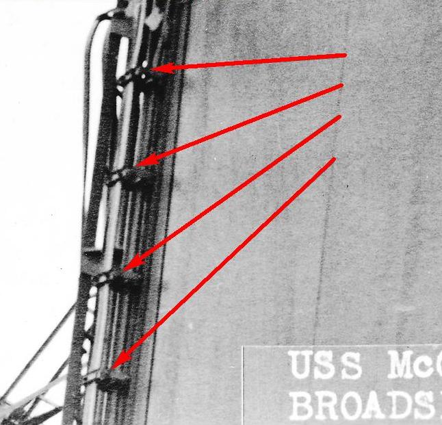

As I am still thinking of solutions for the bloody blast bags, I have had a try with the cable tray in the aft stack.
As it was discussed before in the thread this is what USS McGowan and Jorge Juan had, i.e., flat brackets:

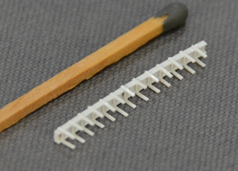

I have used for this Evergreen 2 mm. channel and 0.25x0.5 mm. strips. The size is too big, but I thought that smaller sizes would be too fragile considering the following steps in the construction.
The tray was very easy to build, and was left to dry before attaching it to the stack, only to find the next morning that for some reason the combination of liquid poly and plastic had made it shrink and therefore comb badly.

Using a channel I think I get for free the same effect that the original tray shows, plus a further inside channel that can be useful for additional wiring, in case it was necessary.
As I say, the brackets are a bit over scaled, but this is something I have to sacrifice, trading caliber for resistance.

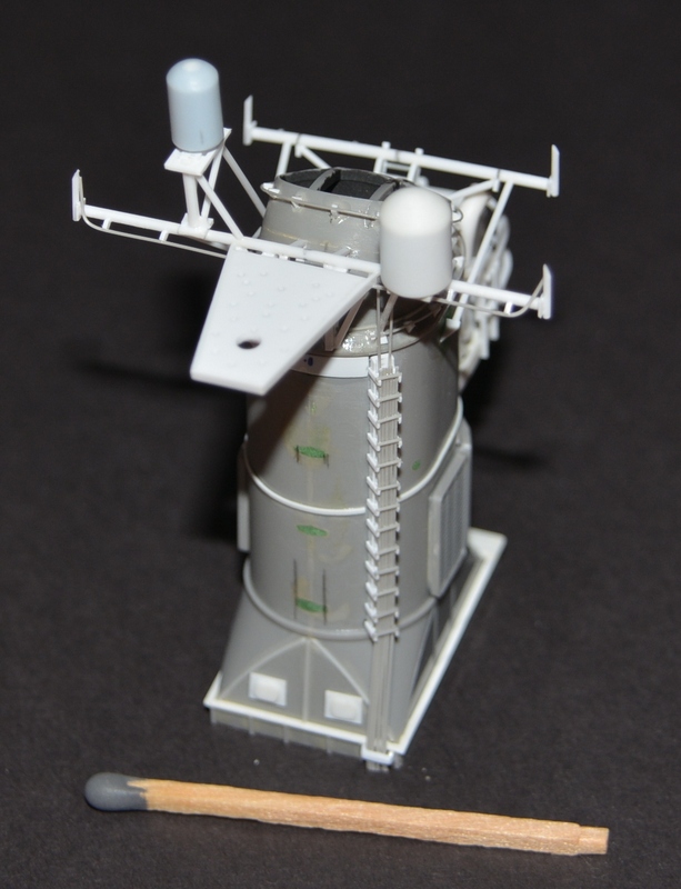

The next step was the wiring. I tried optical fiber at first, but it will never bend at sharp angles, but simply break, so i had to turn to stretched sprue.
Again, at first I tried to make complete wiring, from deck to every antenna, as things actually were, but the bar and support mess that this stack displays turned into a complete failure any attempt I made. Some of these pieces are really tiny, the stretched sprue has its limits, and after repeated attempts of glueing and ripping, some of them literally disolved in the liquid poly. To crown my miseries, I realized then that I had not set the upper platform in place yet, what made me delete the complete work, because it was now completely useless. I gave up the action for the day, not only having done nothing positive, but having to mend some of the damage caused to the base elements.
S**t happens, and all this s**t at 1/144. I have to say that I kept thinking with every failure about how our common friend Marijn van Gils is going to make the hundreds of ropes in his diorama.
After this, I considered making the wiring in sections, starting with the most obvious elements, and going up to the rest afterwards. I made the tray accordingly, setting six wires, so that they are somehow visible when they are painted, and closing the box with stretched sprue. This :
Then I fixed the upper platform:
And then, I refined the tray, deleting the redundant stuff:
At the same time I was adding the first elements of the wiring, merely schematic.
If I could use CA I would be able to use some other stuff other than stretched sprue, but in the in the middle of the bar mess I have to deal with, CA is for me out of the question. Not only stretched sprue has got its limits. I have got mine as well.
Macro pictures are of course merciless, what else; at two feet distance, I think it looks aceptable.
Nice going and best regards from across the seas,
Willie.
PostPosted: Sun Jul 25, 2021 12:13 pm
Posts: 3118
Location: Mocksville, NC
Willie,
I think your tray looks fine - you've captured the essence of the cables, etc. and that's more than most modelers would even attempt. I've got a long way to go on my version, but I'll be posting my latest 3D designed part for this over on my build.
Your stack & associated RADARs are looking extremely professional - and I applaud your efforts!!! :thumbs_up_1:

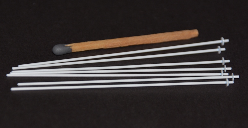

After the merry adventures with the cable tray last weekend, I will take a rest with it before doing the rest of the wiring, and in the meanwhile I have already done something easier, the NT66131 and NT66132 aerials, that go in the "horns" on both sides of the aft stack. They were standard equipment, and therefore, USS McGowan had them:
Although probably obsolete at the time, Jorge Juan still retained them many years later:
Same aerials in a much better view on board USS The Sullivans:
And the final product. To facilitate the process I had to change the angles a bit, but the result is aceptable, I guess.
These elements are extremely fragile, and will be set in place and painted at the very end of the construction, but as for now, they are four things less to worry about.
Nice going and very best regards,
Willie.
PostPosted: Mon Jul 26, 2021 12:08 pm
Posts: 5062
Oh my! Tres dinky! Having fat fingers, I always like to have a couple of extras! Very nice work!! Tom
PostPosted: Sat Jul 31, 2021 7:06 am
Posts: 681
Location: Vigo, Spain
Hi there again, Tom and all the folks,
Tom, thanks once more for your very kind remarks. Coming from such a talented modeler, they mean really a lot for me. And believe me, fat fingers are already a common place in my shipyard.
And after finishing the first radio and ECM antennas, this one was again communications week, having a try at the whip antennas afterwards. For once, I was using only pics from the Spanish Navy, something that is always appreciated.
I have to say that this ship has some surprises reg. antennas.
Firstable, the ones attached to the stacks, 66046 and 66047 whip antennas, these ones:
The picture is not very clear, but this one of D21 Lepanto, ex-USS Capps luckily is:
A very good sketch of this type of whip antennas shows many small details:
Without a 3D printer, to reproduce all this is obviously out of the question, so I had to reduce the elements to a recognizable minimum, and also to use standarized Evergreen profiles to make sure all the elements were identical, i.e., 2.5x2.5 mm. strip for the line termination boxes, 3.2x0.5 mm. strips for the supports, 0.75x0.4 mm. strips for the fundations and 2.5 tube for the insulators bases. The building process is easy, and the proportions fit the purpose quite well:
There are two more antennas on both sides of the flying bridge, and one more aft of mount nr.2, all three hanging on different supports, that have little in common with the ones on the stacks:
For the one on the rear of mount nr.2, I used the same elements as before:
The ones on the bridge were not that easy. I had to use a piece of sprue and reduce it to 3.2 mm., as Evergreen 2.4/2.5 rod or tubing was too thin for this. For the fundations I used 0.5x0.4 strip, only to find that thin as it is, its resistance to make curves is remarkable. Applying a flame was impossible, so I had to heat the (luckily!!!) 3mm. handle of one of my files and make the strips turn on it. Exasperating, because too much heat would melt the piece or make it break; too less would produce no effect at all. Any way, patience is something that we modelers have in great heaps, and at last I was able to produce this :
As for the antennas themselves, I used segments of 0.75 Evergreen rod, that are acceptably telescopic to the 2.5 tube, and made circles with 2.4 rod, opening 0.75 sharp holes in the middle:
And so is the complete set at the moment:
Once everything is in place, I will try to add some detail to the insulators. Who knows, perhaps I can do something else in them.
In the meanwhile, I hope you like the progress, and best regards from this side of the Atlantic,
Willie.
