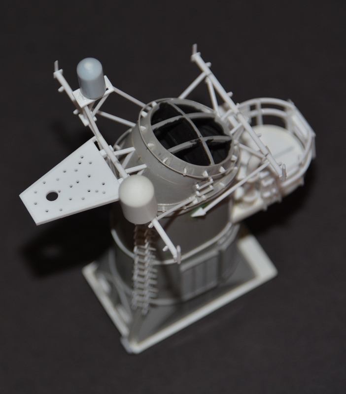

As I am still thinking of solutions for the bloody blast bags, I have had a try with the cable tray in the aft stack.
As it was discussed before in the thread this is what USS McGowan and Jorge Juan had, i.e., flat brackets:
An arrangement that can be confirmed by a better picture of USS Uhlmann:
I have used for this Evergreen 2 mm. channel and 0.25x0.5 mm. strips. The size is too big, but I thought that smaller sizes would be too fragile considering the following steps in the construction.
The tray was very easy to build, and was left to dry before attaching it to the stack, only to find the next morning that for some reason the combination of liquid poly and plastic had made it shrink and therefore comb badly.
I thought at first it could be used anyway, but in a second thought, and as this is so easy to build, I didn�t want to run the risk of making a poly mess in the case the channel offered some resistance, and started the process again, this time in two steps. First step:
And second:
Using a channel I think I get for free the same effect that the original tray shows, plus a further inside channel that can be useful for additional wiring, in case it was necessary.
As I say, the brackets are a bit over scaled, but this is something I have to sacrifice, trading caliber for resistance.
To be continued, and very best regards in the meanwhile,
Willie.[/size]

The next step was the wiring. I tried optical fiber at first, but it will never bend at sharp angles, but simply break, so i had to turn to stretched sprue.
Again, at first I tried to make complete wiring, from deck to every antenna, as things actually were, but the bar and support mess that this stack displays turned into a complete failure any attempt I made. Some of these pieces are really tiny, the stretched sprue has its limits, and after repeated attempts of glueing and ripping, some of them literally disolved in the liquid poly. To crown my miseries, I realized then that I had not set the upper platform in place yet, what made me delete the complete work, because it was now completely useless. I gave up the action for the day, not only having done nothing positive, but having to mend some of the damage caused to the base elements.
S**t happens, and all this s**t at 1/144. I have to say that I kept thinking with every failure about how our common friend Marijn van Gils is going to make the hundreds of ropes in his diorama.
After this, I considered making the wiring in sections, starting with the most obvious elements, and going up to the rest afterwards. I made the tray accordingly, setting six wires, so that they are somehow visible when they are painted, and closing the box with stretched sprue. This :
Then I fixed the upper platform:
And then, I refined the tray, deleting the redundant stuff:
At the same time I was adding the first elements of the wiring, merely schematic.
If I could use CA I would be able to use some other stuff other than stretched sprue, but in the in the middle of the bar mess I have to deal with, CA is for me out of the question. Not only stretched sprue has got its limits. I have got mine as well.
Macro pictures are of course merciless, what else; at two feet distance, I think it looks aceptable.
Nice going and best regards from across the seas,
Willie.[/size]

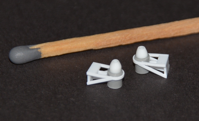

And after finishing the first radio and ECM antennas, this one was again communications week, having a try at the whip antennas afterwards. For once, I was using only pics from the Spanish Navy, something that is always appreciated.
I have to say that this ship has some surprises reg. antennas.
Firstable, the ones attached to the stacks, 66046 and 66047 whip antennas, these ones:
The picture is not very clear, but this one of D21 Lepanto, ex-USS Capps luckily is:
A very good sketch of this type of whip antennas shows many small details:
Without a 3D printer, to reproduce all this is obviously out of the question, so I had to reduce the elements to a recognizable minimum, and also to use standarized Evergreen profiles to make sure all the elements were identical, i.e., 2.5x2.5 mm. strip for the line termination boxes, 3.2x0.5 mm. strips for the supports, 0.75x0.4 mm. strips for the fundations and 2.5 tube for the insulators bases. The building process is easy, and the proportions fit the purpose quite well:
There are two more antennas on both sides of the flying bridge, and one more aft of mount nr.2, all three hanging on different supports, that have little in common with the ones on the stacks:
For the one on the rear of mount nr.2, I used the same elements as before:
The ones on the bridge were not that easy. I had to use a piece of sprue and reduce it to 3.2 mm., as Evergreen 2.4/2.5 rod or tubing was too thin for this. For the fundations I used 0.5x0.4 strip, only to find that thin as it is, its resistance to make curves is remarkable. Applying a flame was impossible, so I had to heat the (luckily!!!) 3mm. handle of one of my files and make the strips turn on it. Exasperating, because too much heat would melt the piece or make it break; too less would produce no effect at all. Any way, patience is something that we modelers have in great heaps, and at last I was able to produce this :
As for the antennas themselves, I used segments of 0.75 Evergreen rod, that are acceptably telescopic to the 2.5 tube, and made circles with 2.4 rod, opening 0.75 sharp holes in the middle:
And so is the complete set at the moment:
Once everything is in place, I will try to add some detail to the insulators. Who knows, perhaps I can do something else in them.
In the meanwhile, I hope you like the progress, and best regards from this side of the Atlantic,
Willie.[/size]
Posts: 5068
Post by Fliger747 »
Willie:
Where do you get the huge match sticks? Certainly your parts can't be so tiny! Kidding aside, wonderful clean and detailed parts. Rather amazing how many parts of all sorts must be replicated in even a small ship such as a destroyer. I seem to have penchant for knocking antennas loose once attached to the model!
Best regards: Tom
Willie
Posts: 690
Location: Vigo, Spain
Post by Willie »
Hi again, Tom and all,
Fliger747 wrote:I seem to have penchant for knocking antennas loose once attached to the model!
Welcome to the so called Two Left Hands club. It has happened to me so often that I have had to refrain me from setting small or delicate things in place before everything else is. You cannot see them kind of finished, but it will save lots of trouble in the long run.

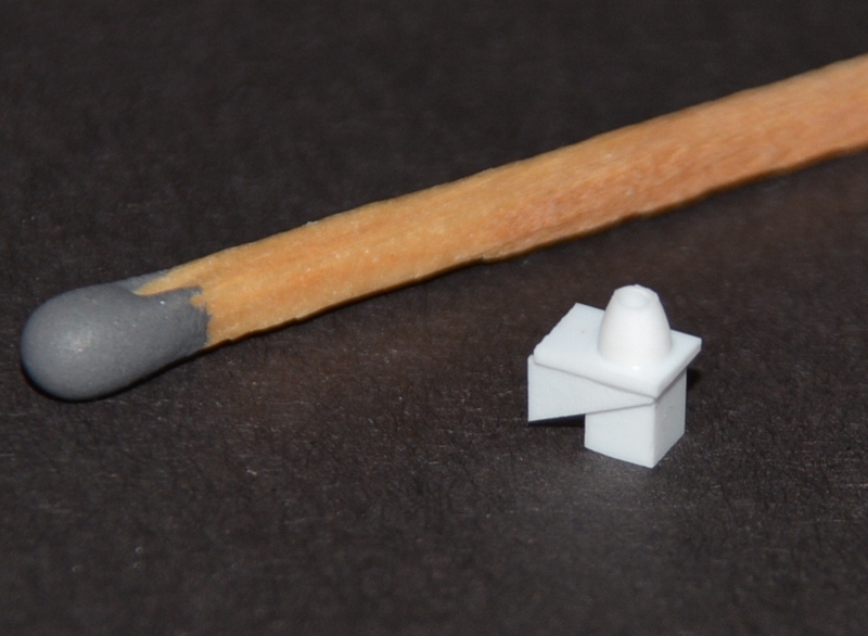

As for the antennas, I thought yesterday that they were somehow bare. Not that much can be done even in this big 1/144 scale, but I have given them a further push today. Firstable I made a small stretched sprue spring on a 0.75 mm. needle, and then I cut several circles from it:
Then I made some small cones carving with sandpaper sections of 2.5 mm. Evergreen tube:
Then I slid a circle and a cone in place, sealing the the thing with a small drop of liquid poly:
Not that it is close to reality, but at least it will fill the gap for now. If in the future I imagine a better way to do this, and as these pieces were very easy to make, I can dispose of them with no hesitation, and make a new set.
