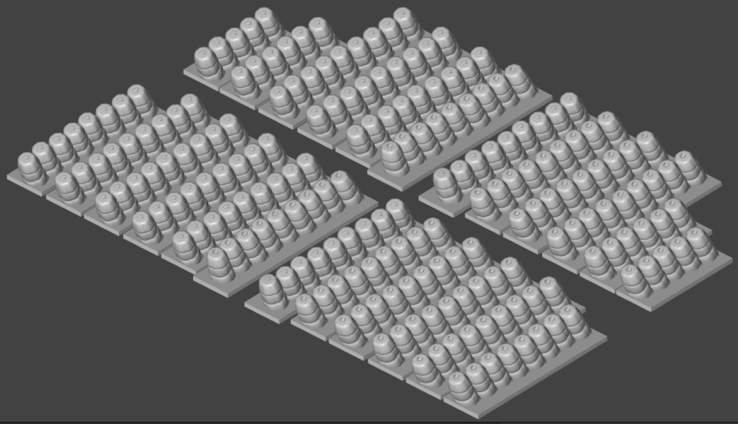

Here's all 200 hammocks mostly in groups of 9.
A battalion of hammocks

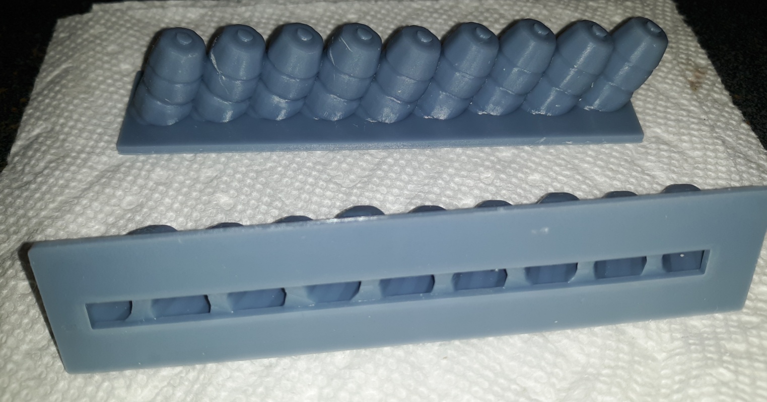

The hammocks are on "trays" of 9 hammocks each.  All hollow to save resin/money and weight.

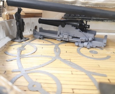

The gun circles (rails on the deck for the pivot guns to slide on) were hand cut from sheet styrene and were too sloppy, too wide, and too thin. I modeled new ones using the 3D model of the gun as a reference for size and proportion. These got printed in one go, but unlike the oars, I left more space between things so the supports would stick to the parts.
New gun circles were modeled using the 3D model for the guns as a reference to make them more accurate; and printed all in one go.

More elaborate deck circles printed
Bow deck circles painted Steel
Stern deck circles painted Steel

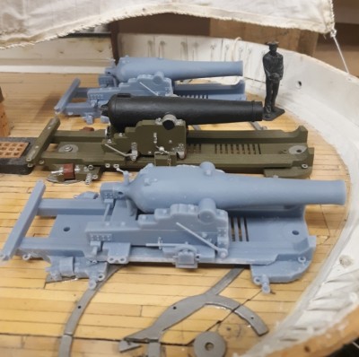

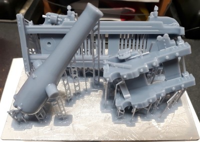

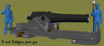

The parts of the model that make it a warship - the pivot guns all painted.
Bow pivot gun
Bow pivot gun
Stern pivot gun
Stern pivot gun
without paint, for reference
Pivot gun just printed

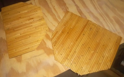

Seam between hammock pieces and bulwark covered with a strip of basswood.  Still 3/4 of the rails to do like this.

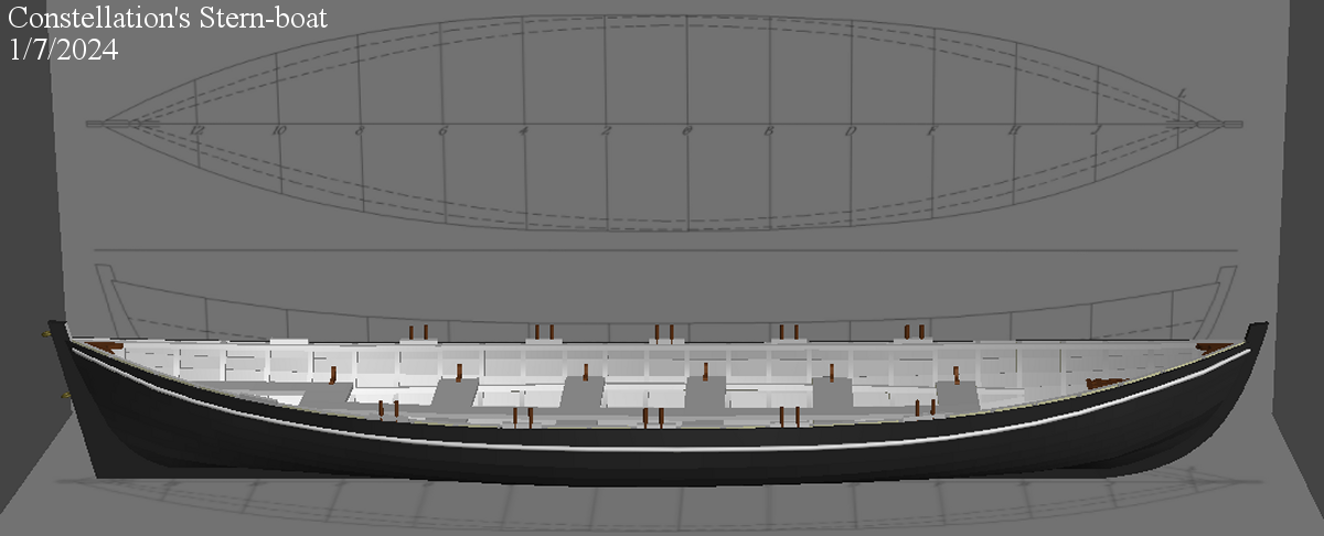

3D Printed Quarter Boat
Post by JerryTodd »
Once the 2nd cutter was printed, I focused more on the quarter boats. It's one 3D model, but two of them get printed to eventually hang on davits on the aft quarters of the ship.
x-ray view of quarter-boat in progress
3D model of quarter-boat
These boats look very much like the cutters, but are a little longer, not as tall, with narrower sterns. At 1:36 scale, they're about 8-7/8th inches long (22.5cm). All the boats will be too long to print in one piece, and are made in halves, but both quarter-boats can be printed at once with room to spare.

3D model completed
3D model completed
The model set-up for printing in the slicer
Whale boat printed
Whale boat printed
Both halves next to each other

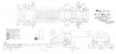

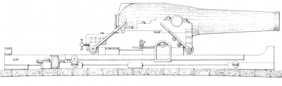

John Dahlgren submitted a drawing, dated July 31 1850, proposing his idea of the ideal armament for "First-Class Frigates" suggesting they be armed with six 10 inch pivot guns on the spar deck, and 26 9 inch guns on the gun deck. The Navy rejected the proposal, mostly; they opted for two 10 inch pivots and the gun deck armed with 8 inch shell-guns and 32# shot guns, and the big frigates, razees (cut down frigates) were armed in this manner, including Constellation, the newest, and largest sloop-of-war that wasn't a razeed frigate.
10 Shell Gun ~ Pivot Carriage<br />from Dahlgren's 1850 proposal
On a visit to the ship, years ago, they showed the Mississippi Pivot Gun plans, saying that was what Constellation was originally armed with; which were eventually replaced with Parrott rifle pivots, a plan they also showed me. I took some pictures of the Parrott plans, but went to the National Archives in College Park Maryland, to get a proper copy of the Mississippi plan.
On August 26 1854, the sloop-of-war Constellation would be launched. Almost a year later, June 1855, the plan for the 10 inch pivot guns for the side-wheel frigate Mississippi was drawn. Another year on, Constellation was commissioned on July 28 1855.
Plan for Mississippi's 10 inch pivot guns of 86cwt
It seemed to me to be unlikely the ship would be armed with a gun from a plan drawn a year after her launch, while her razeed contemporaries were armed with the Dahlgren around the same time, 1853~1856. So far, I haven't been able to track down any sort of documentation that can nail down precisely which 10 inch shell gun Constellation got. The Mississippi gun is, so far as I've seen, always referred to as a "10 inch shell-gun of 86cwt" while the Dahlgren simply referred to as a "10 shell-gun" or a "X inch shell-gun." I haven't yet found a references to Constellation's guns as "86cwt." The 10 inch Dahlgren is 120cwt, and I've never seen anything referring to it in that way.
Since it's really isn't that big a job, being able to 3D print now; I decided to switch the model's pivot guns to Dahlgrens. Since I was already making the 3D model for my Naval Gun project, it didn't really add to the work-load.
3D model of X inch Dahlgren pivot
The slide for this gun, while very like the Mississippi gun's slide, was wider and shorter. I used the slide from the 3D model of the previous pivot gun, shortened and widened, which saved some time and effort.
I printed the gun in three parts; slide, carriage, and tube; to facilitate painting, and reducing what I'd need to reprint if one of the parts failed. The first gun lost one of it's rollers, but I could fix that without reprinting. The second gun printed perfectly.
Second gun, fresh off the printer
New Dahlgrens next to the gun they're replacing
A shorter slide meant I needed to make new deck tracks, which I 3D modeled like last time, but I made them short/thinner to be more in scale.
The guns are mounted on access hatches, fore and aft. I removed the old tracks, sanded the scars best I could, and re-coated the hatch decking with polyurethane. The newly printed tracks were primed, painted, glued onto the hatches, painted again, and the whole thing was clear-coated. The guns too were primed, and the tubes painted and detailed, but the carriages and slides are waiting to be painted the same olive color as the old set.
Deck hatches cleared of old tracks and refinished.
Aft pivot
Aft pivot
Forward pivot
Forward pivot
