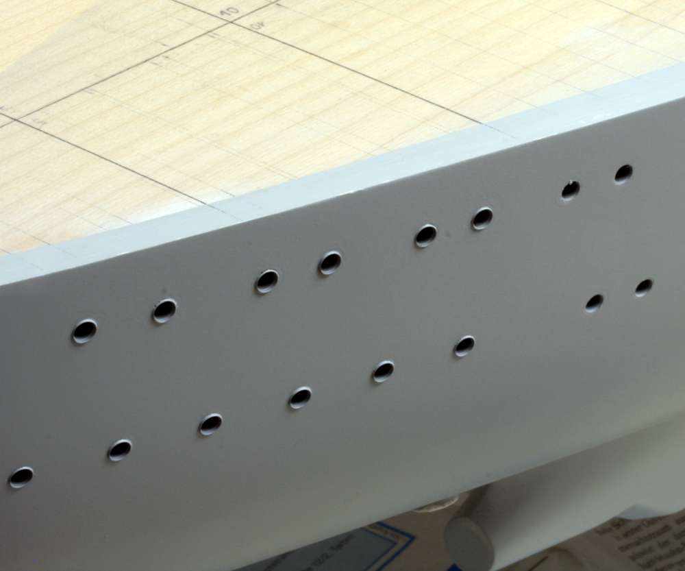

Hi,
first sanding and priming ... obviously more to come ... :heh:
:wave_1:

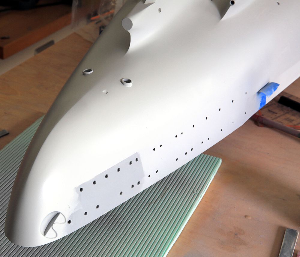

Hi,
finally some work done on Bismarck. Installed the rest of the portholes. There were two different variants for unarmoured up to frame 10.5) and armoured areas of the outer shell.
Mre to come in the future ... :thumbs_up_1:
