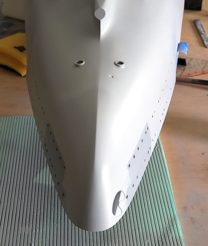

PostPosted: Fri Jan 24, 2014 1:59 pm
Posts: 555
Hi,
first sanding and priming ... obviously more to come ... :heh:

PostPosted: Sun Aug 09, 2015 1:06 pm
Posts: 555
Hi,
finally some work done on Bismarck. Installed the rest of the portholes. There were two different variants for unarmoured up to frame 10.5) and armoured areas of the outer shell.
Mre to come in the future ... :thumbs_up_1:

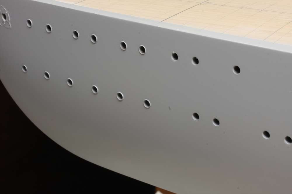

PostPosted: Sat Aug 15, 2015 8:11 am
Posts: 555
Hi,
weekend = modeling time :woo_hoo:
I call the aft ship with its tearoff edge finished in terms of shape.
