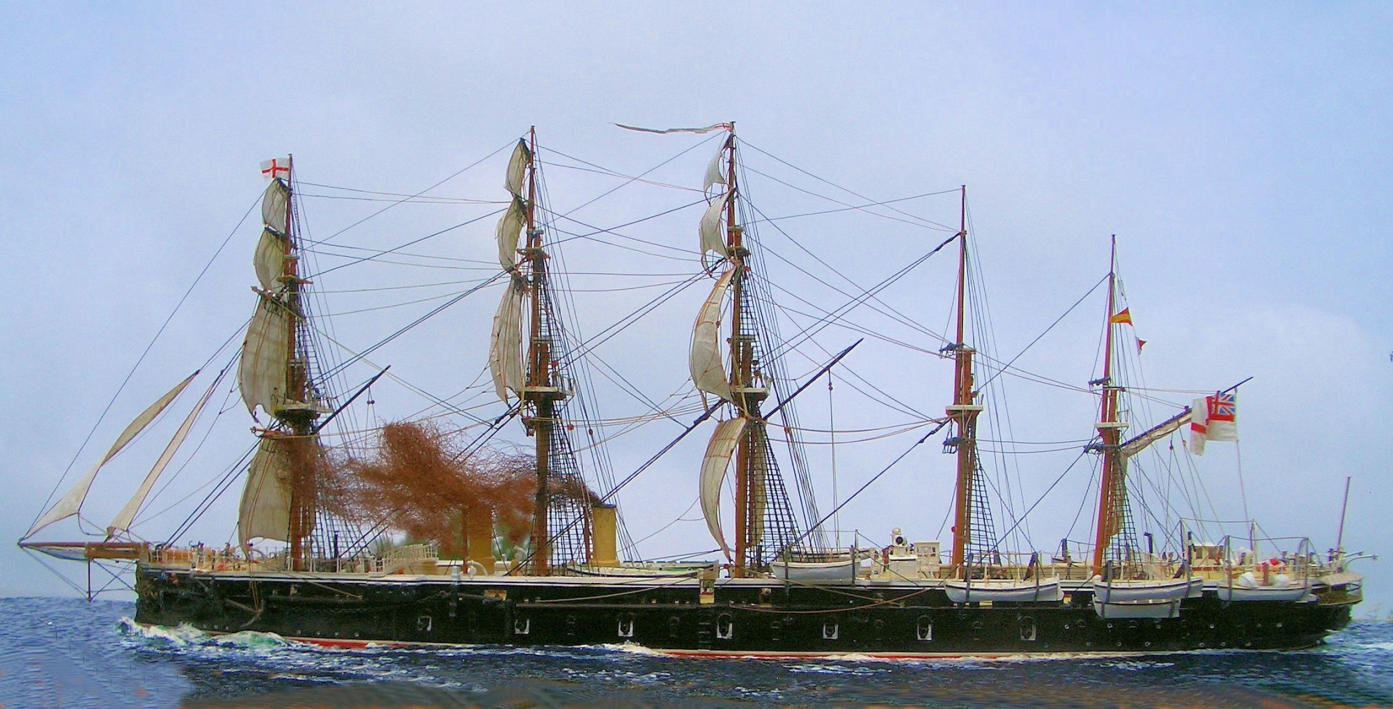

Hello all again.--
the tedium and stress of rigging a ship this delicate is considerable
The images below are still a work in progress
No reefing tackles, Yard braces or leech control lines etc have been done yet;
The amount of required line is simply staggering when studied and investigated.....! :wacko:
already I have only managed around 50%-- and probably my will may be caving in shortly!
The problem arising is that to add more.... risks breaking existing!
I will have to compromise
( Perhaps I should have built it in a bigger scale !! LoL :big_grin:
More tomorrow!

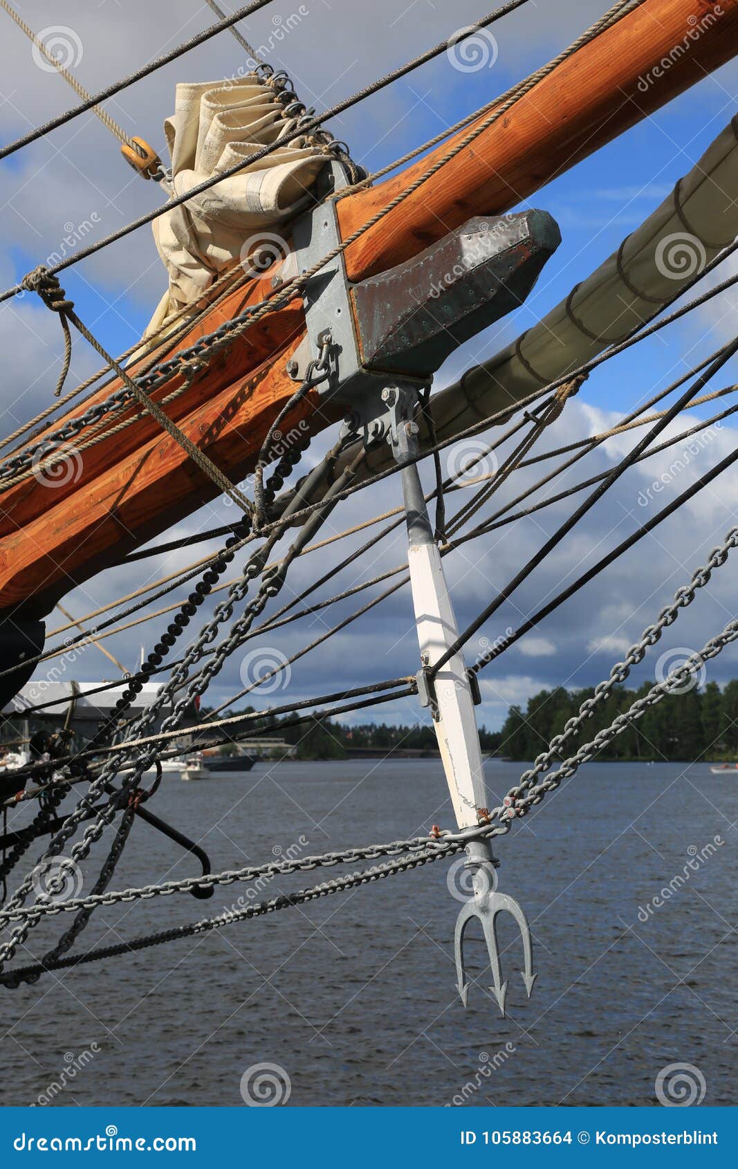

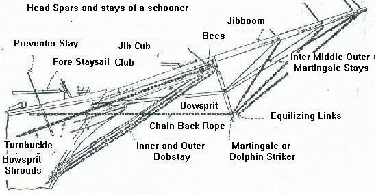

"Dolphin Striker " is a bit mean-..!
-especially as some had a point ( decorative...?!) on the lower end.....
the usual format... ( images courtesy of ShutterStock online)
stock-photo-a-wooden-bowsprit-and-a-dolphin-striker-mounted-underneath-it-on-a-classic-sailing-ship-2341688065.jpg
stock-photo-a-wooden-bowsprit-and-a-dolphin-striker-mounted-underneath-it-on-a-classic-sailing-ship-2341688065.jpg [ 993.56 KiB | Viewed 461 times ]
a bit more vicious looking... with intent...!
stock-photo-woolwich-royal-arsenal-pier-london-uk-dolphin-striker-or-martingale-boom-of-brig-760474900.jpg
stock-photo-woolwich-royal-arsenal-pier-london-uk-dolphin-striker-or-martingale-boom-of-brig-760474900.jpg [ 448.17 KiB | Viewed 461 times ]
and is there no end to the imagination...? :scratch:
danish-three-masted-schooner-loa-dolphin-striker-form-trident-other-mast-close-up-time-regatta-tall-105883664.jpg
danish-three-masted-schooner-loa-dolphin-striker-form-trident-other-mast-close-up-time-regatta-tall-105883664.jpg [ 218.58 KiB | Viewed 461 times ]

The rigging of this , just under 43/4 inch.... ( 115 mm ) long ship is taking some doing....
==> and is costing both frayed nerves and tempers... :Mad_5: :censored_2:
In 1/350-double the scale--it would be ( probably ) clearer to see,
and better proportioned for my 1/1 scale eyesight and tweezers ...!!-
-even though I am working x 5 magnified....
anyhow-- below some images ...

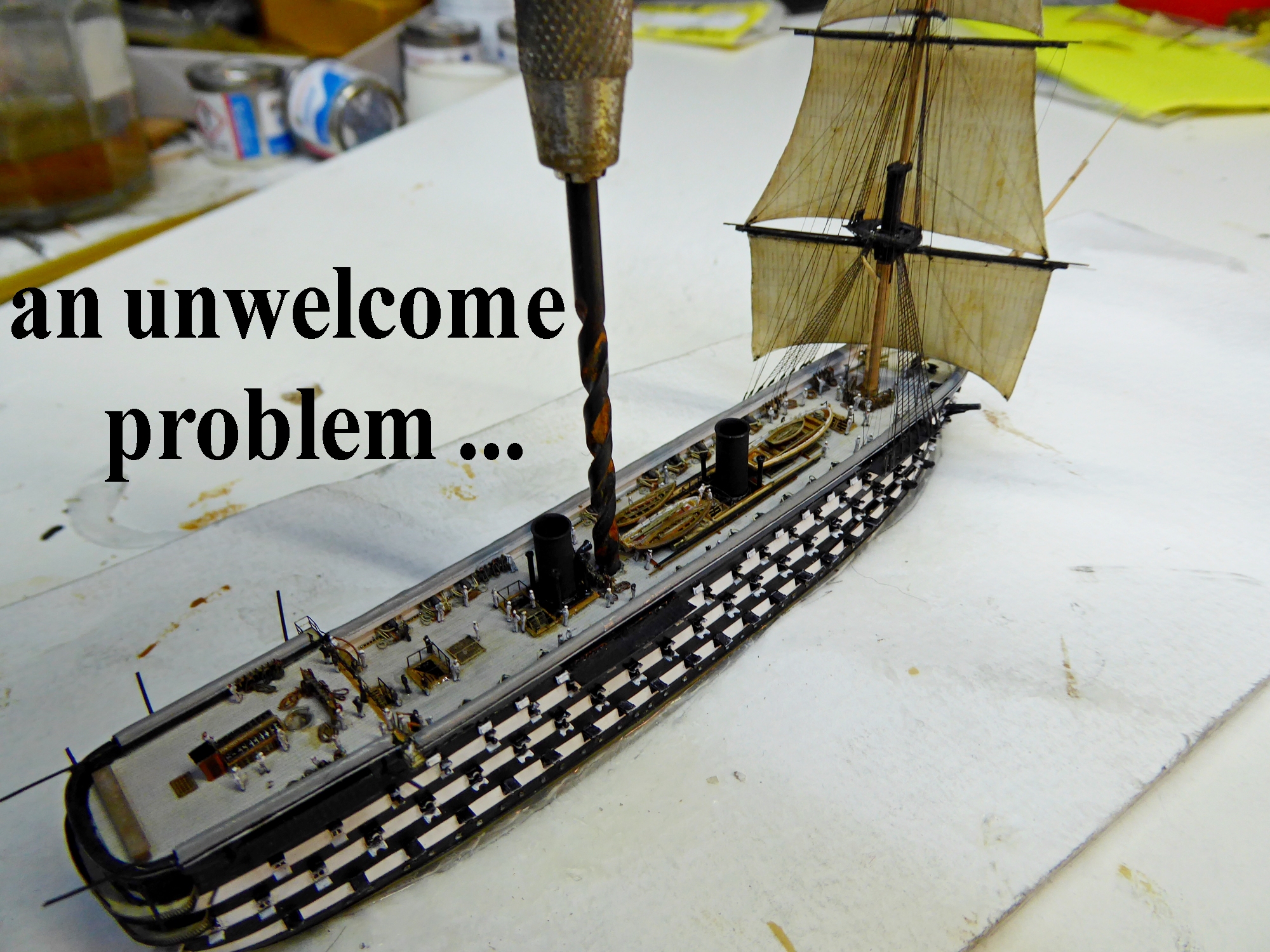

Upon ' masting .....I encountered either ,.... my inability to measure stuff correctly...(?!)
or ....
the phenomena of paint build up on the bottom of the mast; as it simply Would NOT Fit the aperture :mad_1: : :censored_2:
ergo quite brutal intervention....

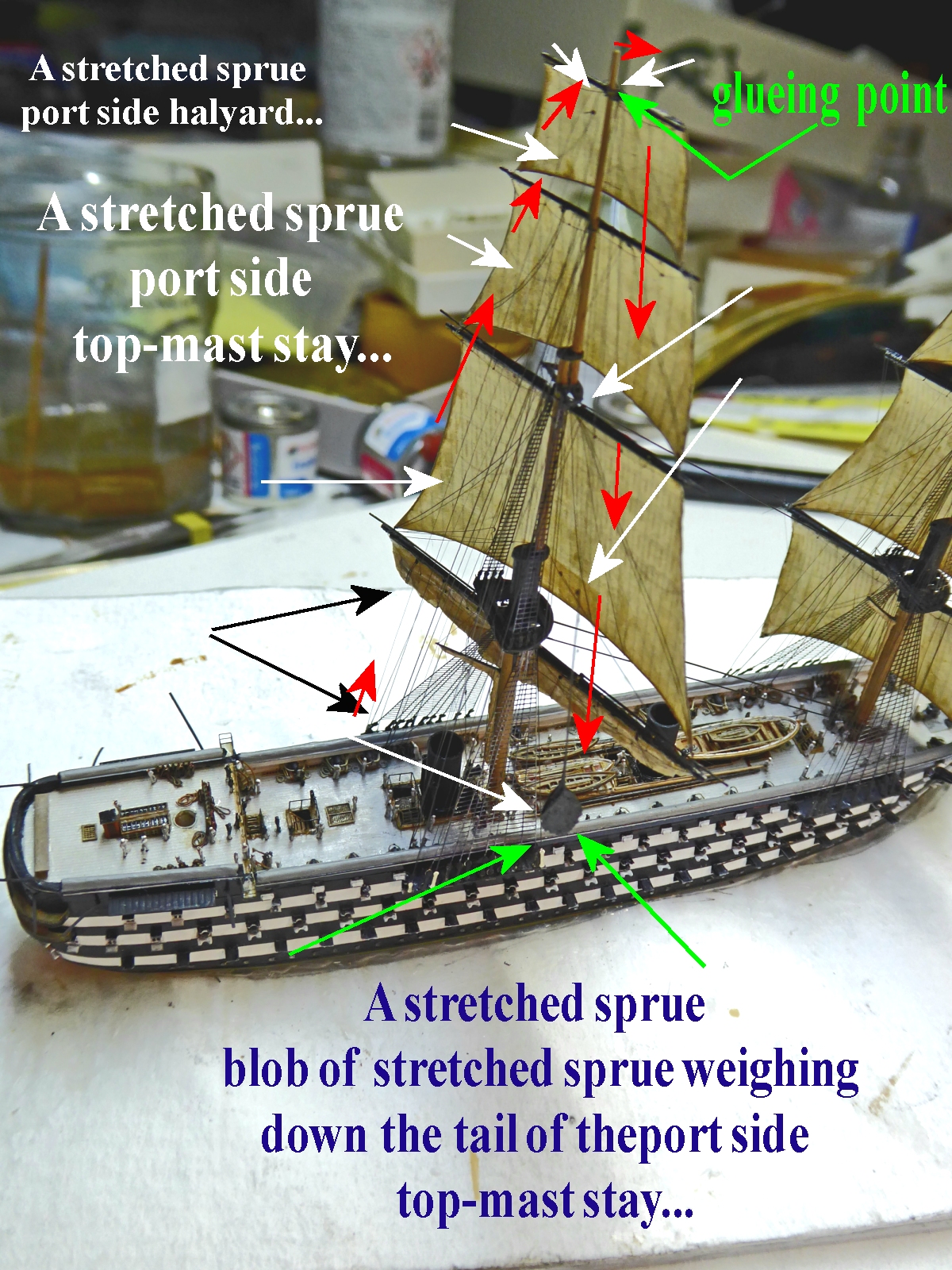

The main problem with rigging within the constraints of this small scale is........
... that for every successfully applied piece of rigging-- One can break or ruin a lot more...!
Persistence, doggedness, gritted teeth and a closed model room door ( that way the family cannot hear the shouting and swearing tantrums ! :big_grin: :heh: )
can.... Eeeeeeventually ....lead to success
below is illustrated how the stretched sprue is attached to the dead-eye-
-then draped into desired position,
and weighed down with a ( very small and light )blob of
stretched sprue plastic with a ' tail ' that has been tacked onto the loose tail-end of the rigging.
Nerve racking and the attrition & waste rate is high...
