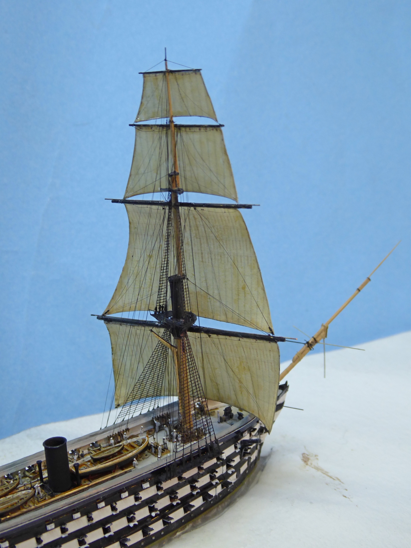

the tedium and stress of rigging a ship this delicate is considerable
The images below are still a work in progress
No reefing tackles, Yard braces or leech control lines etc have been done yet;
The amount of required line is simply staggering when studied and investigated.....! :wacko:
already I have only managed around 50%-- and probably my will may be caving in shortly!
The problem arising is that to add more.... risks breaking existing!
I will have to compromise
( Perhaps I should have built it in a bigger scale !! LoL :big_grin:
More tomorrow!

PostPosted: Fri Nov 29, 2024 3:12 pm
Posts: 8339
WOW! That rigging looks amazing. And complicated. And stressful.

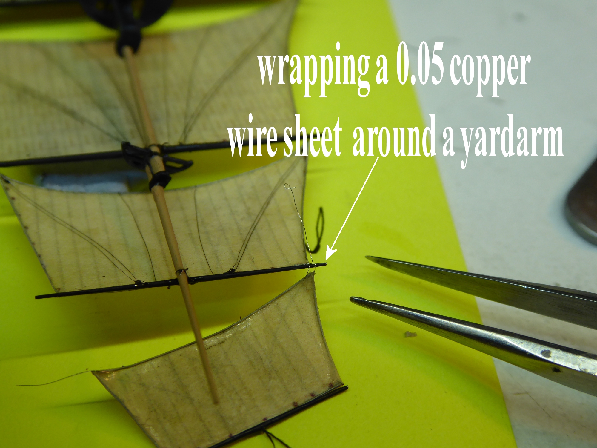

Assembling the sails/yards onto the mainmast...
==> with it supported in the loving embrace of 'blue-tak on a post-it note block,
ensures constant angles of oblique yards to mast
I use 0.05 copper wire ( very pliable) glued onto the clews as sheets,
so that they can be wrapped around the yard-arms ( almost) imperceptibly to give clew to yard location
to ensure the sheeting gap is not too small or too large ( fine line of balance!)
and a very fine slightly spring thread to tie the yard arms to the mast

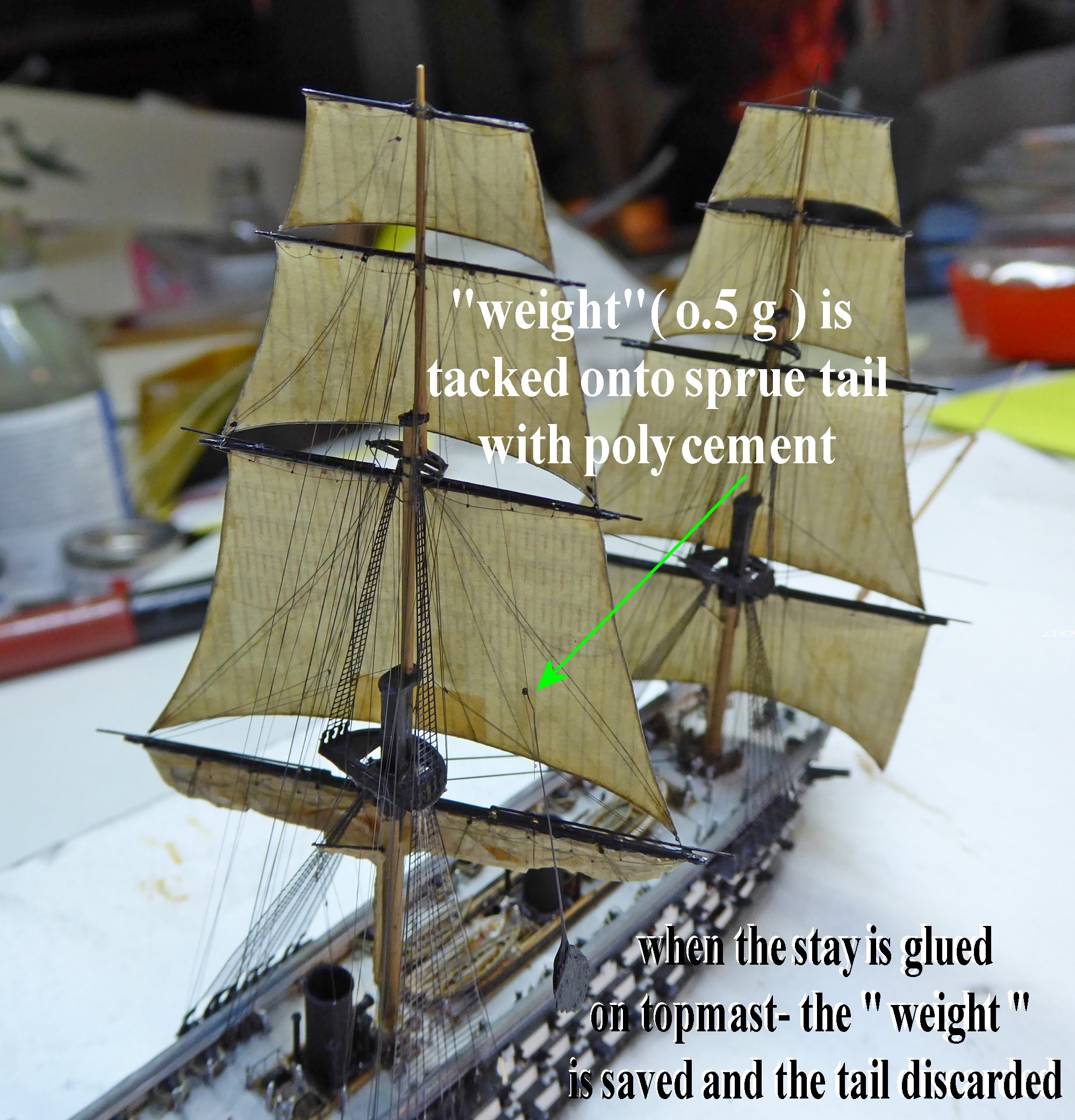

The main problem with rigging within the constraints of this small scale is........
... that for every successfully applied piece of rigging-- One can break or ruin a lot more...!
Persistence, doggedness, gritted teeth and a closed model room door ( that way the family cannot hear the shouting and swearing tantrums ! :big_grin: :heh: )
can.... Eeeeeeventually ....lead to success
below is illustrated how the stretched sprue is attached to the dead-eye-
-then draped into desired position,
and weighed down with a ( very small and light )blob of
stretched sprue plastic with a ' tail ' that has been tacked onto the loose tail-end of the rigging.
Nerve racking and the attrition & waste rate is high...

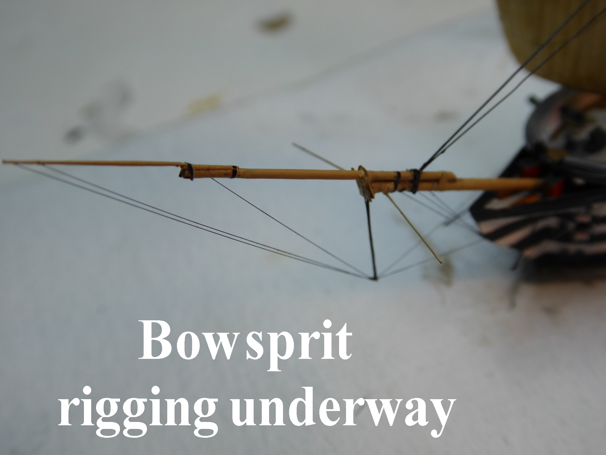

The bowsprit rigging ( not complete yet ) I did with 0.047 Nitinol self straightening wire f
from Modellkasten
This was significant, as the bowsprit rigging performs a structural function-
for when the 3 x headsails are attached to it
detail below of Nintinol wire

It is a slow grind.... there is sooo much rigging, and it needs to be to scale (ish)! so that its
handleable for 1/700 sailors hands. the procedures are slow, fiddly and dull to describe.
the best made plans-of-procedure seldom work out--
needing much tweezer acrobatics aft where the mizzen and main mast yard braces over-lap in the same air space!
any how herewith some images,
general overview of status quo yesterday 12 /12/ 24
more detail within...
