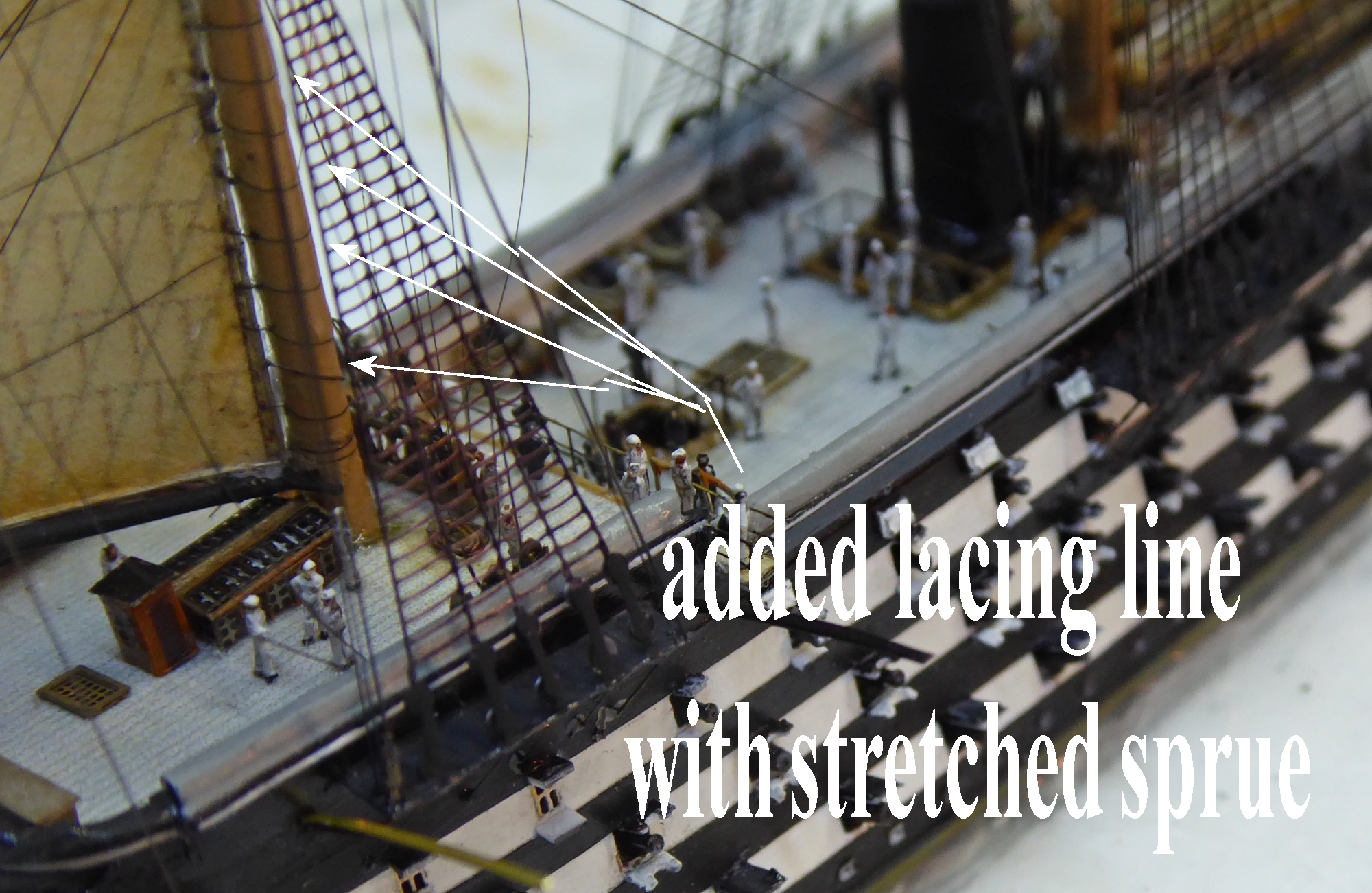

The main problem with rigging within the constraints of this small scale is........
... that for every successfully applied piece of rigging-- One can break or ruin a lot more...!
Persistence, doggedness, gritted teeth and a closed model room door ( that way the family cannot hear the shouting and swearing tantrums ! :big_grin: :heh: )
can.... Eeeeeeventually ....lead to success
below is illustrated how the stretched sprue is attached to the dead-eye-
-then draped into desired position,
and weighed down with a ( very small and light )blob of
stretched sprue plastic with a ' tail ' that has been tacked onto the loose tail-end of the rigging.
Nerve racking and the attrition & waste rate is high...

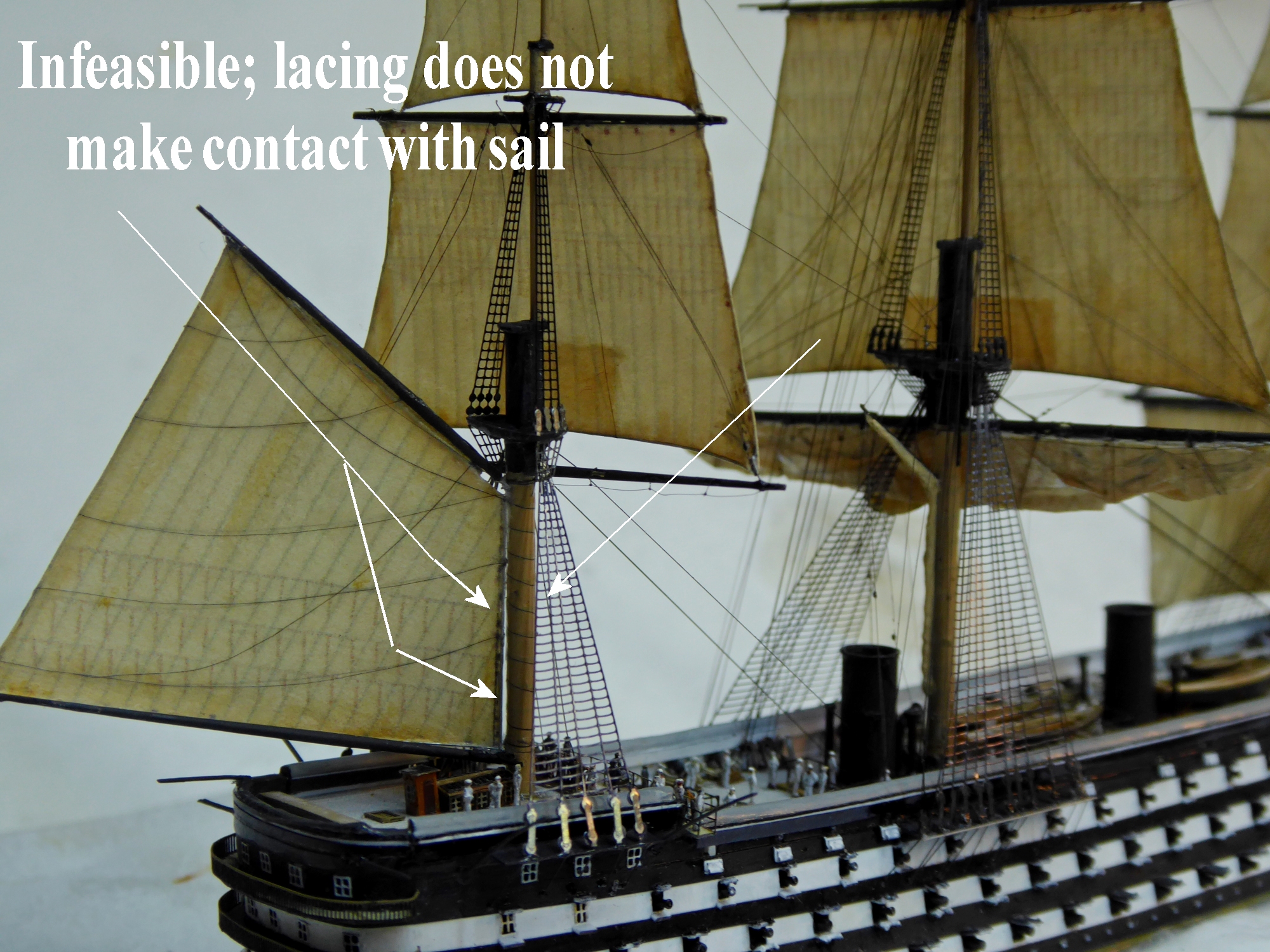

I had wrapped the mizzen mast with black thin thread to simulate the loose lacing of the spanker sail ,
which always leaves a small gap between sail and mast,--
==> however it was not to my liking when the sail went on

I added the ' extension of the lacing to the 'eyelets ' with stretched sprue
it looks significantly better and more feasible

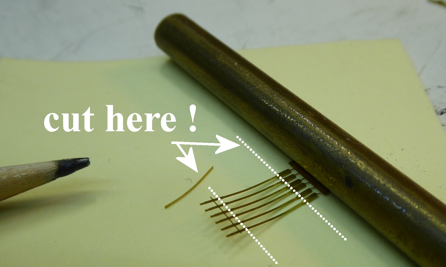

I had previously inserted the aft davits , made of thin PE strip
cut out of parts from an old over-scale PE detail set into the hull ,
they were strong
but only O.4 mm thick ( the correct width @ .75 mm) though )
I thickened them up using some old ( 1998!) WEM 1/350 oars as another layer.
The davits have a gentle curve--I had to repeat that and x 4 they all had to same!
I inserted the curve in collectively on a note pad with a small brass tube
tacked on at the inboard end only with thinned matt varnish ( quick grab but strength!)
aligned and then CA glue along the outside gap applied with my 0.1mm wire applicator in a pinchuck 'tool ' :thumbs_up_1:

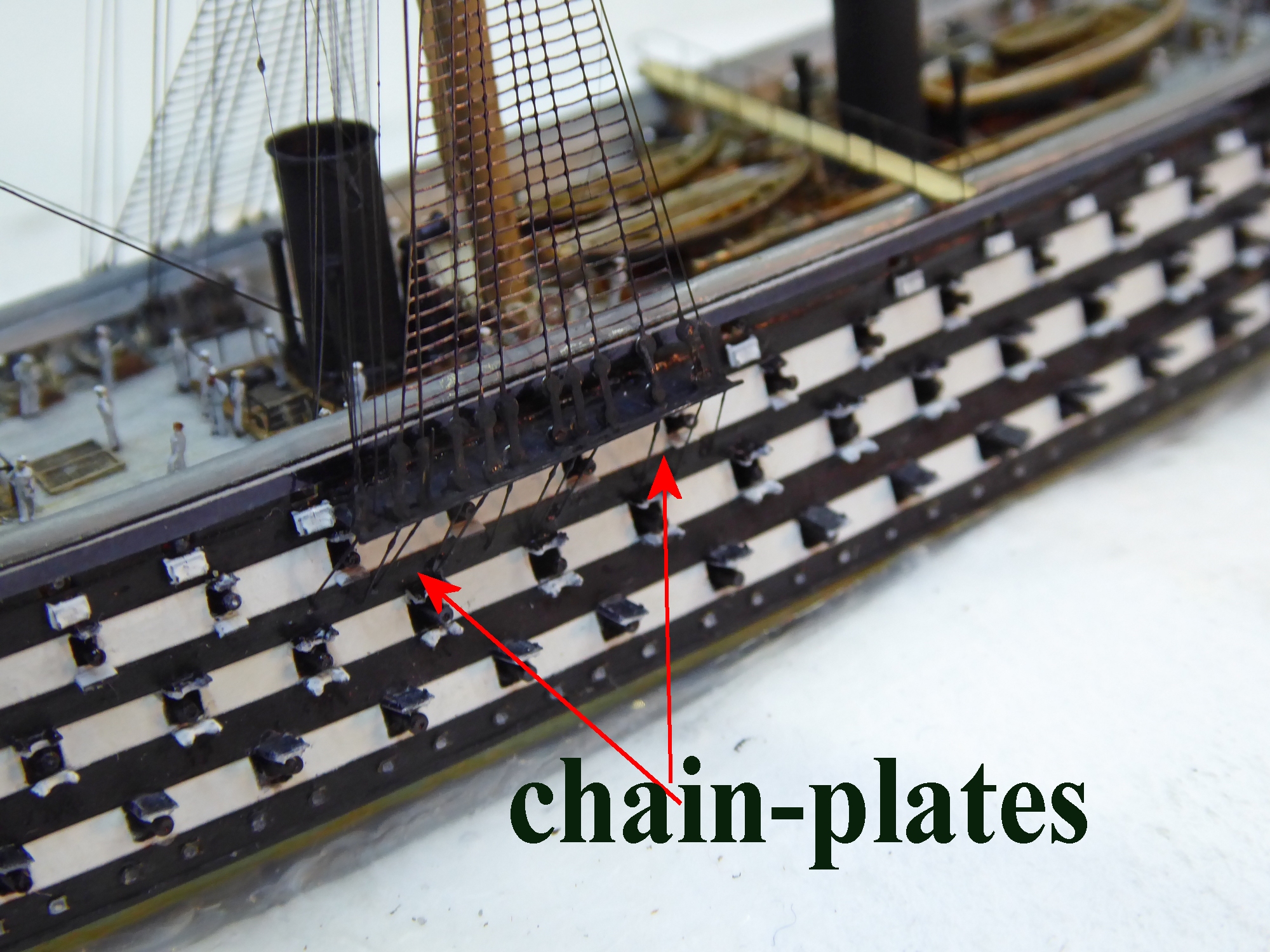

I also added the chain plates to the shroud channels
and then 'cleaned up' the outer edge of the channels
( have chain-plates and shrouds terminating there) with a piece of 0.1mm wire

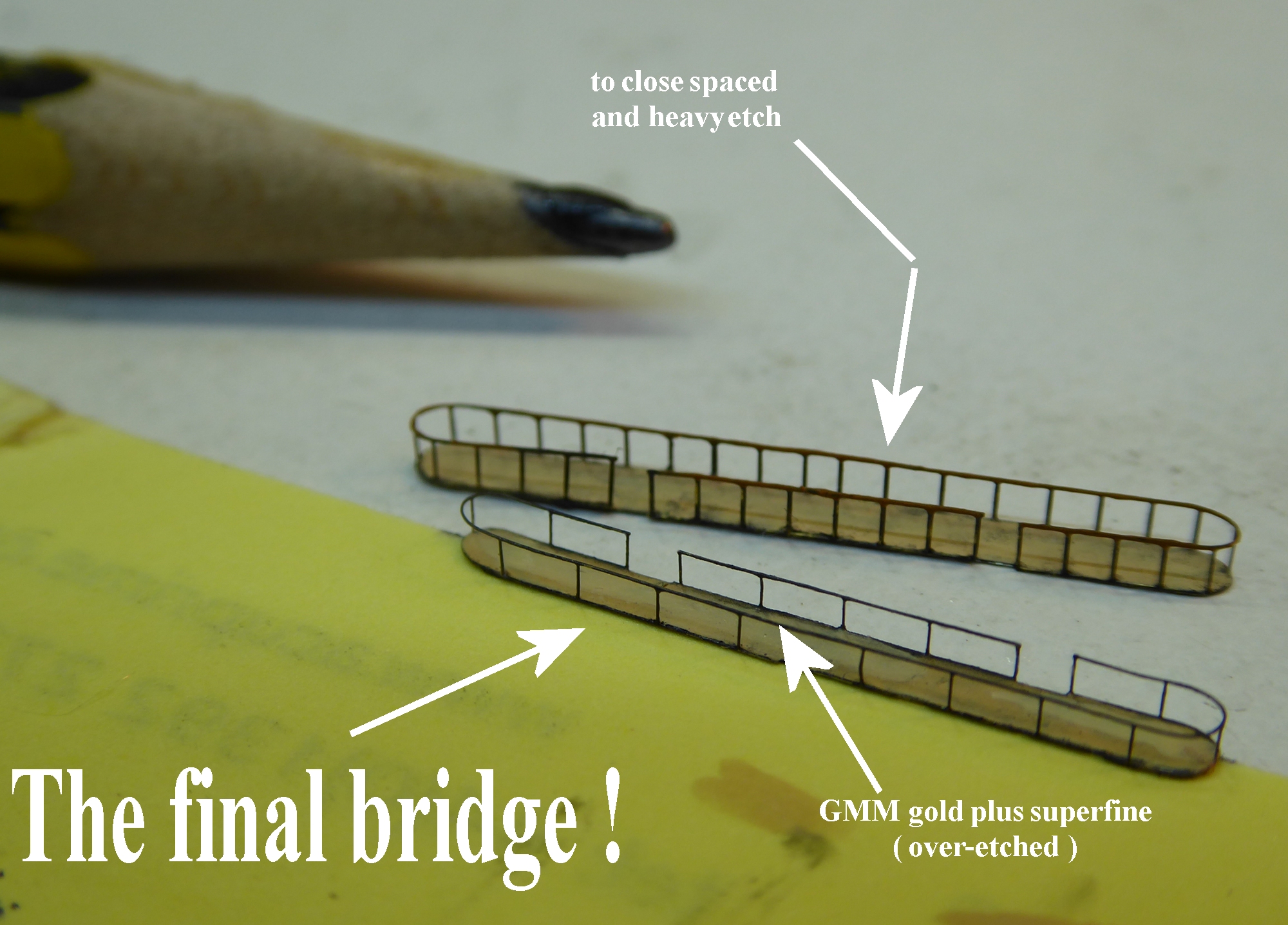

Keen eyed observer will spot that a bridge has been installed ! :thumbs_up_1:
I made the fourth version (!!) using some GMM PE gold plus superfine railing that was over-etched
( thinner and cheaper PE 'seconds...)-- just how I like it! :heh:
