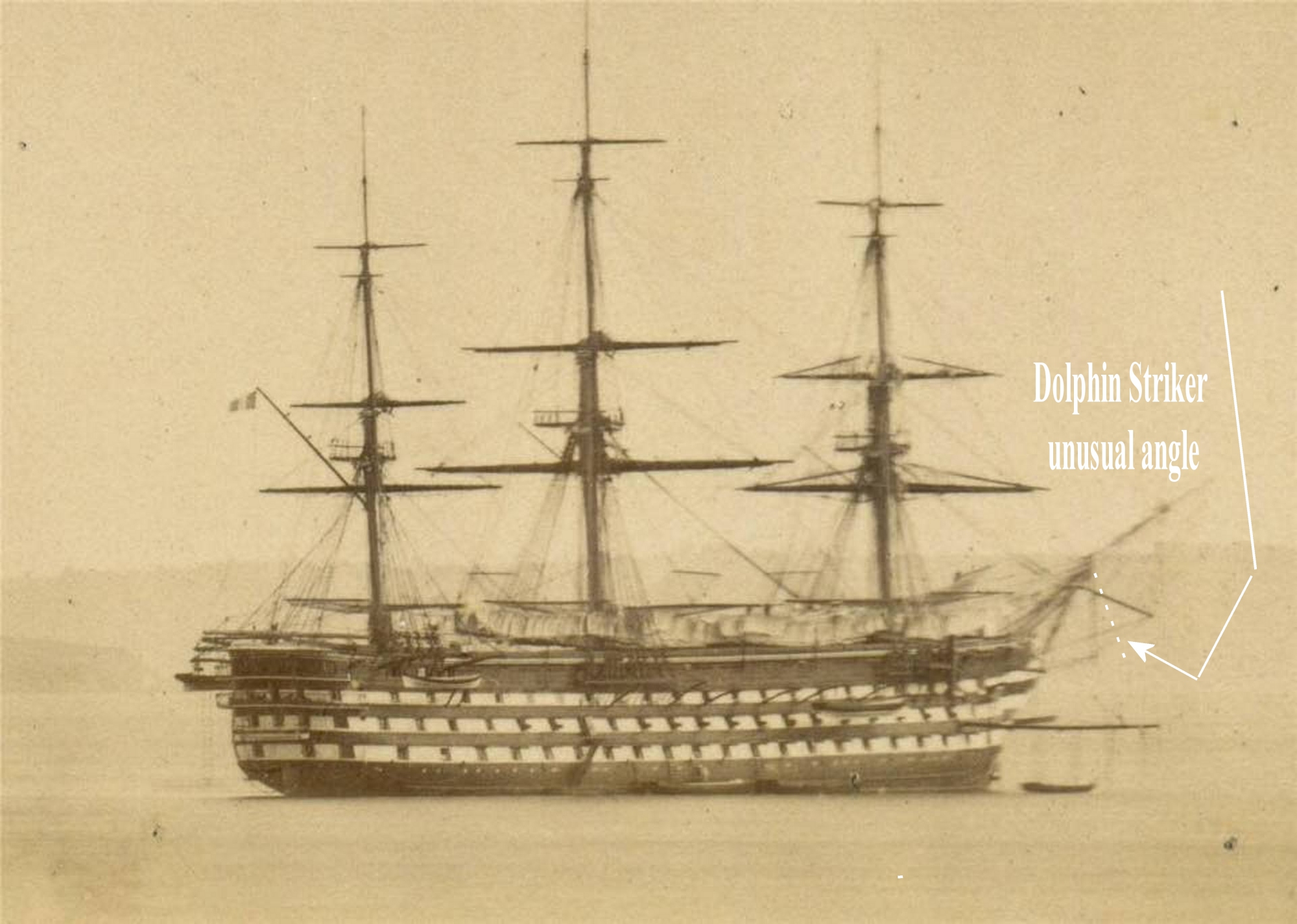

interim quandary -Dolphin striker..
.-that being the spar that acts as a truss at the underside of the bow-sprit
Traditionally....( and in my amateur engineering understanding) is is set perpendicular to the bowsprit
and so it was designed on the Bretgane ....
However-- all ( competent ) images and the some photo where the bow is visible
show a different picture...
the famous ' Roux painting.. that inspired me to build this ship shows the Dolphin striker at an unusual angle
as does a painting by 'Roux of ship Borda
as does this engraving ( based on a photo surely? )
as does this one ....
and not confined to bg 3 deckers
but confirmed in my mind by the sole photo of the ship with bowsprit visible
.( I have already done it like that on my model-)
-but I want to know...Why??? :big_grin: :big_grin:
it would be at such a jaunty angle rather that the more usual 90 degrees to the spar?
more images of the model shortly! :thumbs_up_1:
