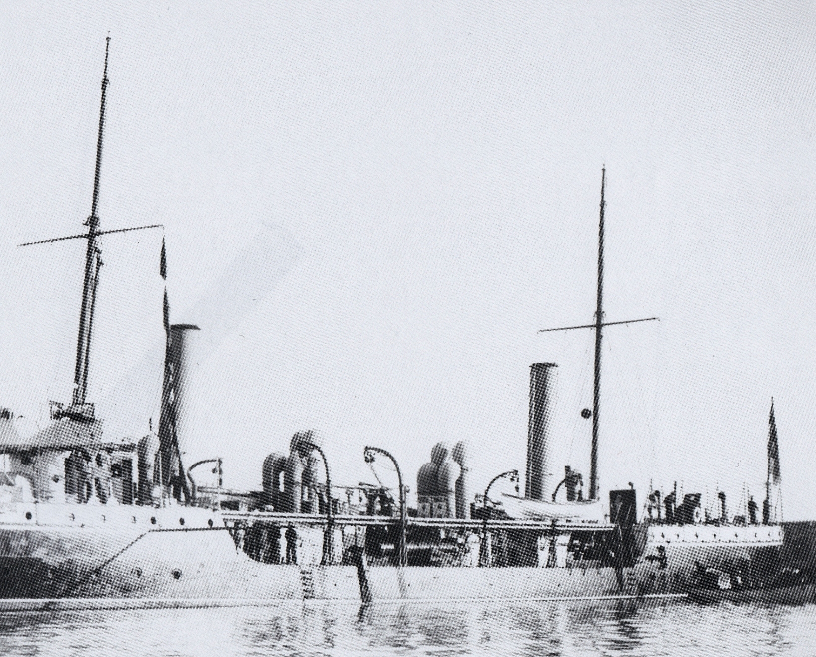

and discovered a useful davit photo
and amazingly....( hard to find in my time period )
another overall view from port=-- with ship at mooring
whilst not ever so sharp or clear--it does illustrate well the considerable height of the Aft ensign staff
-with my model ship being ship underway...
==> contrary to usual familiar RN practice ( flown from the gaff of mainmast ...)
My Ensign staff will be adorned with a White ensign!
later period
and again ---with a different member of the class
Can anyone shed any light on this flag practice--other than the obvious absence of a gaff spar...?
more soon

Pieter
- Posts: 1609
Re: HMS Halcyon 1894 (Dryad class) 1/350 Torpedo Gun-Boat
Looks like the main topmast has a semaphore attached . Maybe this interfered with normal flag practice.

Boat covers in boats of old had various means of the hoist passing through them
the covers main purpose was keeping the contents ( sails, spars, supplies etc )dry
ultimate 'waterproofness ' was not primarily vital-
-as all water running down the hoists would have dropped through the floorboards and escaped through the drain-holes
( which are stoppered at launch! )
thus the covers --in the instance pictured below--- have a slot ( that can be laced closed ) to allow fitting of covers
with boat on the hoists
where the hoists are further 'twards midships--there is often a laced up joining slot
'twards the inboard side from each hoist position
such as here on a Dryad class ship
You can clearly see the laced up join fwd
with stacked / nested boats like on Normandie--its trickier
the ' main boat is on the hoists--- the nested boats hoists are slack ( as the boat is not hanging ) and the the slack hoist
are led through to the davit
