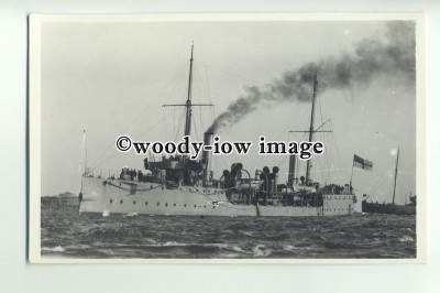

According to Perkins, the funnels were different AND the distance between the funnels were different.
Which ship is on the photo and which is on the plan?
Halycon had thicker funnels and less distance between them compared to e.g. HMS Hazard.

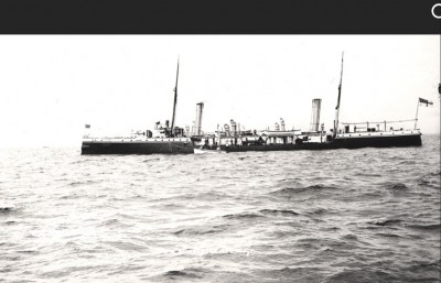

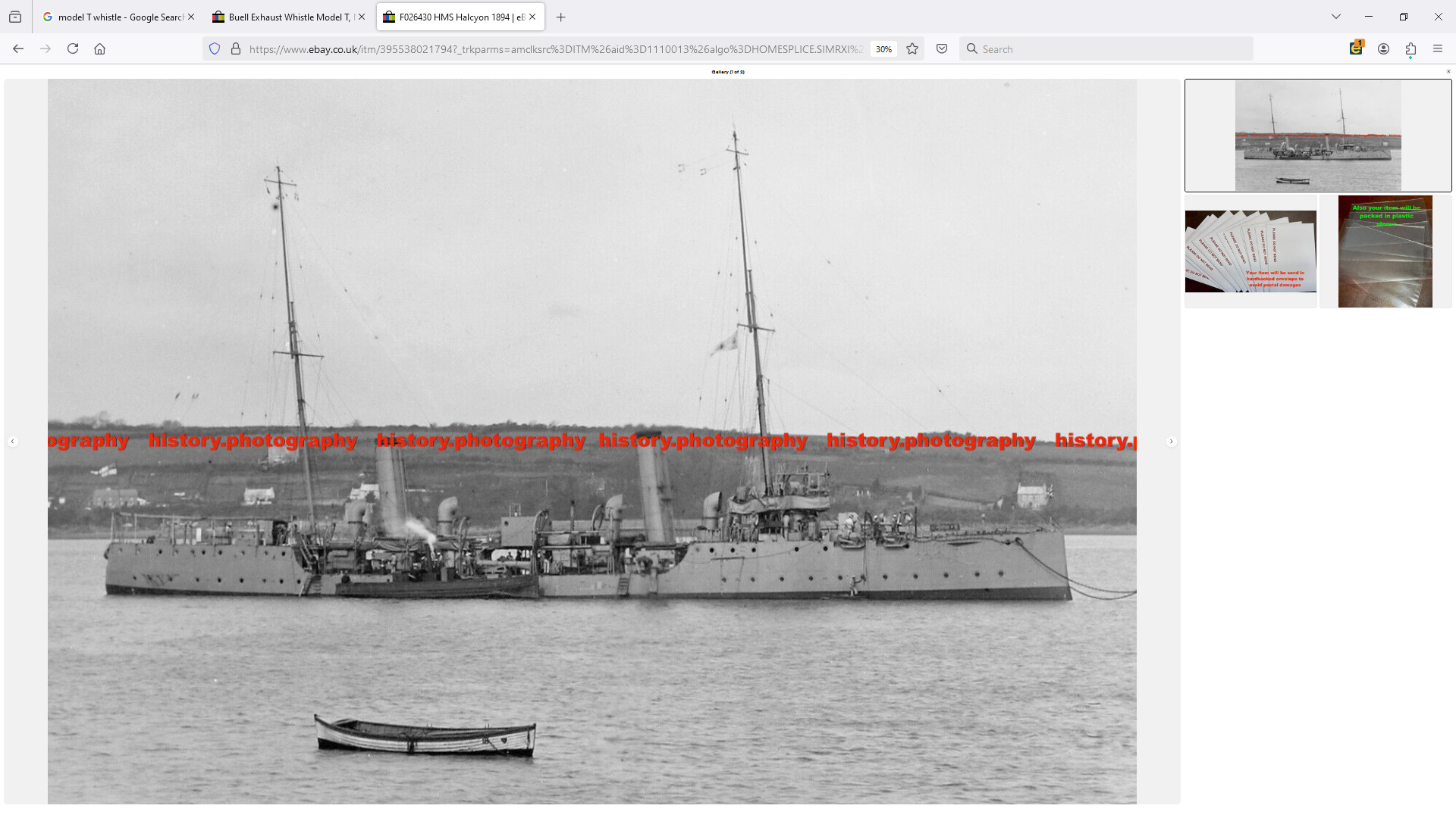

Here are 3 images ( all of HMS Halcyon - my wee ship! )
the ship as designed & built--
with thin funnels small gap fwd funnel to bridge
and after a ( yet to be confirmed) re-boilering
with fat funnels and big gap from funnel to Bridge

According to Perkins, Halycon was re-boilered in 1904 by Laird.
Then the distance between the funnels was reduced the funnels were thicker.

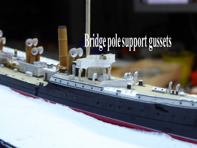

some new progress has been made
The cantilevered bridge could not stay up with willpower alone...
in the real ship-- it was supported fwd and at the sides
All ships of the class had detail differences in their bridge supports
some were cross-braced as is ' usual '

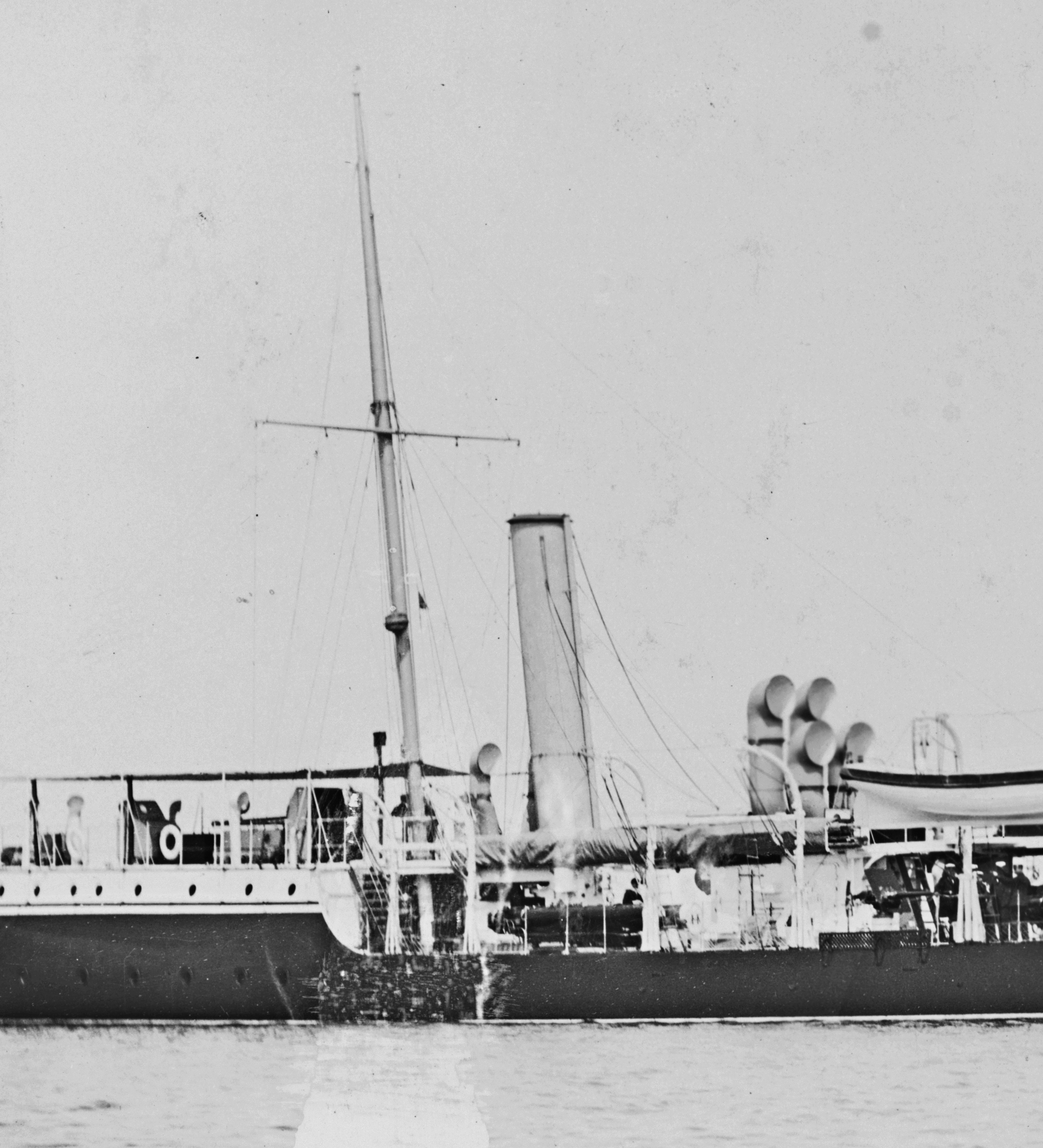

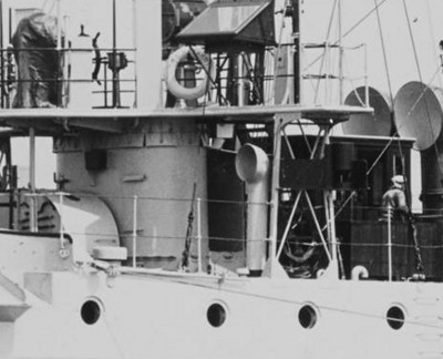

On Halcyon they were rather different
the uprights had triangular gussets top and bottom
these were orientated
lower; fore and aft
upper; athwart-ships
here they are on the model--the braces were cu of white paper
and installed with matt tacky varnish

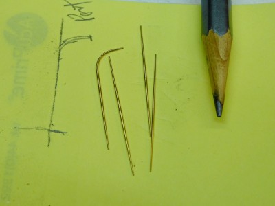

I was at the same time checking mast angles and clearances--I used a cocktail stick
( oversize to the masts but to ensure even gaps
The masts on the ship were parallel tube type with a sweeping taper at the top only rather then being conical
I made some masts out of stainless steel welding rod ...
but failed to get the positive curve taper....- numerous times!!
I searched for something I could use....
all knitting needles to large
and then .... found it --though this may appear sacrilegious.., !!!
but.... when on a mission...
I eyed up my spare Iwata airbrush needle hanging on the wall on its nice new packet...
and then-- after ordering an ( expensive) replacement... removed also the needle out of my airbrush !!
They needle diameter scaled up and measured beautifully...
Once I had nipped off the top of the pointy bit and made the cuts ...
there was no going back.... :whistle: :eyebrows:

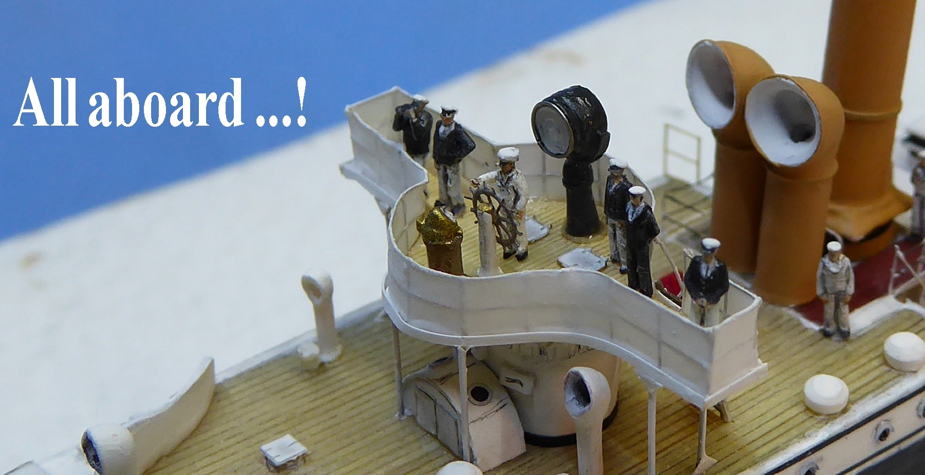

On any model-ship build -
some of the biggest time consumers are the ships boats...( still to come)
and the human aspect--the crew...
I actually actively dislike doing them both--
and nevertheless I go a little overboard on both :cool_2:
but with organic shapes in place its coming to life
based on these fellows

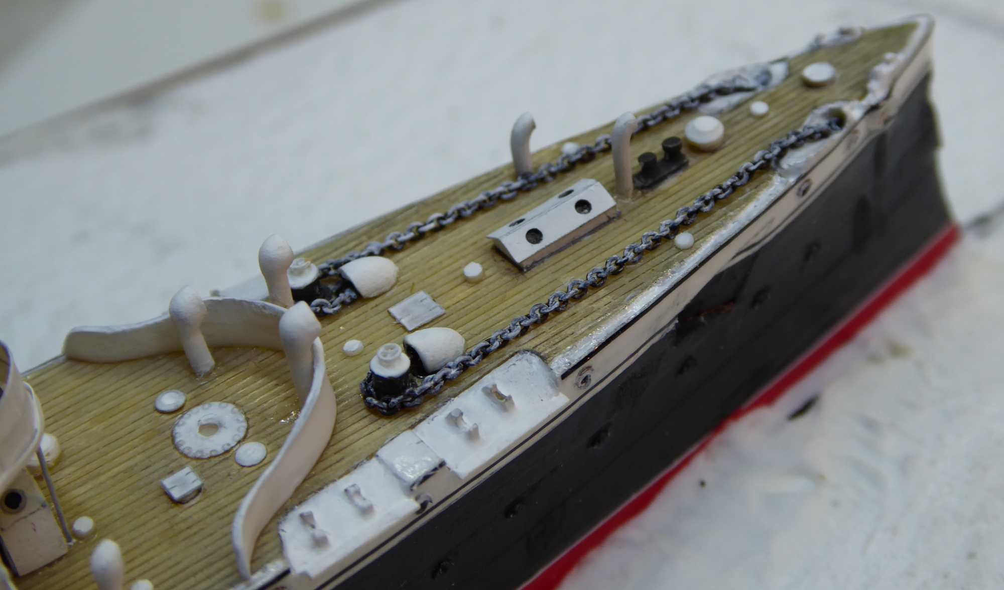

and added the chains on deck ( the spans to the anchor will be hung later in the build)

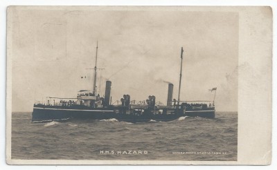

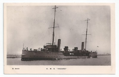

whilst not ever so sharp or clear--it does illustrate well the considerable height of the Aft ensign staff
-with my model ship being ship underway...
==> contrary to usual familiar RN practice ( flown from the gaff of mainmast ...)
My Ensign staff will be adorned with a White ensign!
later period
and again ---with a different member of the class
Can anyone shed any light on this flag practice--other than the obvious absence of a gaff spar...?

Looks like the main topmast has a semaphore attached . Maybe this interfered with normal flag practice.

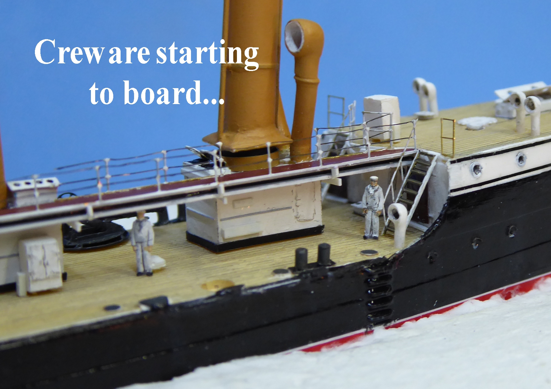

The boats that were supplied with the kit ..... had ( commendably ) a representation of ( crudely rendered) internal Ribs (overscale)
into / onto which almost none of the PE wanted to fit
This ship carried 5 boats --
Thankfully.... 3 of which -- even underway -were covered with canvas covers--Phew...!!
The Timber coamings were created using ) 0.2 mm black tapes.... sealed with CA and varnish, then snipped to size
I made the boat-covers by forming a ridge over the boat
in wire and infilled with a span of white glue

and many more sailors

The ship was fitted with awning stanchion to enable fore and aft decks to carry awnings along with the bridge.
a repeatable source of awning stanchions was gleaned from PE Oars ( old WEM )
these were pre-painted and cut to size
Before the stanchions were to be installed I needed to install 3 x anchors
the Kit had some quite well proportioned anchors-.....
-if a trifle too large for the anchor beds--
and anyhow almost inseparable without damage and breakage from the resin base
so I made my own-using redundant elderly PE semaphores as a repeatable starting point
whilst making fiddly stuff I made the prominently visible Navigation light boxes of brass strip
Awning stanchions were installed and rigged--the below image show the port side nav light ( red) below the bridge
Anchor have been installed to the beds and the external chain draped along by its securing points to the anchor
